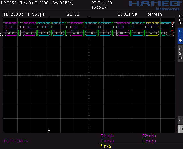

I do feel a bit stupid as I fail to write/read the registers of the ADS7924.
What I do:
1. check whether the ADS7924 is present by simply writing the address and checking whether it is acknowledged - which works.
2. resetting the ADS7924 by writing zero to register 16
3. set device in awake mode by writing 0x80 to register 0x00
4. check whether awake mode is set by reading register 0x00
Unfortunately I do get 0x00 instead of 0x80. And I cannot get any other register values including the analog readings.
What could be my problem?
Best regards
René
