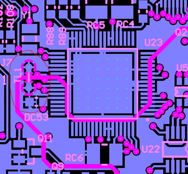

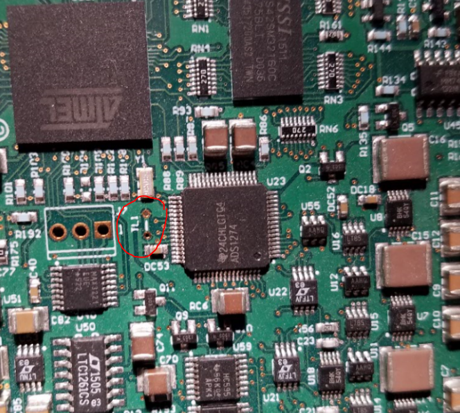

I have read Ryan's description of how a greater than 300 mv differential between the analog and digital grounds could be a source of the failures.  Our board layout nearly exactly copied the application note layout guidelines and has the tie point between the analog and digital grounds adjacent to the ADC.  That's TL1 in the photo below. We have not changed this part of the layout since 2011.

    Welcome to our e2e Forum! Can you describe the ADS1274 failure a little more? Does the issue happen with a single channel - i.e. one channel has bad data but the others are fine, or is is a gross failure of the whole device? Does removing and replacing a bad device bring the unit back to operational state (i.e. no additional components damaged, only the ADC)? Your picture did not come through with your post, so we don't see 'TL1' - if you can try posting that again, we'd appreciate it!
  • The ADC Channel failures are a positive rail lock up where the digital output is stuck at 0x007F FFFF.  This usually happens on Channel 1 but we have had two cases where this has happened on Channel 2.  In all cases the other 3 three channels work normally after the single channel failure.  We have replaced a number of these failed ADCs and every replacement restored full functionally to the device so it does not appear that any other components or the PCB itself were damaged, just the TI ADC.  We also have very carefully inspected and tested all the solder pin connections on failed units to determine if there were assembly defects that could be causing the failure.  All the failed boards have passed these tests without any indication of an assembly defect.

    I have attempted to attach the photo of the ADC on the PCB again as part of this response.

    2. After talking with Tom again he nudged us to reevaluate the way the analog and digital ground planes are tied together. He suggested we eliminate the track link (mentioned above) and use the PowerPad under the ADC as the only link between the analog and digital sides of the ground plane.  After a bit of back and forth with the layout people we pressed forward with a board spin that implemented this change. Tom made the time to review our design changes and provided guidance on how best to implement the changes. Due to some issues outside of our control it took many weeks to get a pilot run of 9 boards built that we could use for testing. These were delivered to us a couple of weeks ago and we tested them using the same EFT generator and signal pattern that we found would predictably kill our current production boards’ ADC.
    Here are some images that show how the PCB layout was changed:
    Looking up from the bottom, the top layer with overlay of GND Plane and drill pattern for vias.
    (GND plane is reverse image such that pinkish color represents areas with NO copper)
    Screen grabs are intended to show how the vias (yellow ‘+’) link the top, bottom, and ground planes together.
    The two parts of GND Layer for Analog and Digital ground regions are indeed only linked together by the PowerPad region on the top layer.
    This image is from the current production design.  A view from the top showing this same region around the ADC and I circled in red the TL1 ‘track link’ where the analog and digital sections of the ground planes are linked.  Based on conventional design practice this track link is located in very close proximity to the ADC.
    The great news is the changes resulted in a device that is immune to even the worst 5 KV EFT pulses we could generate with the test instrument. Several of the samples were subjected to over 45 minutes of various EFT patterns and amplitudes with no failures of the ADC. One of the boards had a failure in another unrelated area of the device but we attribute that to abuse we gave it using the EFT generator.
