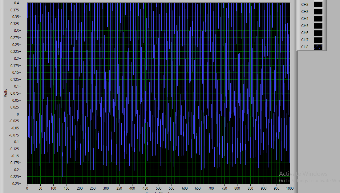

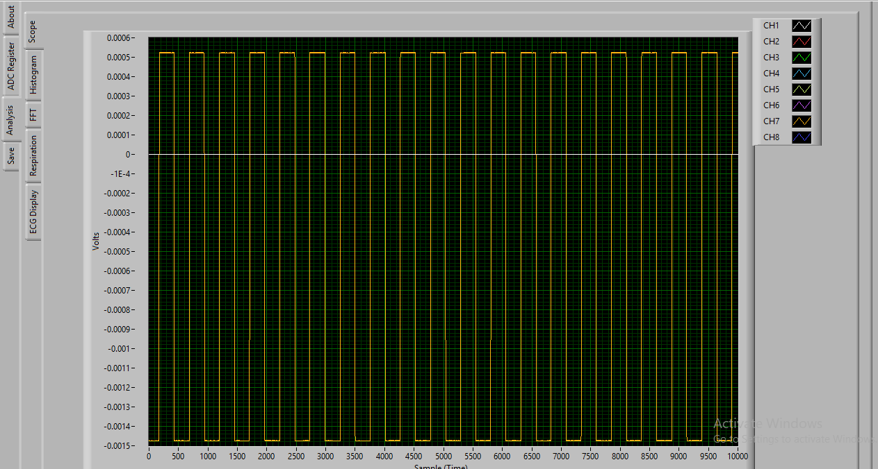

I am using ADS1298 evaluation board to get single channel ECG. I am using channel 7 and channel 8 for unipolar data collection.
I have saved channel 7 and channel 8 data imported in matlab and trying to plot differential signal. I am not getting anything that looks like ECG. Please correct me if i am wrong.
JP16 is open. (i am not using Wilson terminal)
One more question when we save data in text file it is saved as 16 byte data but datasheet only tell about 6 byte of data please confirm which one i should use.

    When you are collecting data from the ADS1298 using only CH7 and CH8, you need to parse the data from channels 1 through 6 as well as the STATUS detail. What sort of results do you get when using the software associated with the ADS1298ECGFE-PDK?

    Hello Tom,
    I am attaching text file that i have saved through ADS1298 GUI.  I haven't saved redundant data of channel 1 to 6. I am seeing their 16 bytes but in datasheet its 6 byte only.
    One more issue, i am getting with when i was experimenting, i have given dc 0.5V to channel 8 to check what output looks like but its not constant. I am attaching screen shot also
    I assume it should give constant line, instead of oscillation.
    Anurag Tamboli

  • Hi Tom,
    Test signal on channel 7 looks like above. Actually i haven't paid attention to differential input of evaluation board. So i have connected DC power supply to Channel 7 as test input Positive i have connected to CH7P and negative terminal i fed to TP11 (Test point 11 used as ground) of evaluation board and negative of power supply also connected to TP11. I got straight line as i was expecting it but when i gave 1V or 1.5V. It always clipped at 0.4V. I couldn't be able to find any explanation for it.
    If i am giving two channel input to evaluation board. Both input negative pin, can i feed with same ground pin (like TP11 of evaluation board)?
    Anurag Tamboli
  • Hi Anurag,
    OK - the test signal looks good. This is internally generated that gets muxed to the ADC input regardless of what you might have connected to the board. One thing to check, and this has tripped me up once or twice, is the 'Analysis Data is input referred' tic-box at the top of the screen beside the 'CONTINUOUS' control button (see Figure 6 and the details in Section 3.2 of the ADS1298ECGFE-PDK Users Guide). You can use TP11 for multiple channels, no problem there.
  • Hi Tom,
    Thanks for your suggestion. It helped me. One more mistake i was doing is not taking RLD into account.
