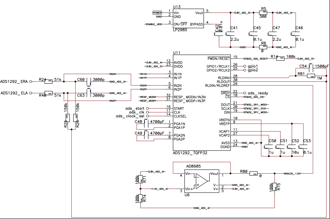

I am testing 2 wire ECG using ADS1292 channel 2, with scheme included in post
have a problem with 50 Hz interference when the body is not grounded

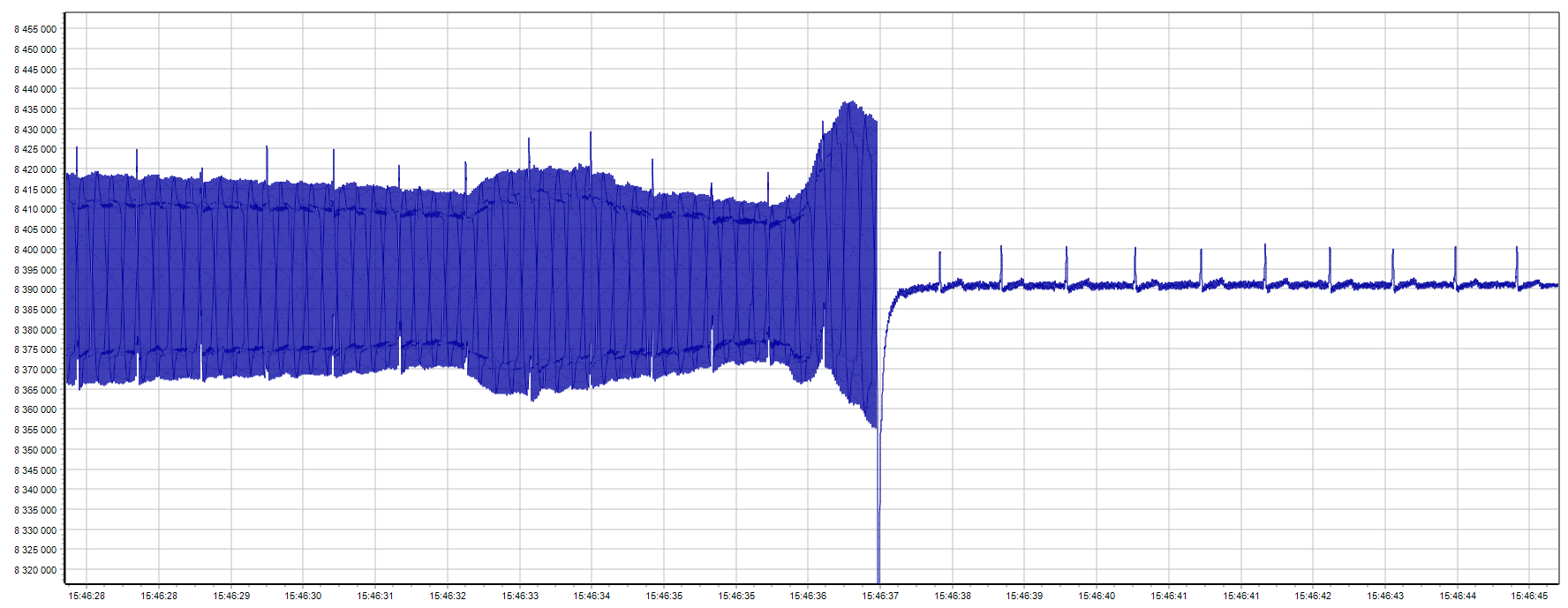

I attach a screenshot of ECG signal, got from ADS1292. First part - I
measure signal from body without "body grounded". Second part of
screenshot - I touch a power socket ground with finger.
If I use 3 wire scheme with RLD connected to body i have no problem
