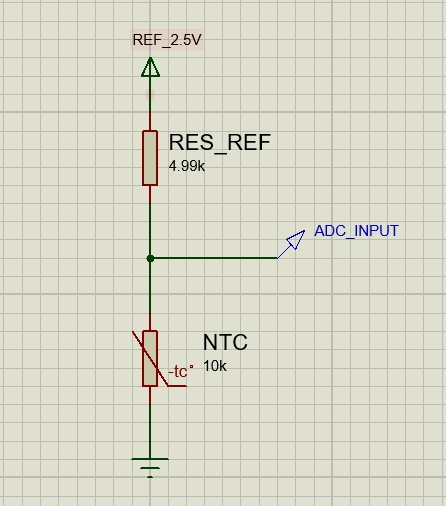

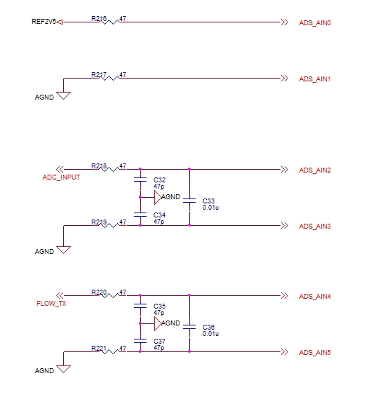

     2.input signal source
    3. this voltage is ratiometric to external reference source.

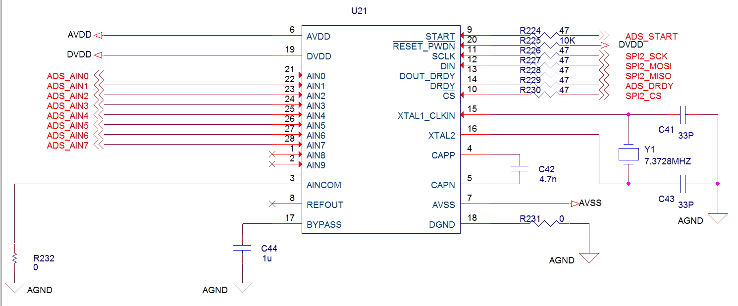

    4. schematic :  AVDD= 2.5V, AVSS= -2.5V, DVDD= 3.3V; REF2V5= 2.5V;
    5. Looking forward to your reply.
    From looking at the schematic I noticed that the capacitor on the REFOUT pin is missing... The ADS1262 datasheet suggests the use of a 1uF cap on this pin. Without a capacitor on REFOUT it is possible for the internal reference to oscillate and cause the gain error you are seeing.
    Since your input signal is not coming for a low-output impedance source, but from a resistor divider, I would also highly recommend using the PGA (enabling it) to avoid additional gain errors as a result of the lower input impedance of the delta-sigma modulator when the PGA is bypassed.
    I would try adding a capacitor to the REFOUT pin to check if this resolves your issues with the internal reference; however, you probably want to stick with the external reference when measuring the NTC thermistor as it will provide a more ratiometric measurement.
    Chris
  • Chris,
      Plus the capacitance problem solved.
      Thank you very much for your reply.
