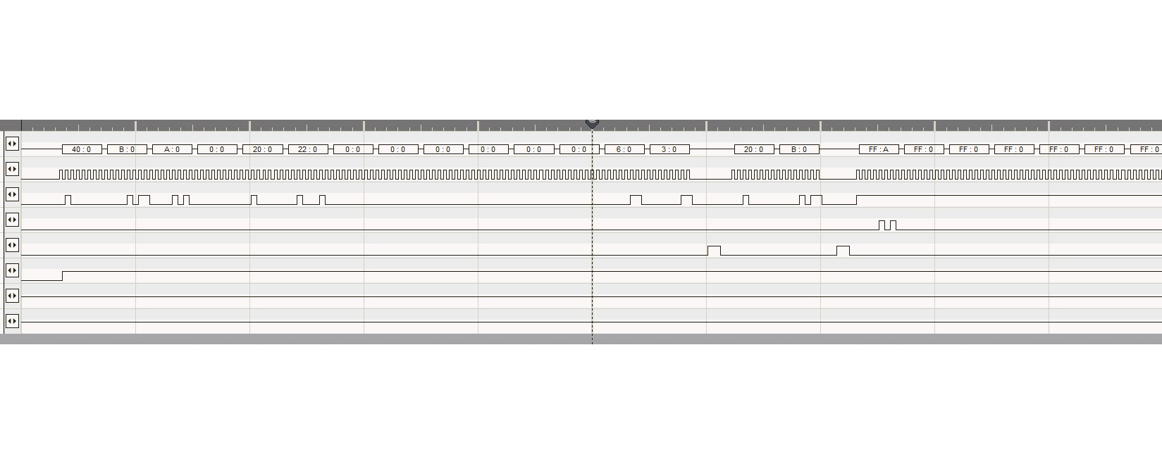

Hi
I'm using an ADS1247 with a PIC32MX530.
The ADS seems to program correctly i.e. I can see the conversion rate change and excitation currents being turned on etc; however I can not read back the registers or get a conversion result.
When I read the ADS the first byte is correct but all subsequent bytes are 0x00.
I have tested by changing the start reg to read back and alter the number of regs to read and always the same result.
Any ideas?
See logic analyser O/P - 12 regs programmed  only the first byte 0x0A read correctly.
