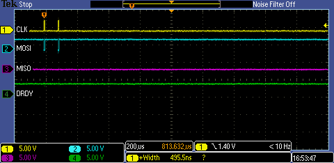

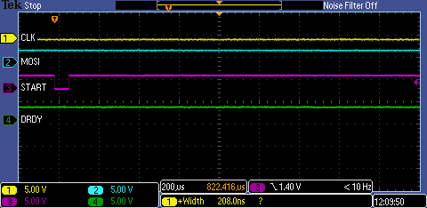

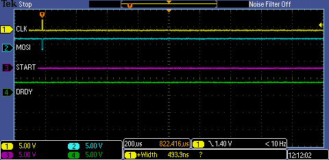

Here is a screenshot showing no DRDY following START toggle.  START is low for about 70us.  No DRDY for at least 1.5ms.
Here is a screenshot showing no DRDY following a START command for at least 1.5ms.

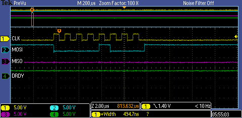

    I added a STOP command in front of every START command with ~80us of delay between them.  Still no DRDY assertions.
    Here it is zoomed in...you can just makeout the 0x0A (STOP) and 0x08 (START) on the MOSI output.

    Can you send us a schematic capture to show the connections to the ADS1292R?

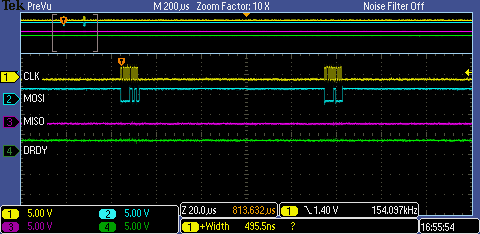

    Also, please send an SPI capture showing /CS, SCLK, MOSI, and /DRDY during one of the SPI command transactions so that we can verify that all timing requirements are met.
  • Hi Ryan,
    Here is the scope shot:
    Here is a zoomed in look at the START command on the SPI bus.  The CS# line is not shown -- it is simply tied to GND.  However I have also tried manually wiring the CS# to my micro and toggling it with each SPI transaction.  It doesn't seem to make any difference.  Also, for this test case I am holding the START signal low.  Note that my SPI clock rate is set to 1MHz in my micro.  And also that the SPI bus appears to be working for me during register reads/writes and during continuous mode.
