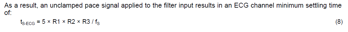

Please let me know the cut-off frequency of ECG sinc filter.
There describes about settling time of "t s-ecg" on the datasheet page 18 as below.
I would like to know the cut-off frequency in case of this settling time "t s-ecg".
Sorry for my basic question.
  • Hello Takumi-san,
    Thanks for your question.
    The bandwidth of the digital sinc filter is specified for both PACE and ECG channels in Tables 8 - 11. I believe this bandwidth corresponds to the -3 dB bandwidth. As you can see, the final output data rate depends on the selected filter decimation ratios (R1, R2, and R3) as well as the delta-sigma modulator sampling rate (either 102.4 kHz or 204.8 kHz).
    The settling time for the ECG channels appears to be 5 output samples based on Equation (8). The data rate period can be expressed as the modulator period (1 / fs) times the oversampling ratio (OSR = R1 x R2 x R3). So, tECG = [R1 x R2 x R3 / fs]. The settling time in response to a step input is calculated as: ts-ECG = 5 x tECG = 5 x [R1 x R2 x R3 / fs].
    I hope that's a bit more clear. Let me know if you still have any questions.
