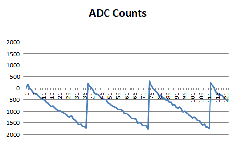

I am prototyping on perfboard with this ADC, and am experiencing a ~2Hz sawtooth noise in my data. (Plot below)

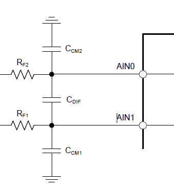

RC filter: Similar to recommended on page 44 of datasheet:
Rf1=Rf2=1k Cdif=0.1uF Ccm1=Ccm2=1nf

Sawtooth noise: 1900 counts, or 9uV pk-pk at AIN0/AIN1
Apparent differential input current = 9uV / 1k = 9nA.

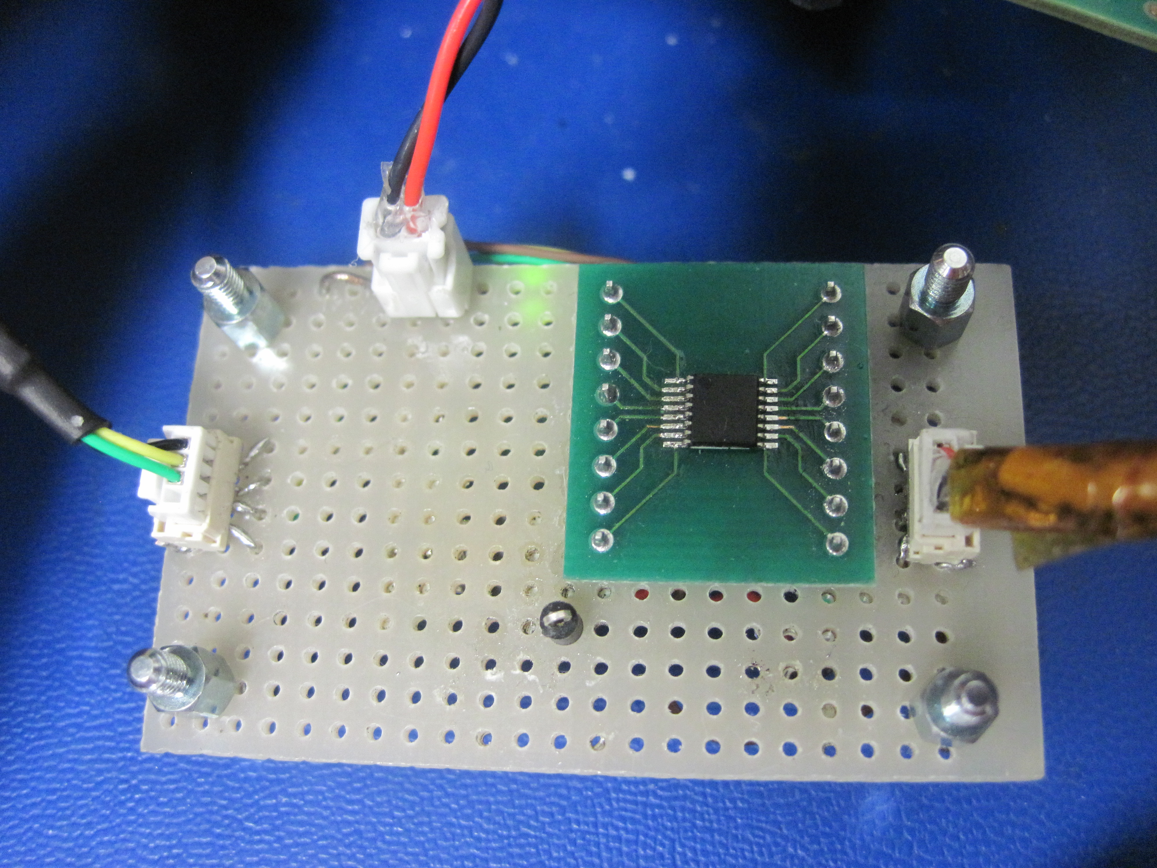

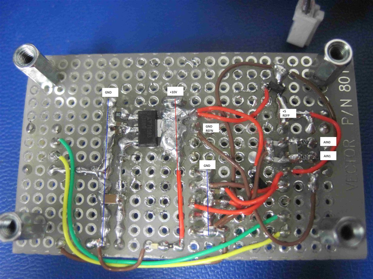

    Anyways here is the prototype. REFP/REFN connections are Kelvin connections. Inputs to ADC have minimum area; all analog wires are twisted, etc.

    It is very difficult to say what might be going on.  I did some asking around and the thought was similar to mine in that the input was probably floating.  But that doesn't really seem to answer the question as to why switching the PGA to disabled and back to enabled resolves this issue.
    I still have a question about the POR.  Normally this should not be an issue, but it is difficult to say given the prototyping board whether you have a clean and monotonic ramp without any ringing of the supply.  Having ground connections as opposed to a solid ground plane can have overshoots and undershoots that may require an additional RESET.  TI recommends issuing an additional RESET if power supply startup has the potential for issues.  So this would be my guess as to what might have happened.  The ADS122C04 properly reset the PGA when disabling and then re-enabling to fix the issue.
