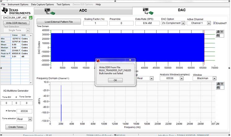

We had an issue with TSW14J56EVM when the pattern file is written to DDR memory in trigger mode. Based on communication with TI apps engineer, it seems to be HW defective.

  • Jason,
    What is the status of the LED's on the TSW14J56EVM in this mode? Does the board work when not setup for trigger mode?
    Jim
  • Hi Jim,
    The board works well not set up for trigger mode.
    Jason
  • Jason,
    When attempting trigger mode, if you a DAC EVM plugged in and providing a clock to the TSW14J56EVM, and you had a SMA-to-SMA cable connected between the TRIG IN SMA J13 and one of the Trig OUT SMA's (J7, J8, or J12), and under the trigger option tab have both "Trigger Mode Enable" and "Software Trigger Enable" selected, and the GUI gave you the error you reported, then the board is probably defective and needs to be returned for a replacement board.

  • Thank you, Jim
    Yes, we have the setup you explained and have an issue. Here is the email from mouser regarding on the return policy.
