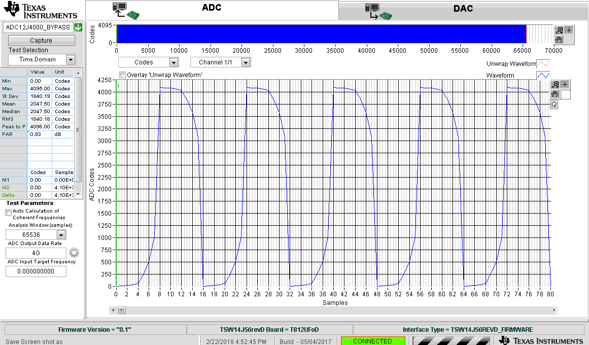

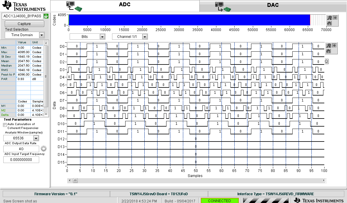

We are evaluating the ADC12J4000 ADC using both the ADC12J4000EVM and the TSW14J56EVM.
Test Pattern mode is selected in the ADC12J4000EVM, and ADC12J4000_Bypass is selected on the TSW14J56EVM.
The content of JESD204B lanes and other information are captured (ALTERA SignalTap), and then compared with expected Test Pattern values (Table 33 in the datasheet).
Captured data does not seem to be aligned, as the location of the trailing 4-bit zeros (red colored) is not fixed. Example follows.

Please advise regarding the issue described above.
