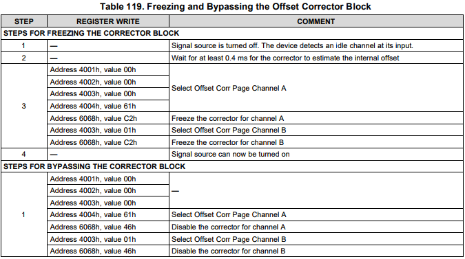

I am trying to disable the DC corrector block for the ADC32RF42 but I am having no luck. I am able to freeze the offset correction successfully using the steps in Table 119. Freezing and Bypassing the Offset Corrector Block but those steps don't work for bypassing.
I am seeing that when I am in bypass mode, all DC inputs are DC offset back to 8192. This implies that the DC corrector block isn't bypassed.
Any help would be appreciated.
