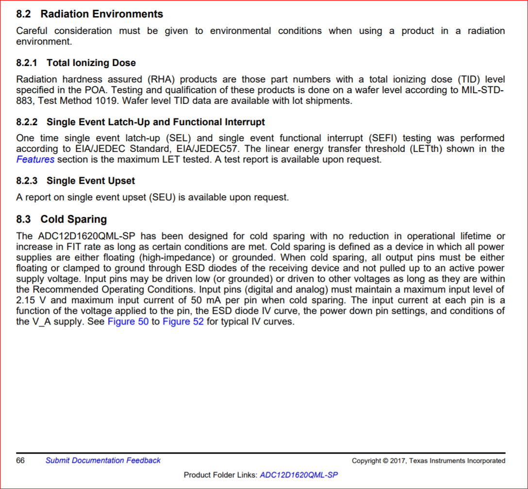

  • Hi Gabriel,
    We do offer a line of space/radiation hardened and QML data converters. Please see  and
    for more information in regard to these products.

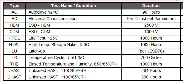

    It seems as though you may be interested to know if any of the tests you have mentioned were performed on some of our catalog parts (like the ADS52P15)? Please see what the datasheet includes for one of our QML-SP parts.
    The first few points under features are space related qualifications,
    and further insight into testing of specific standars are available.
    Additionally, our catalog parts do go through some testing, like you mentioned, and this data can be made available upon request.

  • First of all thank you for your response.
    I'm aware that TI provides space qualified components, however what TEKEVER needs at the moment is to qualify the ones we already have, including the ADS62P15.
    The information I'm looking for is exactly the one on the last table of your post, applied to this specific component of course.
    If you could make that information available it would be most valuable.
