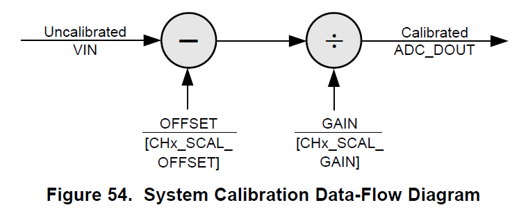

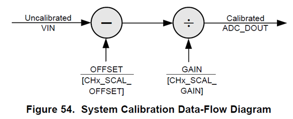

    Based on Figure 54, the value stored in CHx_SCAL_OFFSET should be subtracted from the VIN coming from the ADC. However, it seems you're either getting the wrong value or the offset subtraction isn't working at all (the change between 1000h and F98h is 68h - about 100 codes).
    Instead of entering in the value directly, have you used the system calibration offset coefficient determination mode outlined in 9.3.7.2.1? This should get the correct value as well. I would run through that set of instructions and then read back the result of CHx_SCAL_OFFSET just to see if it matches what you would have gotten.

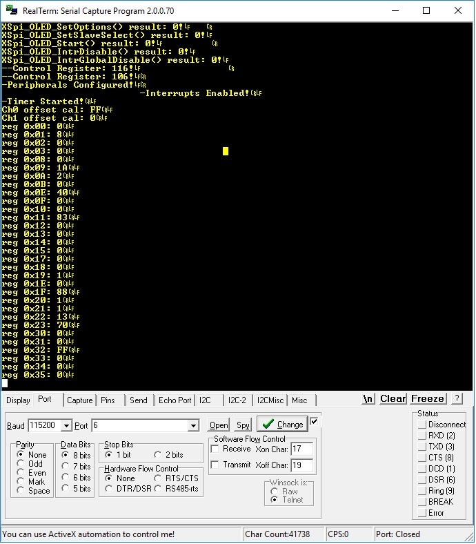

    Thank you for the response!  I am using a gain of 1 (not changing from default) and I've tried writing the offset both as the first configuration message and the last configuration message.  Said differently, I've tried configuring the offset first before any other register and last after all other registers have been configured.  I have verified I can read the offset value I program into the channel 0 offset register, so if I write a FF I read an FF and if I write a 0x77 I can read a 0x77.  This seems to have no affect on the actual offset though.
    To take a step back, should I be able to read every single register in the register space and see what I've written?  If I configure all the register should I be able to read all those values back and see the exact same values I programmed in?
    Here is what I'm programming into the registers for 2 channel (ch0, ch1) repeated sample mode.
    LMP90100 configuration register writes
    0x01: 0x08
    0x02: 0x00
    0x03: 0x00
    0x09: 0x1A
    0x0A: 0x02
    0x0E: 0x40
    0x10: 0x00
    0x11: 0x83
    0x12: 0x00
    0x13: 0x00
    0x17: 0x00
    0x1F: 0x88
    0x20: 0x01
    0x21: 0x01
    0x22: 0x13
    0x23: 0x01
    0x30: 0x00
    0x31: 0x00
    0x32: 0xFF
    0x33: 0x00
    0x34: 0x00
    0x35: 0x00

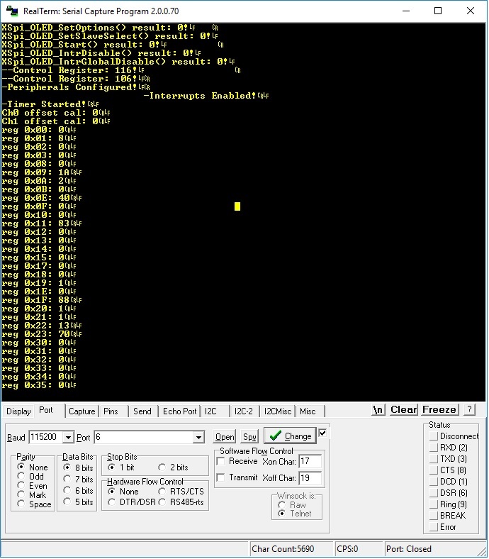

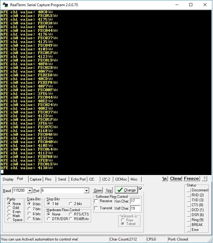

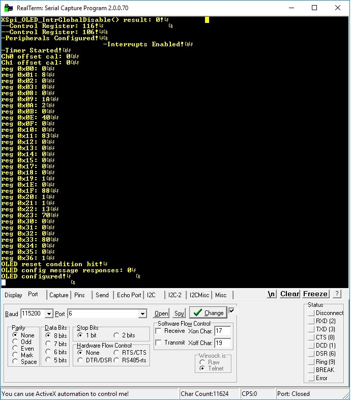

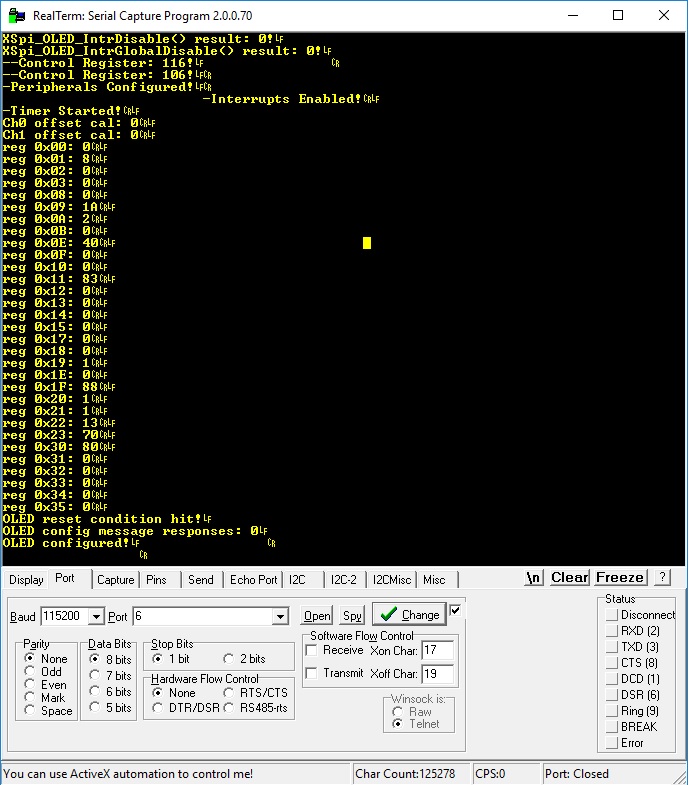

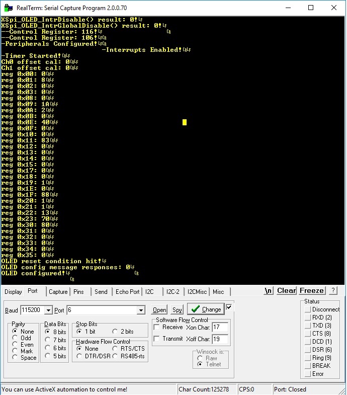

    Here is what I'm reading out of those registers:

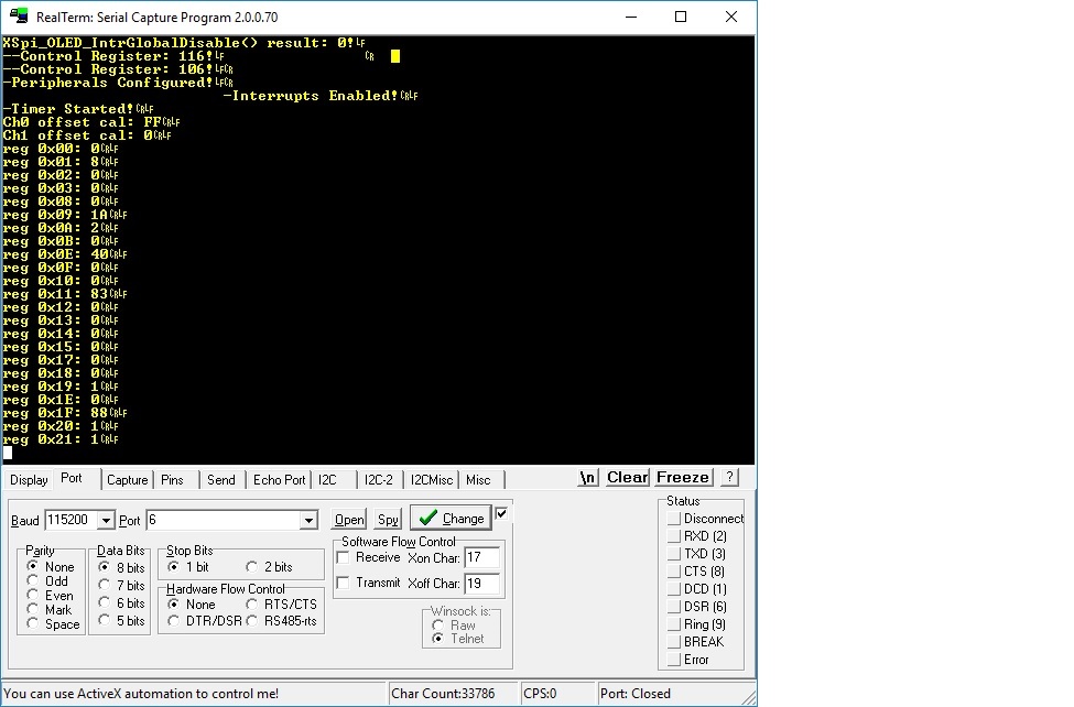

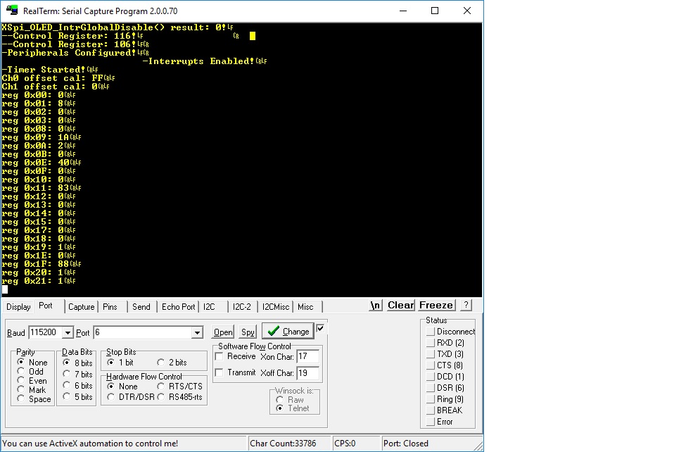

  • Here is a more complete register read:
    Here is what my data looks like with the 0xFF offset loaded as shown in the register read above:
    Here is my register reads with no offset:
    Here is the data from the no offset configuration above:
    All registers are configured in the order shown in the text list of registers and the values I'm writing to them.  I'm assuming the order in which you write to the registers doesn't matter?
  • Robbie,
    The order of the register write shouldn't make a difference.
    Right now you have the CH0_SCAL_GAIN set to 000000h. The default is 800000h. Can you keep that value set to 800000h and check the result?

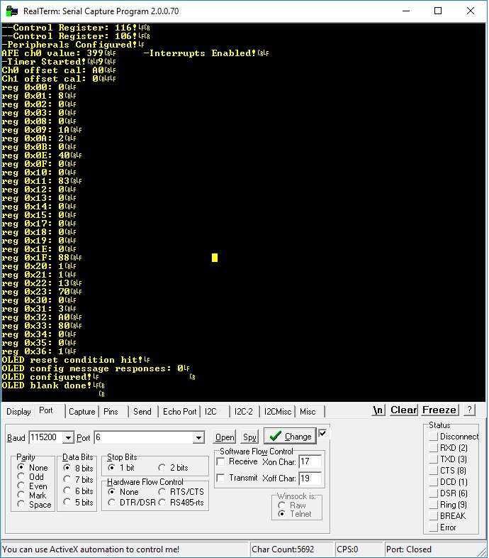

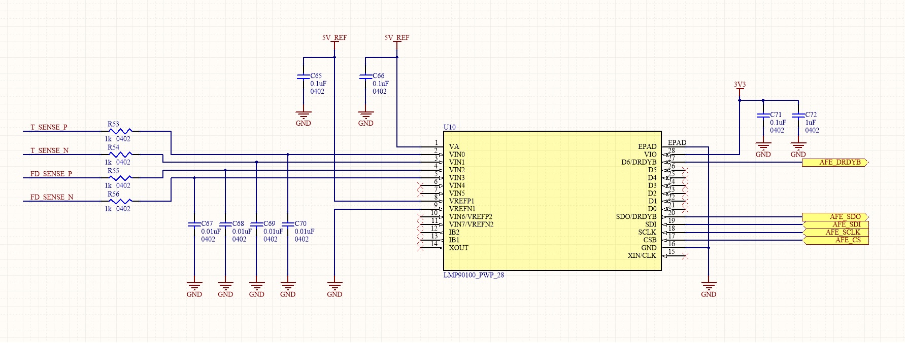

  • Also, here is the hardware configuration

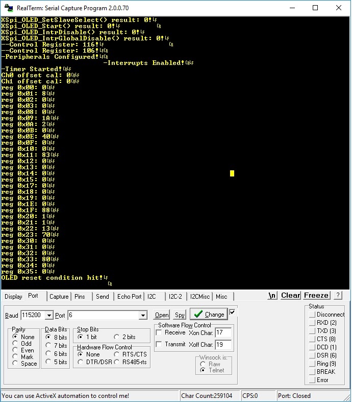

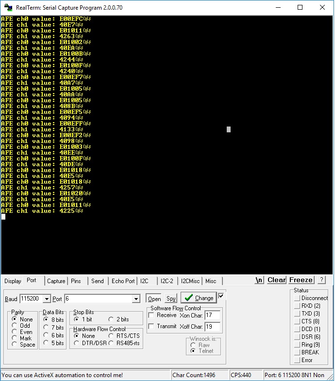

  • Here are the register reads when the ch0 offset is set to 0x800000 and the read results.
    Config registers reads:
    Here are the sample results with the 0x800000 offset configured:
  • Robbie,
    I think you misunderstood. I wanted the CH0_SCAL_GAIN set to 800000h. This would be for registers 33-35. You've set the CH0_SCAL_OFFSET value to 800000h, which you should keep to near 000000h first. The offset registers are 30-32.
    Joseph Wu

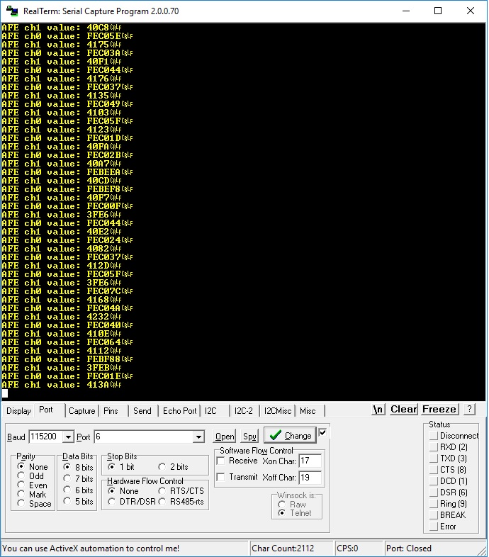

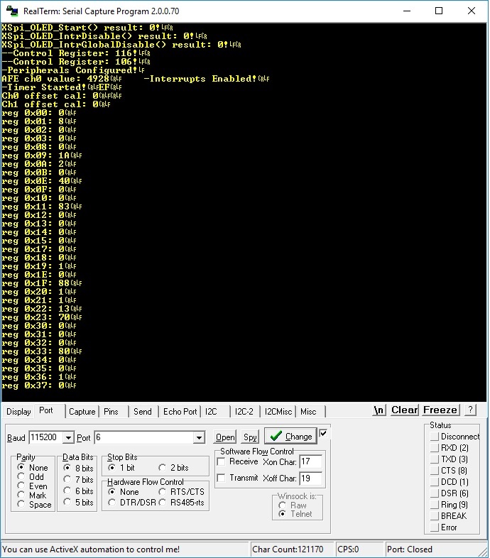

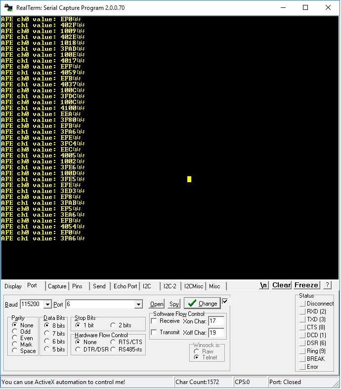

  • Oh I apologize I did misunderstand.  I think this is what you were looking for.
    Here are the register values:
    Here are the sample values:
    Why is the default value for CH0_SCAL_GAIN 0x800000?
  • Joseph,

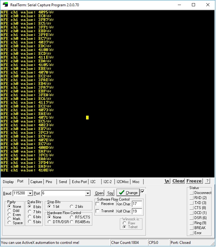

    I think that was my mistake.  I believe what I'm getting now makes sense and the offset subtraction may be working.
    Below is my register values with no offset and sample values with no offset (I am only displaying ch0 now to make it simpler)
    Here is what I get when I set the offset value in the CH0_SCAL_OFFSET to 0x3A0.  It looks like it is subtracting.
    As a general question, does this make sense and for some basic linear lab supplies does this offset make sense?  It is not a large distance from 0V I don't think?
    1. As for acquiring data do people generally just average a lot of these values together?
    2. There is a lot of noise.  Should I right shift to get rid of some of the lower bits?
    3. Do you right shift until you are using the same ENOB that is described in the data sheet for my configuration?

    Thanks for making that change. I still can't tell if the offset is correct. The offset is a negative number, but it's larger than I would have expected. The output data is in two's complement notation. If I take the first output data of FEC05Eh, the result is basically negative 13FA2h, or -81826d.
    The reason I had CH0_SCAL_GAIN set to 800000 is because this value scales the gain. If you go back to the calibration diagram on page 27 in the datasheet you can see it's role in the output data.
    Normally, If you put in a full scale input (uncalibrated VIN), you would first subtract offset and then scale the output so that the full scale input yields an output data of 7FFFFF. To do this, the value for gain would also be near 800000h. Soe that 800000h/800000h is near 1. By changing this value to 000000h, it's like dividing by 0, and I'm not sure what the output data should look like. By starting with 800000h, you're starting nominally at a gain of 1 to get the output data.

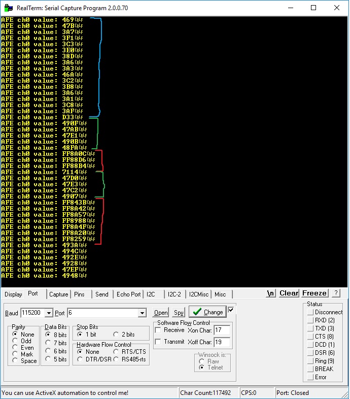

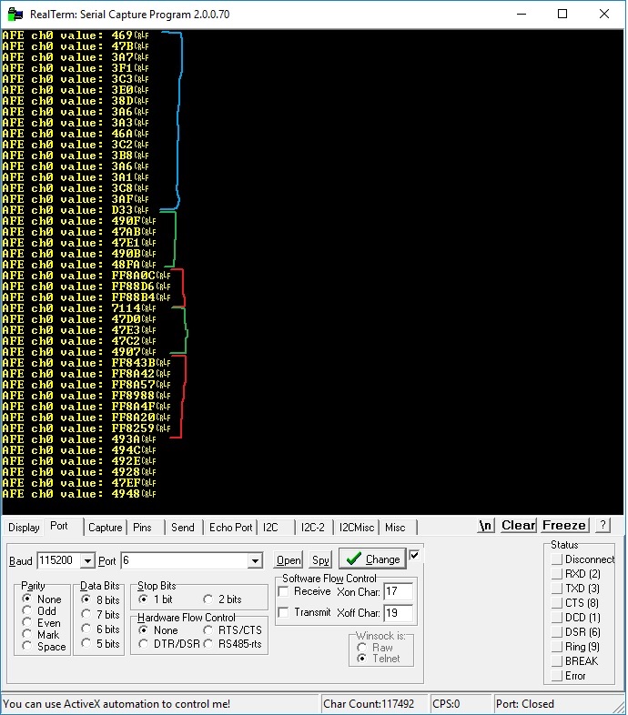

  • Ok that makes sense.  I forgot to mention my setup.  I think the noise ENOB aspect makes sense now.
    My current setup is a dual output power supply driving both inputs (Vin+ and Vin- of ch0) to 2.00V with the ADC_REF at 5V.  I am trying to walk the differential voltage up in value by taking to positive input from 2.00V to 2.10V in 10mV (0.01V) increments while leaving the negative input VIN- at 2.00V.  When I step up in 10mV increments I see the output of the ADC flip from being positive to negative as shown in the image below.
    The blue is steady state with both outputs roughly at 2.000V.  The green is when I increase the vin+ by 10mV.  The red is when I increase the vin+ by another 10mV.
    I initially thought I had a noise problem, but I have some very good power supplies and am verifying their voltage outputs with a fluke meter calibrated to 1mV.  In this particular example I'm using no calibration values for the offset.
    For completeness these are the register values:
    How could the output change that much when the input is verified to be stable and separated in a postive manner i.e. the vin+ is ~20-30mV higher than vin-.
  • Robbie,
    Without knowing more about your setup, it's hard to say what is going wrong. What are you using to generate both inputs? If this is a variable lab supply, what model are you using? Are you measuring back both inputs individually? or are you measuring the differential voltage? Do you measure the voltages right at the ADC input pins? It would be worth taking some larger steps to see if there's anything else wrong.
    I took your data and converted it to voltages and the differences are roughly 10mV steps. However, they're not monotonic and not continuous:

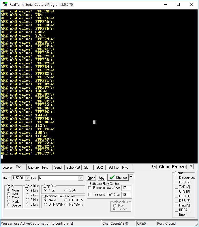

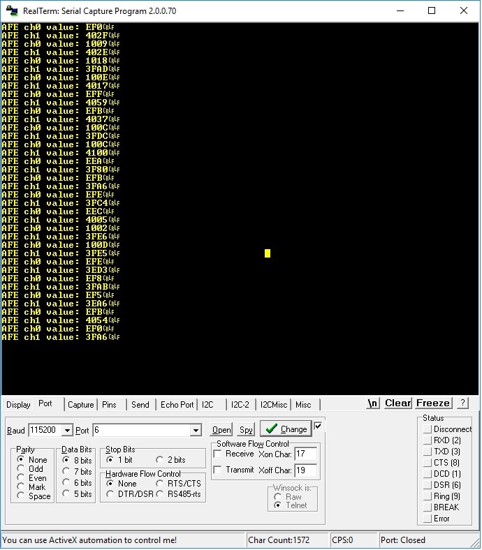

  • Joseph,
    I have this up and running now the offset zeroing functionality seems to be working pretty well. Now that this is working it sort of brings up a problem I didn't think about.
    Since the number is signed and when my offset is zero'd out I still have some noise that causes the number to bounce between a small positive number and small negative number. Said differently, when my strain gauge offset is zeroed out, I see the numbers at steady state fluctuate like below:
    AFE ch1 value: FFFFCE
    AFE ch1 value: 3F
    AFE ch1 value: FFFFFD
    AFE ch1 value: FFFFCC
    AFE ch1 value: FFFFB7
    AFE ch1 value: FFFFD3
    AFE ch1 value: FFFF88
    AFE ch1 value: FFFFDF
    AFE ch1 value: FFFF71
    AFE ch1 value: B
    AFE ch1 value: FFFFD0
    AFE ch1 value: 3A
    AFE ch1 value: FFFFB3
    AFE ch1 value: FFFFFB
    AFE ch1 value: FFFF76
    AFE ch1 value: FFFFF6
    AFE ch1 value: FFFFE1
    AFE ch1 value: 35
    AFE ch1 value: FFFFEF
    AFE ch1 value: FFFFF2
    AFE ch1 value: 3C
    AFE ch1 value: FFFFBD
    AFE ch1 value: 1C
    AFE ch1 value: 2E
    AFE ch1 value: FFFFE5
    AFE ch1 value: 1
    AFE ch1 value: 2B
    Just as an example. So i'm bouncing between positive and negative. Now, when I apply a gain (say of 128) this blows up on my because I get that gain applied to the negative number (which makes a much bigger negative number) and a positive number (which makes a much bigger positive number).
    How should this situation be handled? I am new to this sort of data acquisition and don't see an option with this device to deal with this. Even if my analog side was very quiet and there was very little noise, as long as the values/codes go between positive and negative it seems this issue would exist and getting exactly 0 for an offset isn't really possible.
    Do you have any guidance/recommendations?
    Thanks!
    Rob
  • Rob,
    I not sure how to answer this question. Regardless of the measurement, you'll have some amount of noise. Applying gain, you'll always gain up the noise. The trick really is to reduce the noise to as low as possible while maximizing the input signal range. This is a combination of using the data converter at a lower data rate, averaging, a clean layout, and low noise reference.
    As far as putting the device in gain and having the output code go positive and negative, you could do is truncate the output code so that the noise is smaller than the least significant bit that is visible. With a 0 input, you'd never see the negative codes.
    Joseph Wu
