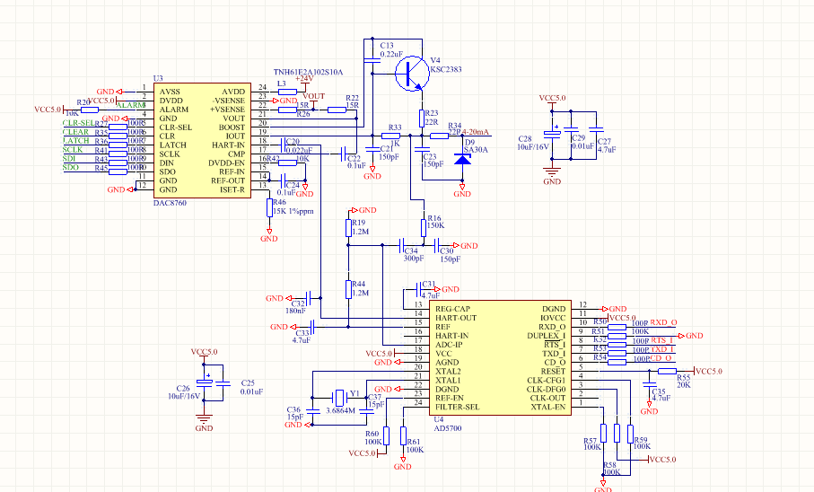

  • Hi Kevin
         The DAC8760 hardware is Customer's PCB and the schematic is following:

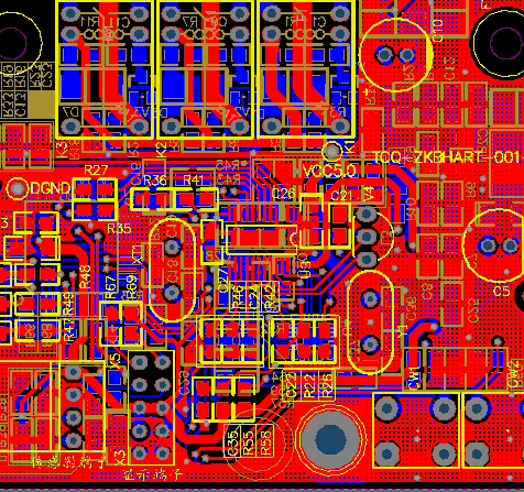

    The PCB Layout is following:
    The working frequency of walkie talkie is 100~500MHz,we keep a distance of 1 centimeter between walkie talkie and DAC8760 PCB,and use the multimeter measure the average output current of DAC8760,so the test value is 2~3mA higher than when the walkie talkie far away from the PCB.

  • Hi Yulei,
    I would suggest a couple more measurements are made so that we can better understand the situation. So far, we just know that there appears to be a 2-3mA offset observed on the IOUT terminal block.
    1. Using an oscilloscope, is IOUT stable without interference from the walkie talkie?
    2. Can we see an oscilloscope measurement of IOUT while exposed to the walkie talkie?
    3. Does the size of the offset caused by the walkie talkie change depending on the DAC code?
    4. Is any change in voltage observed at the node between ISET-R and R46?
    5. With IOUT disabled, is there an offset caused at the IOUT terminal by the walkie talkie?
    6. Is any change observed in the REF-OUT or REF-IN voltage during exposure to the walkie talkie interference?
    7. Is the voltage output impacted by the walkie talkie interference?
    8. Is AVDD impacted by the walkie talkie interference?
    9. Is the voltage at the HART-IN pin impacted by the walkie talkie interference?
