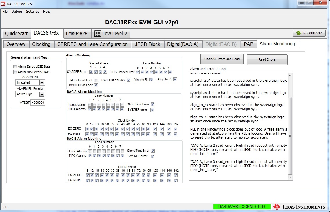

I got some problems with my demo: using FPGA KCU105 to send waveform to DAC38RF82EVM. Everything was fine when I used constant input to make sine wave.

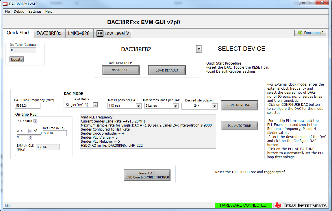

I use internal clock source 122.88MHz and LMK04828 to generate clock for DAC and FPGA.
Some demo params:
- DAC clock freq: 6144
- On-chip PLL with ref Freq 384MHz;
- Single DAC, 1 IQ pair, 2 lanes, 24x interp,
And I got below problems. Thanks so much for any help!
