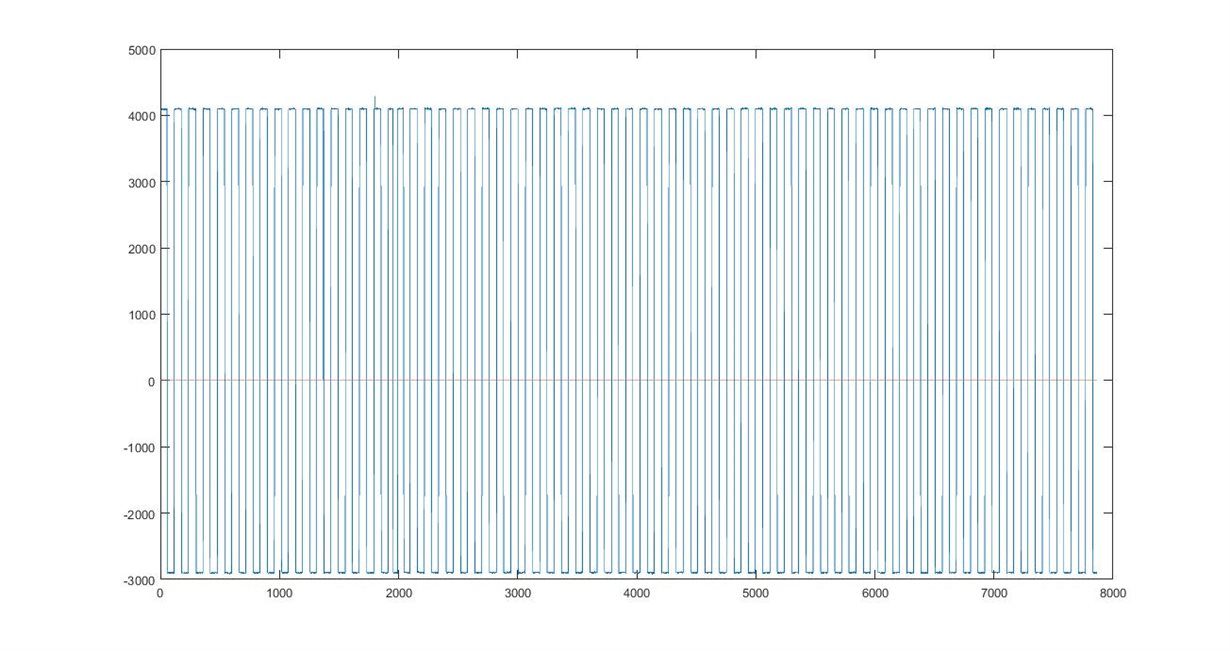

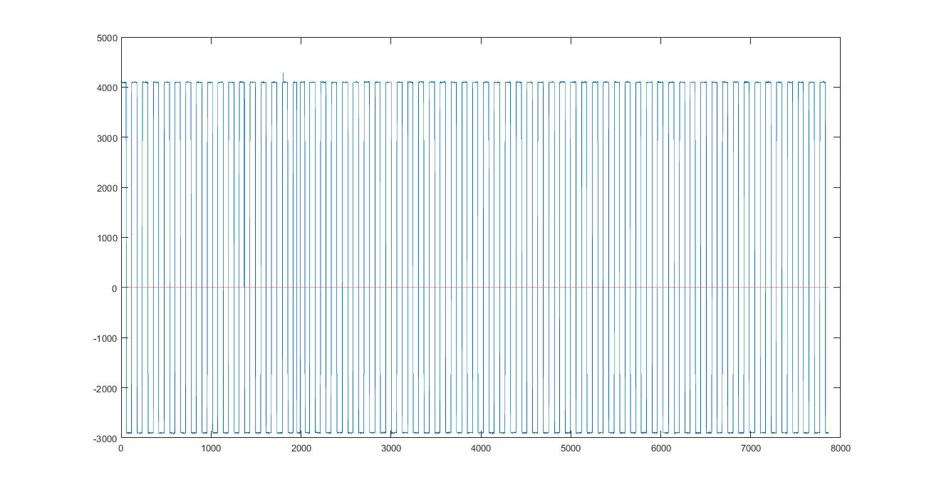

    Thanks, really appreciate your advices. I didn't realize that since both /NDRDY signals are synchronized, I can read both device's channels at once and don't have to wait for the other device /NDRDY interrupt. This seems to give better results, even though it still skips some /NDRDY edges probably due to my program, handling some other task ...
    But I'd still like to ask you two questions if you don't mind. There's some error value appearing time to time in the output stream, probably caused by some fault in data read loops and writing on memory card. But if I filter them out, the signal still sometimes looks inaccurate. Would you please be so nice and tell me if it's how is supposed to look or if there is still some problem I'm not perceiving? And what units could on the Y axis? (I'm using internal 2,42V reference, test signal and PGA gain = 1).  Sorry for these probably silly questions, I'm absolute beginner in stuff like this and so even simple things are sometimes hard to understand..

  • Hello Ondrej,
    The second image looks like the correct test signal waveform and amplitude. The y-axis output is in decimal codes, where one code represents the LSB size = 291.1 nV/code (1 LSB = [2*VREF / Gain / 2^24]).  7,000 codes peak-to-peak is approximately equal to 2 mVpp, which is the correct default amplitude for the internal test signal.
    The first image looks like you are missing the next /DRDY interrupt while you are still reading old data. The data in the output shift register is immediately overwritten with new data after each /DRDY falling edge. The large negative "spikes" in the output should correspond to the moments where a portion of the old data was overwritten with new data.

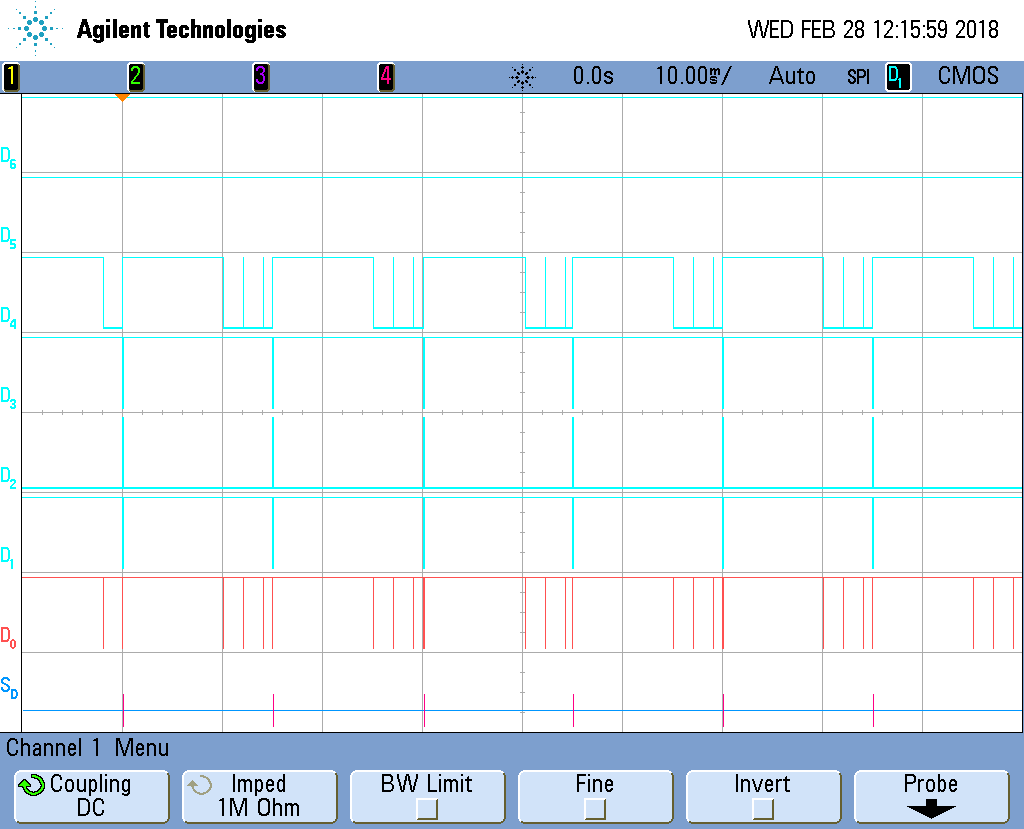

    thank you very much for your advice and explanations. I set it up according to your instructions and it was working just fine, but two days ago it suddenly started to work somehow unpredictably. When I use sampling frequency 125sps, the device usually starts giving the /NDRDY signal correspondingly first. But after few dozens of seconds (this period really varies, sometimes it's 10s, sometimes doesn't happen at all), without me changing anything, the sampling frequency either doubles, the /NDRDY interrupt signal is generated in 3edges burst (D4 line on the image) or just stays high all the time. When using any of the higher sampling frequencies, /NDRDY stays high after just cca 10s. These situations are happening randomly, no matter if I use electrode input or test signal, sometimes it happens right after power up and start and I need to turn it off and on again about 5 times to make it work again. And when any of that happens, the output values start to be either completely incorrect or just zero.
    I've two devices on my PCB and both started to have these issues at the same time.  I probably mess something in the measuring process, but it doesn't make any sense to me, because I didn't change either the code or connection from the previous setup, where it worked without these issues. May I ask you if you have ever encountered any of these issues and have any tip how to put the devices back to normal work?

  • Hi Ondra,
    Are you communicating with the ADS1292R at all during this oscilloscope capture? Meaning, are you toggling the SCLK?
    The only things that can interrupt the /DRDY behavior are:
    • Setting the START pin low or sending the STOP command
    • Setting the /RESET pin low or sending the RESET command
    • Sending the STANDBY command
    • Disabling the external CLK input
    Can you probe the START, /RESET, SCLK, and /DRDY pins together without sending SCLK (i.e. hold SCLK low)? I want to verify that START and /RESET are always high and do not interrupt the /DRDY period.
