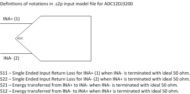

Hi Team,

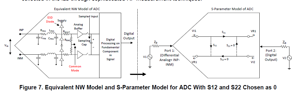

Could you please help to explain what's the S11/S21 stand for in the S-parameter of  ADC12DJ3200?   If it is same as below picture?   My customer want to know the transfer function or flatness of the ADC...
Why S22/S12 is not 0 and same as S11/S21?
In this model, S11 carries information about the ADC’s input impedance (ZIN), whereas S21 carries
information about the ADC’s transfer function when the system (source) impedance is Z0.
