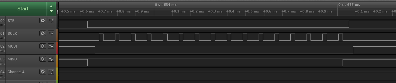

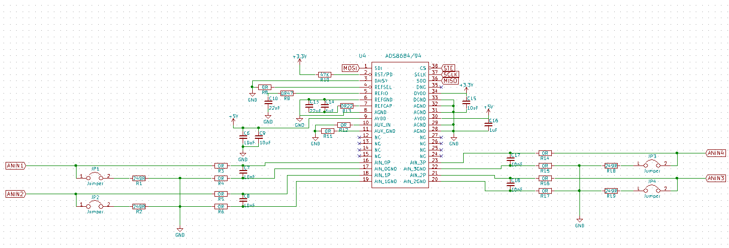

I couldnt make my ADS8684 work on my custom circuit.
Here is the logic analyzer output:
uart output:
ADS8684 circuit:
MSP430F5132 codes:

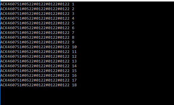

UART always prints the same output. Could you please help on that?
Onur

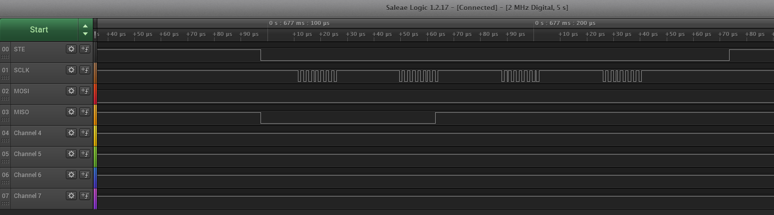

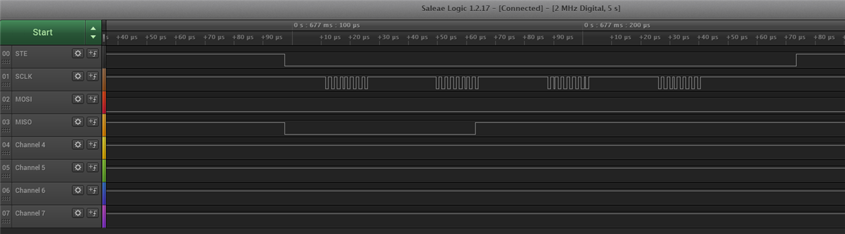

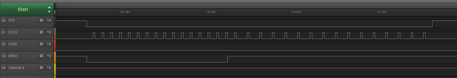

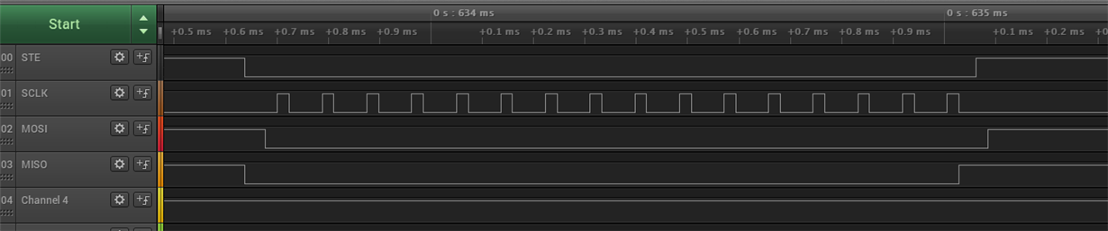

    Your schematic looks good from what I can see.
    Please also look at page 34 of the datasheet for a data acquisition example.
    The timing diagram on page 11 will also prove to be helpful, the most common issue is timing requirements not being met.
    It is good practice to keep the clock as a steady sequence of pulses and not break them up within a CS pulse.
    I would suggest the following to debug your software issues
    -After programing the registers, read them to make sure that they are being programmed correctly; page 46 of the datasheet will help to do this
    -Use a known DC input and convert, this will narrow down the issue.
    Cynthia
  • Thank you very much for the response. I will work on some bit bang spi function tomorrow and I will give information to you.
  • I wrote my own functions to make my custom SPI communication.

    But MISO line is ALWAYS LOW?!
    SPI command 16bits:
    SPI transfer for reading measurements:
    Any ideas whe MISO is always low?
    Thank you,
    Onur
    I fixed up my SPI bit bang functions and now mcu communicates with ADS8684.
    But when applying a 5V to channels, there is no life, no higher value. It always returns like 4, 20, 16, 25 from channels.
    I solved my issue. But now, I have a new issue about registers I think. If you have any ideas, please answer the post.
    Thank you,
    Onur
  • I am glad you were able to fix your initial issue. I would agree that this is probably a register issue, perhaps you have the channels programmed to different input ranges. Do you see the same issue with a different input value, at lower or higher than 5V? Page 47 of datasheet can help with the input range selection.
    Try writing to the registers, after read the registers you just programmed to make sure that they were done correctly.
    After making sure you are programming the registers correctly, and continue to have issues, one way to debug this would be to look at one channel at a time. You can do a manual channel selection, this will help you understand the timing requirements and where the conversion is going wrong. If each channel individually works correctly, then you can apply the scan or auto features, if you now see the wrong values then the problem area is further narrowed down.
    Cynthia
