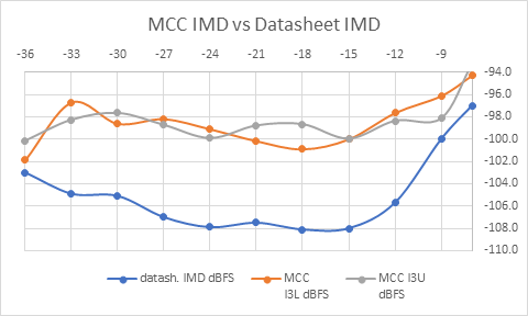

Hi RJH,
Thank you for the quick response on this. The customer is asking because they are seeing non-monotonic behavior on IMD3 data as shown in the figure below. With dither, it should be better than this, more linearity.
Can you provide some feedback on the data they are getting below from the ADS42JB46 EVM (Using the J56 JESD capture card)?
~John
Hi John,
How does the ADC input drive circuit compare with that used on the ADS42JB46 EVM which is shown in Figure 79 of datasheet? I want to be sure the degradation in IM performance does not occur before the ADC.
Eben
Hi Eben,

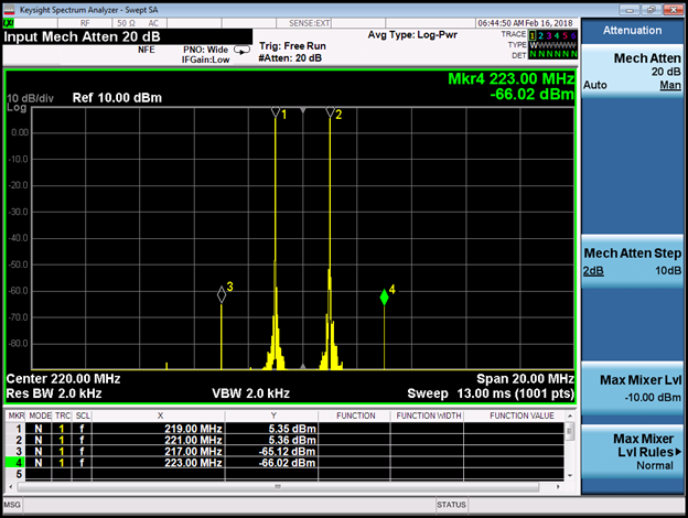

This data is taken on the EVM, with a direct input from a R&S SMW200A.
