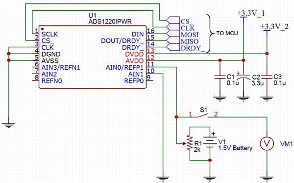

    Firstly, I should show circuit:
    So, I have two + 3.3V LDO voltage sources (VS). The first VS (+ 3.3V_1) is connected to AVDD. I use 0.1uF ceramic capacitor and 3.3uF tantalum capacitor as far as close to AVDD pin. The second VS (+ 3.3V_2) is loaded by DVDD and MCU.

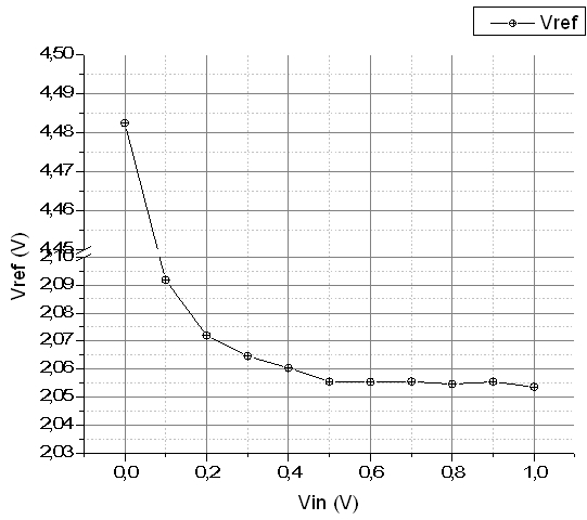

    I have collected practical values of Vref depending on input voltage Vin=AIN0-AIN1. I'm using following expression: Vref=Vin*(10^23)/DEC. Before DEC fetching I turn on S1 and fixing Vin by voltmeter with 0.1% accuracy.
    In the plot below average values of Vref were shown (20 samples per one dot).
    The result is very bad: especially at low Vin. It's clear, that Vref calculation at Vin ~ 0 is unfairly, but at Vin >= 0.1V the values are reliable.
    Do you have any ideas?

    I'm glad to hear that you have made some progress.  What you are currently trying to do is not clear to me.  The internal VREF of the ADS1220 is 2.048V and the reference specifications are given on page 7 of the ADS1220 datasheet in the Electrical Characteristics table.  Normally you would measure an input voltage using the ADC, but apparently you are trying to indirectly calculate the internal voltage reference.
    There are a couple of issues with your measurement.  The main issue is you are violating the common-mode input voltage specification when using the PGA enabled.  Please see section 8.3.2.1 starting on page 22 of the datasheet.  AIN1 connected to AGND violates the specification with PGA enabled.  To make single-ended measurements you must disable and bypass the PGA by setting bit 0 of the Register 0 to '1'.
    Other issues relate to noise and aliasing.  You should add an RC low-pass filter to the AIN0 input to avoid any noise pickup from cabling/wiring as well as provide an antialiasing filter.  I would keep the R value less than 2k ohms and you could start with a capacitor of 10nF to 100nF.
