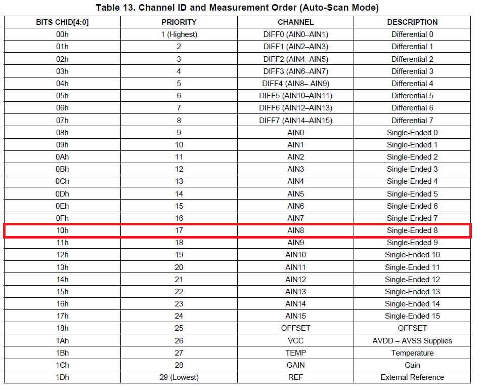

when I read channel data via register format, I get NEW 16. That's it. Why not NEW 8?

    Are the CHID[4:0] bits of the STATUS byte = 16 (10h)?
    According to Table 13, you are getting the correct value that corresponds to AIN8. The values are not mapped 1:1 to the various inputs, as shown below...
    Chris
  • Thanks Chris.
    Yes, I have discovered that The values are not mapped 1:1 .
    But my config register selection has AIN0 turned on. Why would I get AIN8 readings?
  • Oops. After giving that answer, I looked again and see I'm getting exactly what I asked for...AIN8. Thanks for looking over my shoulder Chris...

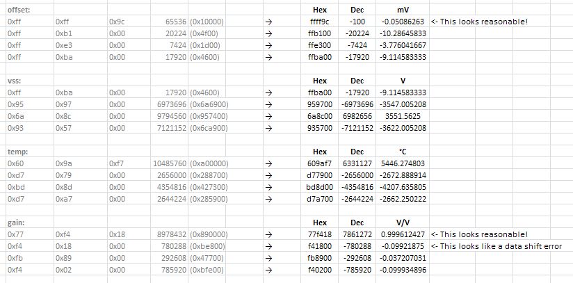

  • OK Chirs, I tried 4 internal monitor channels and the data is below. I am getting seemingly random data. By the way the ref data above should have been good because we have a 4v ref connected.
    the first row below is internal monitor channel name, 2nd row is default config after reset, 3rd & 4th row is 2x query of config after setting for verification. then the NEW means the new bit in the stat byte and the xx: is the chid channel number from stat byte followed by the raw hex bytes of the 24 bit reading followed by MSB and MSB-1 converted to 16 bits and converted to decimal (subtract 1, invert bits). see anything wrong?
    offset:
    0x0a,0x83,0x00,0x00,0xff,0xff,0x00,0xff,0x00,0x8b,
    0x02,0x70,0x00,0x00,0x00,0x00,0x01,0x00,0x00,0x8b,
    NEW 24:0xff,0xff,0x9c,65536 (0x10000)
    NEW 24:0xff,0xb1,0x00,20224 (0x4f00)
    NEW 24:0xff,0xe3,0x00,7424 (0x1d00)
    NEW 24:0xff,0xba,0x00,17920 (0x4600)

  • Hi Mark,
    I don't see anything wrong with your register settings. However, I do see that you are driving all of the GPIO pins low. Is there anything connected to those GPIOs externally that could be causing a contention, or would those pins otherwise be left floating if you weren't driving them?
    If you have a schematic you can share it might be helpful to me...
    Regarding the data you're getting, it does look mostly random. For your reference, here is how I would convert the values you're seeing:
    Have you looked at the SPI communication on a logic analyzer or oscilloscope? It would seem to me that somehow the SPI data is getting corrupted when reading data, even though reading and writing to the device registers is working just fine.
    Chris
  • Thank you very much Chris. This will prove invaluable to me for conversions.

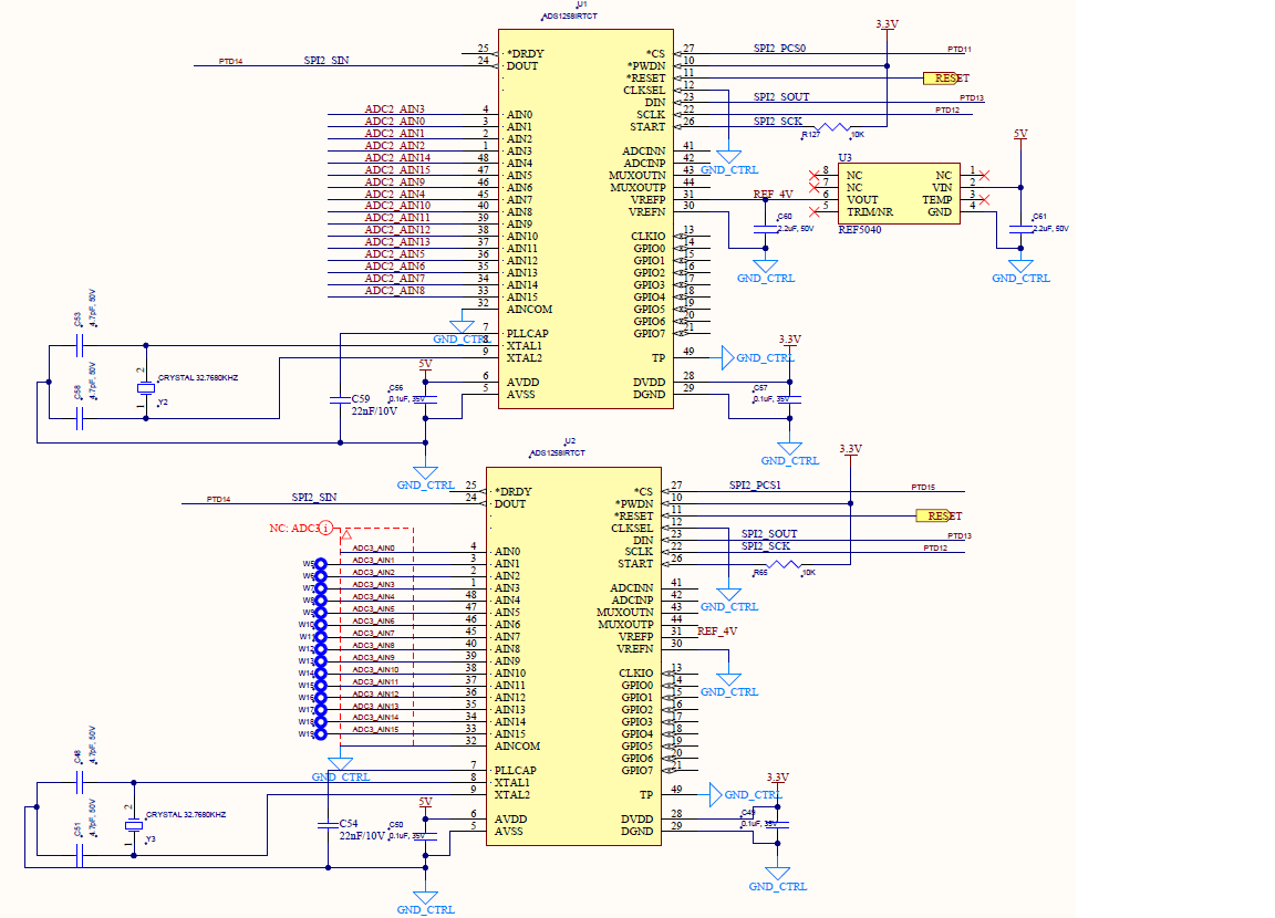

    Schematic attached.
  • Hi Mark,
    Thanks for the schematic! Everything looks okay to me...

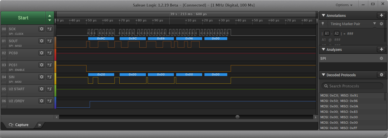

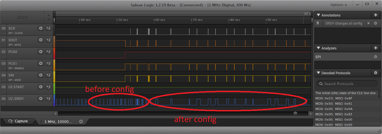

  • Would like to hold off changing baud rate until I understand what is happening.
    Yes, am toggling CS between every access to ads1258

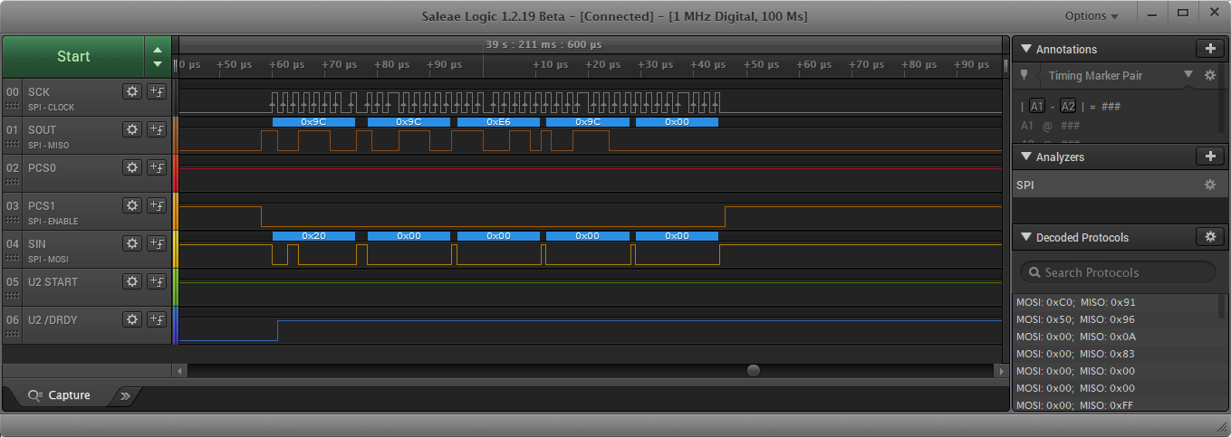

    Logic analyzer screen shot attached.

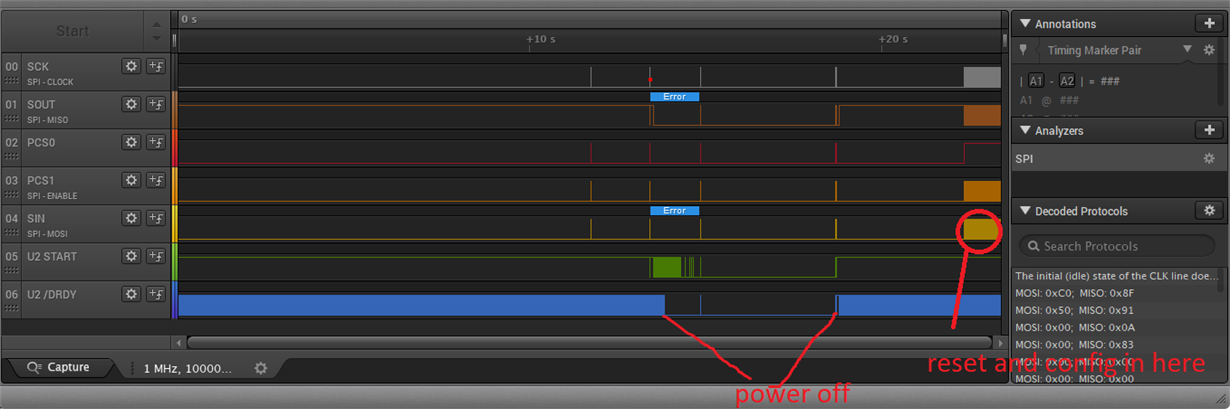

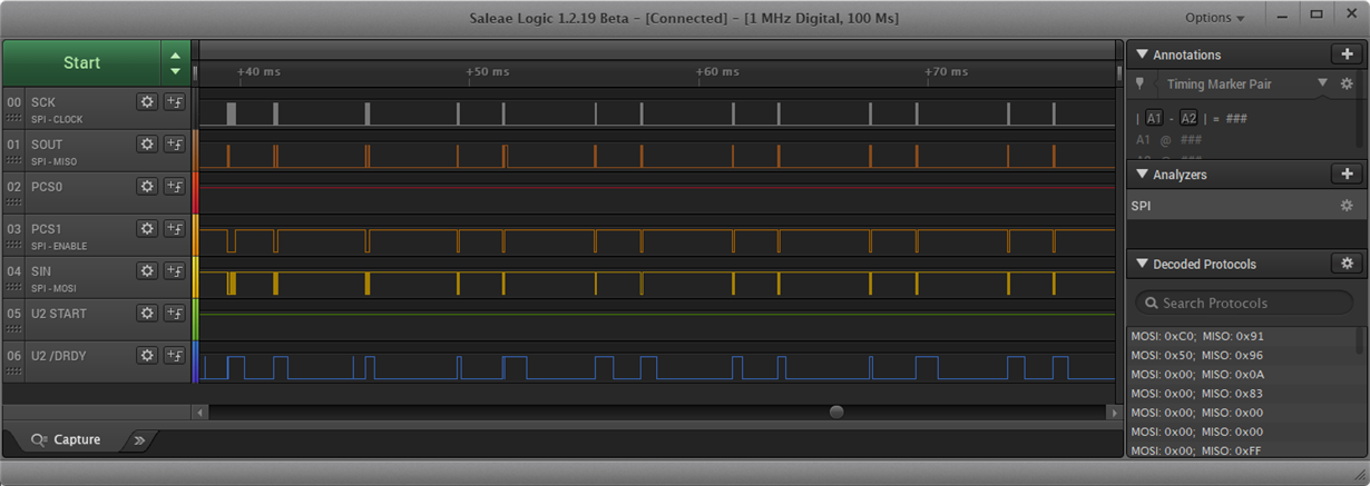

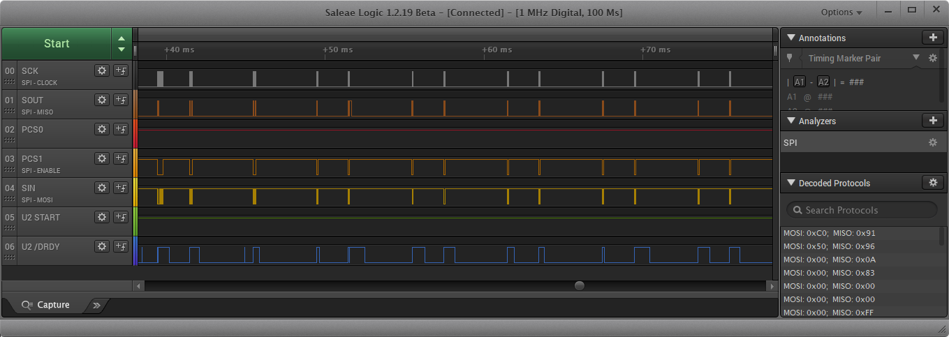

    Trace1: I wonder why /DRDY seems to transition from low to high right at the instant we read.
    Trace2 and trace3 are zoomed in  next to each other in the timeline.

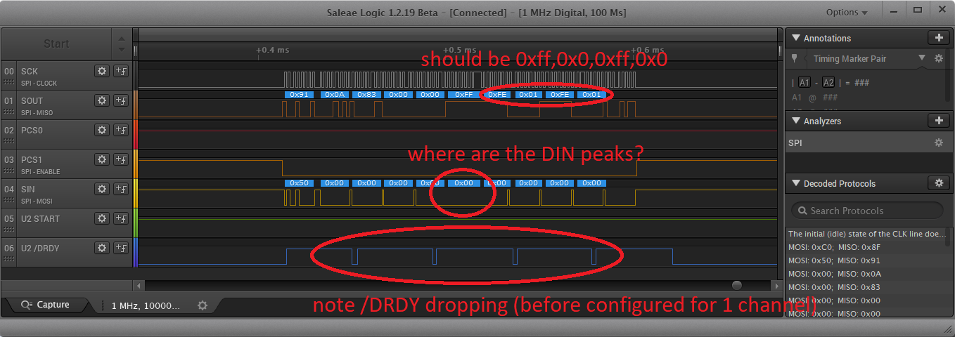

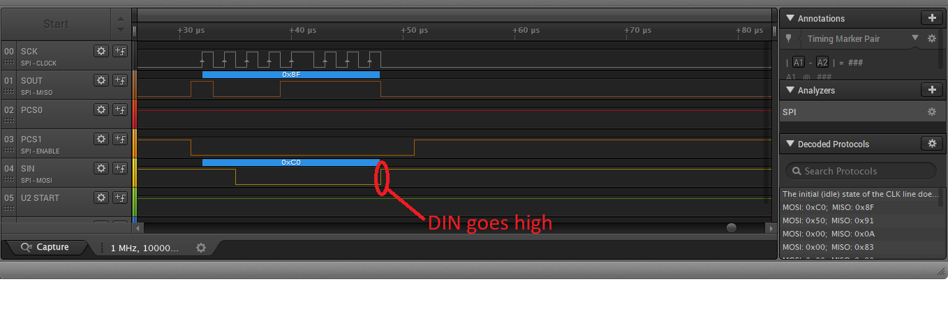

  • Hi Mark,
    Thanks for the screenshots!
    For the ADS1258, it is normal behavior for the /DRDY signal to return high as soon as you start sending SCLKs (refer to figure 52 in the datasheet).
    However, I'm seeing a couple things that look very odd to me:
    1. (From your third screenshot) /DRDY doesn't appear to have a consistent period, but tends to occur about as often as you read the data.
    2. (See my image below) The DIN signal appears to be returning high after each SPI byte. It is hard to tell, but it appears like DIN may be high at the beginning of each byte...If this is the case, you might be sending the 0x10 command (pulse convert), which could be restarting the ADC conversions (hence why the /DRDY period seems to correlate with the reading out data in the third screenshot).
    Might you know why DIN is going HIGH at these times instead of remaining LOW, until all data bytes have been clocked out?
    Chris

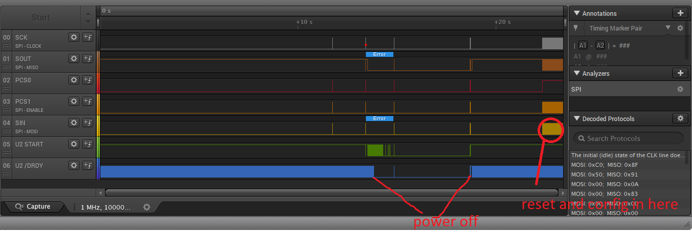

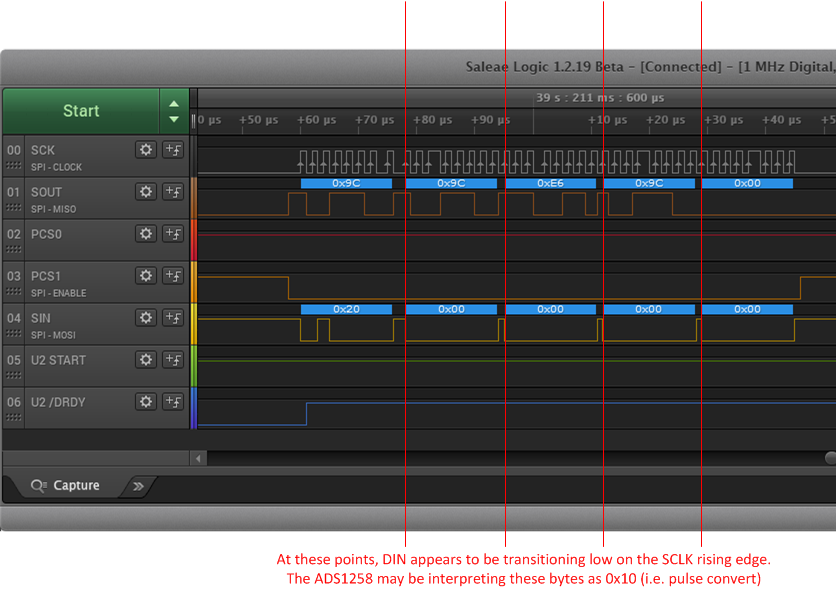

  • power off then on, 3rd sample and other is bad.logicdata.txt1. As you (and data sheet) mentioned, /DRDY "returns high after the first falling edge of SCLK during a data read operation". Since /DRDY only has 1 channel to sample, perhaps it is staying high until the time for that sample has arrived?
    2. I don't know SPI spec but it looks to me like DIN is going high (inactive?) after the bits of the last byte are done but then going low because the (next) 0x0 byte is being clocked in. I admit it looks strange but upon further thought it could be OK. I don't see the high to low transition on all frames. I do see DIN going high after a byte is completed. I thought perhaps the code was causing this but there is nothing obvious. If the code really is doing it, I think it will be the SPI peripheral (which would probably be per SPI spec I'm assuming).
    I've looked at other traces where the data being sent to DIN isn't 0x20,0x0,0x0,0x0 and don't see that pattern.
    I've attached a saleae trace (remove the .txt extension). If you download and install logic.exe (from saleae) you can open it and examine and see what I'm seeing. In the absence of being able to do that I've attached .png files. I captured a power off and power on followed by reset followed by config followed by a bunch o f reads. I don't see /DRDY starting up a consistent timing out of reset (before config has happened). I see /DRDY changing behavior after configuration of registers but still not consistent. I'm thinking that my logic analyzer is injecting strangeness. why does SCLK sometimes stretch?

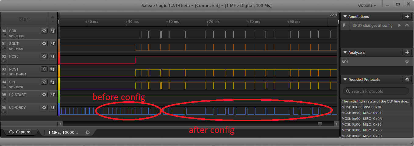

  • Hi Mark,
    Before we get too far into debugging the logic...Can you increase the sampling rate of the Saleae logic analyzer? I've used the Saleae before and I know that if the sampling rate is too slow you can get invalid results. From the Window title it says the sampling rate is 1 MHz. Since you're trying to measure a 500 kHz SCLK, you will see some occasionally incorrect values on the decoded DIN and DOUT signals.
    If you can, It might also be good to double check the logic analyzer results with an oscilloscope. The logic analyzer can sometimes hide all of the noise, ringing, and overshoot (all of the analog characteristics) of the SPI communication to make it look nice and clean, but an oscilloscope might give you more insight into any possible signal integrity issues. If the oscilloscope doesn't show any of those issues, then its okay to going back to using (and trusting) the logic analyzer results.
    Regarding the above screenshots, when you configure the ADS1258 you are decreasing the ADC's data rate and slowing down the /DRDY period, so that makes perfect sense. What is odd to me is that /DRDY is not keeping a consistent period. Either you're somehow controlling ADC conversions or changing the data rate when communicating with the ADC, or else if the data rate is changing on its own then there may be a clocking issue.
    Chris
  • Thanks Chris.
    I did verify the clock with a scope and do not see the longer duration clock pulses.
    Yes, I will increase the saleae sampling rate.
    Agreed that there is something strange going on with /DRDY. Am working to try different code implementation.
  • OK Chris, I was able to talk to the founder of Saleae who cleared up issues with capture. I can now reliably capture traces.
    At this point what it looks like is obtaining readings within less than half of the DRDY cycle works and the values are good.
    But if I initiate a read after half of the DRDY period the data is corrupted.
    Because we don't have knowledge of when the DRDY signal is happening nor do we have control of the START, we can't tell when we should read. We do not have the bandwidth to read faster than DRDY will be cycling when 16 channels are active. That would require us to read faster than 62.5 usec continuously. We have other much higher priority things to do. We could probably configure the SPI to be read via DMA but I have to ask: Is it a normal use case of the ADS1258 to tie START high and not have access to DRDY and still get readings successfully?

    I wouldn't expect to see offsets that large. Do you have any amplifiers in front of the ADS1258 that might not be driving all the way to ground?
    Regarding the internal offset/gain measurements... You definitely can read those values and then apply corrections to all of your measurements. However, it is more common to measure the offset and gain error at the system level (i.e. shorting the inputs external to the ADC, not just shorting them internally to the ADS1258). The reason for this is that you can measure and account for all of the offset and gain errors in the signal path (which may differ from channel-to-channel), whereas going by the internal measurements will only allow you to correct for a subset of the errors (only those introduced by the ADC).
    Chris

    On another note, we'd like to use one START signal for both ADS chips. Will the ADS honor the START (initiate a conversion) when it's PCS is not active?
    We hope not as that will allow us to use GPIO for the START and send it to both ADS and only the one we're talking to at the moment will initiate a conversion.
  • Hi Mark,
    The operation of the START pin is independent of the /CS pin...You only ever need to activate the /CS pin when you want to send any kind of SPI command. The ADC will always respond to a change of the START pin level.
    Yes, it should be fine to connect multiple START pins together. Alternatively, you could set both /CS pins low and issue the pulse convert command to both devices at the same time. Both of these methods should accomplish the same result.

    These are the readings from the internal channels on ads 0 and 1. Do they make sense (the hex digits are the SPI bytes MSB,MSB-1,LSB)? The values following is the 16 signed value.
    0 NEW 24 0xff 0xce 0x00 -50
    1 NEW 24 0xff 0xb9 0x00 -71
    0 NEW 26 0x09 0x0d 0x00 2317
    1 NEW 26 0xe8 0x60 0x00 -6048
    0 NEW 27 0xbb 0xc7 0x00 -17465
    1 NEW 27 0xc0 0x1d 0x00 -16355
    0 NEW 28 0xf1 0xdd 0x00 -3619
    1 NEW 28 0xe6 0x94 0x00 -6508
    0 NEW 29 0x24 0x6c 0x00 9324
    1 NEW 29 0x0b 0x86 0x00 2950
    same readings about 10 seconds later:
    0 NEW 24 0xff 0xc4 0x00 -60
    0 NEW 26 0x0b 0x5c 0x00 2908
    1 NEW 26 0xe4 0x6b 0x00 -7061
    0 NEW 27 0xbb 0x8e 0x00 -17522
    1 NEW 27 0xc0 0x00 0x00 -16384
    0 NEW 28 0xf1 0xd8 0x00 -3624
    1 NEW 28 0xe6 0x9e 0x00 -6498
    0 NEW 29 0x24 0x3c 0x00 9276
    1 NEW 29 0x0b 0x69 0x00 2921
  • Hi Mark,
    Sorry, which internal channel(s) are you measuring? Try checking your results again the following Excel calculator: ADS1x58 Calculator.xlsx
    Regarding the FAE, please check your E2E provided email account for my response.
    Chris

  • Hi Mark,
    For debugging, have tired you disabling all other interrupts in your system to ensure that the SPI read data operation is able to complete without being interrupted?
    The next thing I would do is compare the data you're reading on your processor to the SPI data viewed on a logic analyzer, to make sure that you've read in the data correctly.
    Unfortunately, I'm not available for a call tonight. I have a couple project deadlines of my own that I need to make sure I am able meet. Perhaps if you could persuade my boss to lighten my workload then we can talk ;)
    Chris
  • Thanks Chris.
    Yes, I'm disabling interrupts around the write/read operation AND I'm confirming all reads/writes with a logic analyzer (at 20 MHz thank you very much).
