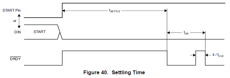

  • Hi Albert,
    After power-up, the /DRDY pin should only transition high after either the START pin is pulled high or the START command is sent. Please see Figure 40:
