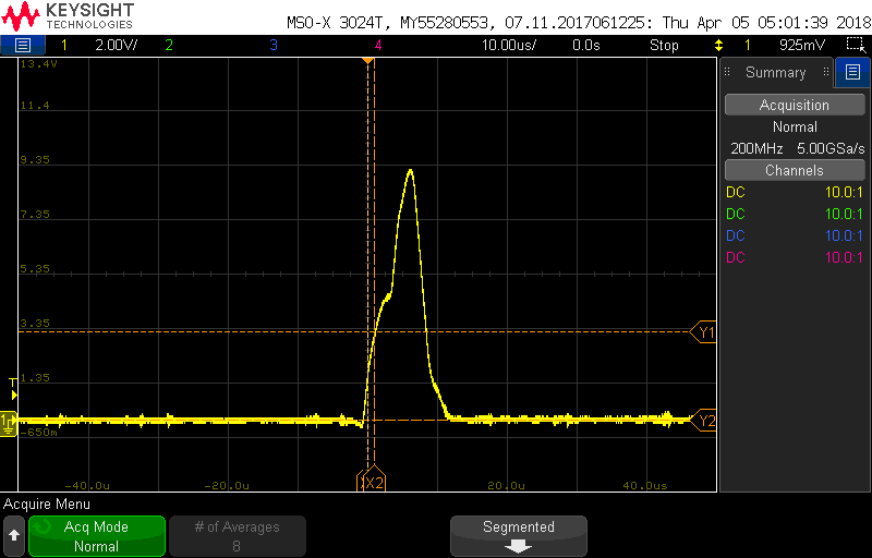

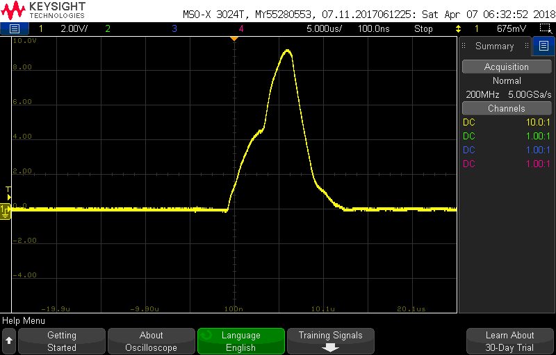

    Because we are seeing the chip come up with incorrect offsets, we are manually setting  our registers for operation.
    The code looks like:
    bool DAC8718_Initialize()
       DAC8718_RegisterLoad(ALL_DACS, DAC_Write, DAC_Addr_CONFIG_REG, DAC_Data_CONFIG_REG_DEFAULT);
       DAC8718_RegisterLoad(ALL_DACS, DAC_Write, DAC_Addr_OFFSET_A, DEFAULT_6_OFFSETDAC_CODE);
       DAC8718_RegisterLoad(ALL_DACS, DAC_Write, DAC_Addr_OFFSET_B, DEFAULT_6_OFFSETDAC_CODE);
       DAC8718_RegisterLoad(ALL_DACS, DAC_Write, DAC_Addr_DAC_BROADCAST, 0x8000);
       DAC8718_RegisterLoad(ALL_DACS, DAC_Write, DAC_Addr_CONFIG_REG, DAC_Data_CONFIG_REG_DEFAULT | 0x4000);
       return true;
    we do some checking in the middle to make sure values stuck, but I have removed it for clarity.  Essentially, we set everything up to be 0V and then latch the values forward.

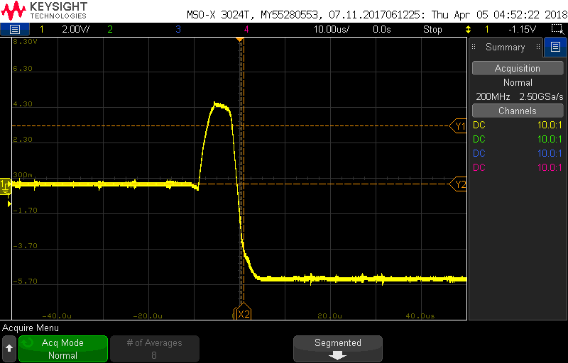

    If I run this code, this I was I get on the DAC output pins:
    Why does this run up to 9V before going to the 0V it is supposed to be?  Why does this exceed the 3xVref (in our case 5.4V) ever?

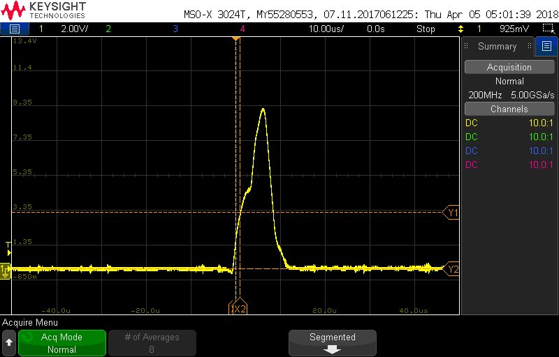

    If I drive it to the floor on initialize by changing the broadcast line:
       DAC8718_RegisterLoad(ALL_DACS, DAC_Write, DAC_Addr_DAC_BROADCAST, 0x0000);
    I see this on the DAC output pins:
    Why does it go positive to go low?

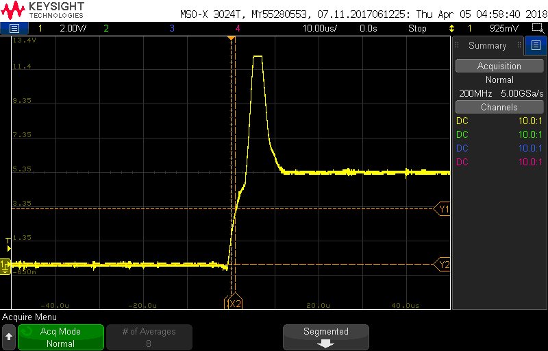

    If I change the broadcast line to drive the DAC high at boot:
       DAC8718_RegisterLoad(ALL_DACS, DAC_Write, DAC_Addr_DAC_BROADCAST, 0xFFFF);
    I see this:
    It is artificially clipped, but why the overshoot?
    All in all, this DAC is not behaving well...
    Adam
  • Adam,
    This looks like some power integrity issue. We usually don't see this large code-to-code glitch. Could you also plot the power supplies during this transition?
    Uttam

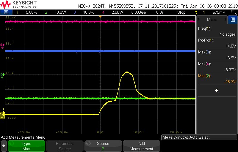

  • So here are the 3 grabs.  In each, yellow (bottom trace) is the output of the DAC for each case.  Red(ish) is the 3V3 rail, which is IOVdd and DVdd.  Blue is the 16V5 (AVdd) and green is the -16V5 rail (AVss).  They are shown with their grounds in the same place for convenience.
    The first trace is for when we set the output to be 0V (0x8000):
    There seems to be no distress on the rails here even though the glitch is large.

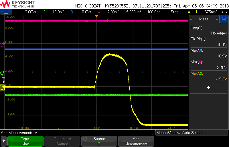

    Next is the code for going to max rail.  Our references are 1.8V now, so this should be ~5.4V (I had to shrink the range to 5V/div to get the whole overshoot):
    Again, nothing seems wrong with the supply rails.

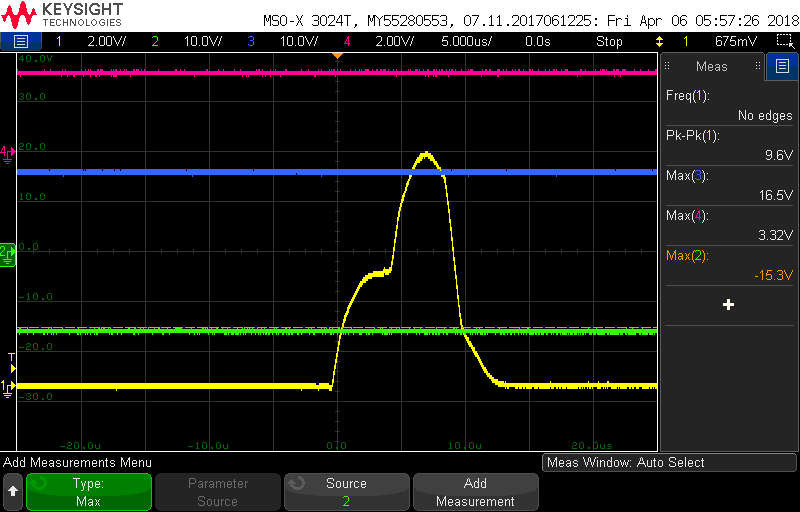

    Lastly we have setting it to the floor (0x0000) which should be -5.4V:
    Again, the rails look pretty solid even though we have this glitch that runs up before it goes down to intended output voltage.

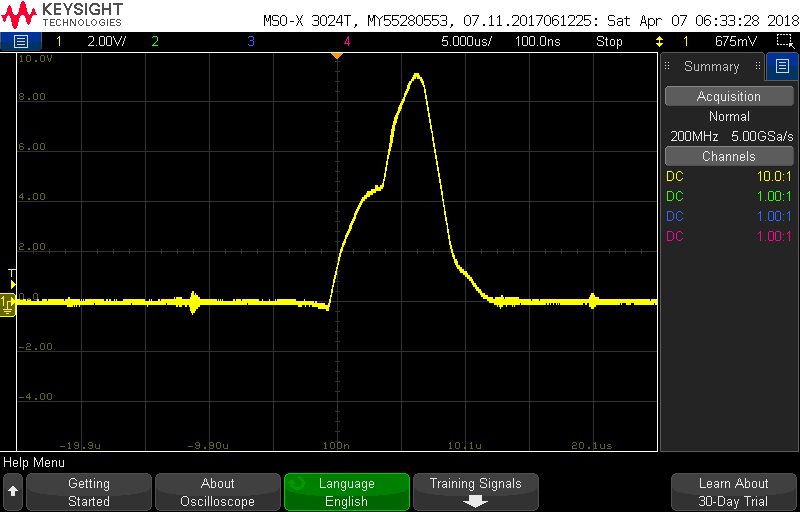

    Let me check this with the team and get back. What is the output load, by the way. can you try putting an RC load and see if this reduces. You can use something like 5K || 200pF
    Uttam
  • Here are the results with 5.1k//220pF as a load/decoupler.
    With the load:
    without the load:
    I see the work of the 220pF, but not the effect of the load in general wrt straightening out the response.
    Adam
  • Hi Adam,
    The glitches you are observing are very unrealistic as far as the DAC is concerned. I am not very sure what could be causing this. The DAC8718 being an old part, the last thing I would do is to doubt the device. Could you please find out if there is any coupling between the outputs and power supplies? You can also check the same conditions on EVM and other boards.
    Uttam
