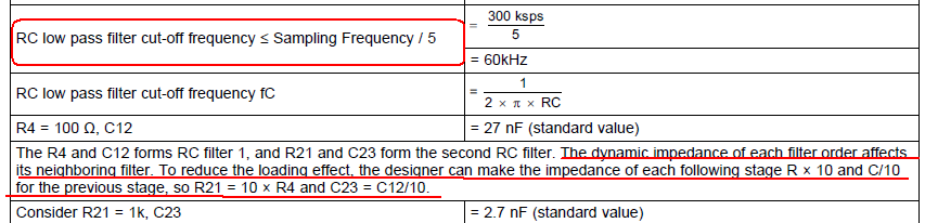

TIDU365B–Revised September 2014  design guide shows below. Could you help explain why RC low pass filter cut-off frequency samller than sampling frequency/5? Why impedance of following stage R*10 and C/10 for the previous stage?

    The RC filter cut-off frequency is chosen such a way that the aliased frequency component levels are low. The aliased component values depend on the order of the filter and the cut-off frequency chosen. In this design a simple 2 stage cascaded RC filter design is chosen as a trade-off between filter roll-off and cut-off frequency. The second stage R and C values are chosen such a way to avoid loading of first stage filter and make the calculations simple. However this can be improved by using filter calculation tools to get better filter responses without the constraint of 10x Resistor values.
