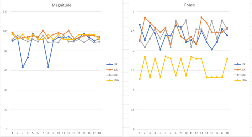

  • Hi Prabin,
    Thanks for the reply.
    1. How would I calculate the expected voltage given the impedance? I might have missed this in the datasheet.
    2. Yes, the wait time (>200ms) did help make the measurement stable. Our data collection process is - 1) performing multiple impedance measurements (we've been testing around 7-11 measurements, 860SPS each) and getting the average 2) Performing separate/independent task for ~40-60 seconds 3) repeat 1&2. What we're finding is that while within each measurement cycle, the values are fairly consistent or within tolerance. However, the cycles relative to each other are not consistent, as you can see in the screenshot below. The wait time does help minimize the deviations but only to a certain extent. Any ideas?
    Cheers,
    Terence
  • Hi Terence,
    In FWR mode the expected voltage will be ~ (0.5 *1.05Vpp* Impedance / 1.5KOhm ).
    Form your plot I have few questions:
    1) Each plot is for different excitation frequency , isn't it?
    2) during delay of 40-60 sec , do you switch off signal chain or change any parameter ( excitation frequency).
    3) Can you please measure the calibration resistors before you take any measurement after the delay of 40-60 sec delay? If calibration resistors has a same trend, you can use this information to correct the measurement for other impedance. In fact we call this as calibration routine as discussed in section 8.2.2.

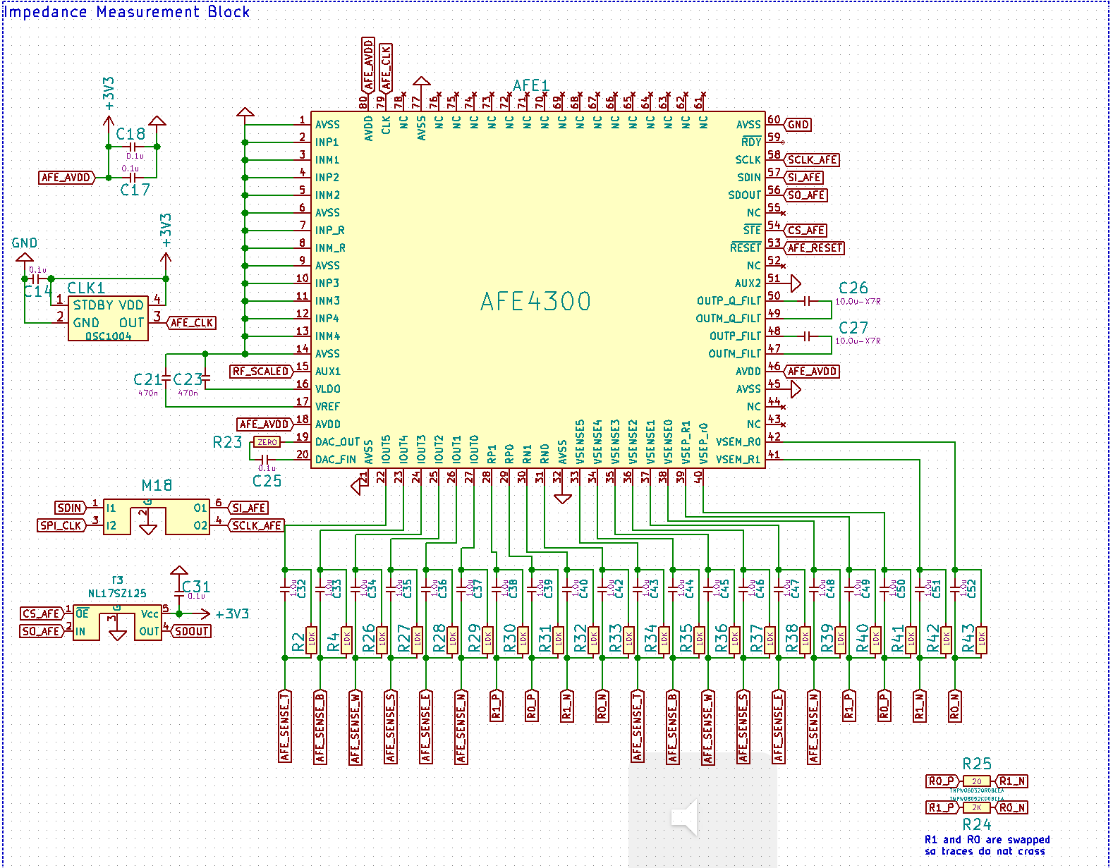

  •  Hi Prabin,
    Could you please take a look at our schematic? Perhaps we're not implementing it correctly... we do not switch off the signal chain during the delay, and we did follow the calibration routine (after each frequency switch) after  each 40-60 sec delay, but still no luck in getting good measurements.
