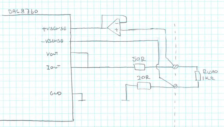

I have to put some filters in the output. These filters gives an ohmic resistance for 50R and 20R as shown in the schematic drawing below.
In voltage output mode the 20R resistance will give 0,2% failure when the output is 10V with a 1 Kohm load, so I was planning to use the -VSENSE input to compensate for this error.
My question is if it is the correct way to use the -VSENSE pin. The datasheet says that the voltage level on this pin should only be a few µV from the GND, but in this case it will be up to 200mV. Is this to high? On all reference design I can find, the -VSENSE pin is connected to GND.

    Could you elaborate on the filter and why this is adding a series impedance between the load impedance and ground?

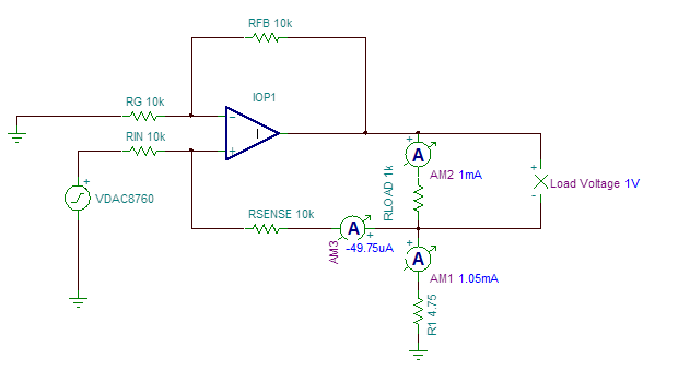

    If this is a requirement, then indeed this is a shortcoming of the -VSENSE pin, in fact as is shown on Figure 83 in the datasheet there is actually a 2kOhm (+/-20%) resistor to ground as opposed to a real sense connection. So the internal DAC circuits would not help compensate for the loss of accuracy.

  • Hello Kevin
    Thanks for the quick reply.
    I think that I will change the design, so that instead of the operational amplifier for the +SENSE input I will use an instrumentational amplifier like INA826 with the gain set to 1. The input to the instrumentional amplifier will be measuring above the output terminals on my design, and the output set to the +VSENSE input on the DAC
    In this way the error caused by the 20R resistor should be eliminated, and still the current output and the output impedance will not be affected

  • Niels,
    Just so we can be clear and aligned, can you maybe make a quick drawing of your proposal? I just want to make sure my understanding / visualization of your proposal is correct...
    Pretty sure you're looking to put +IN at the high-side of your load and -IN at the low side of the load with the differential Vo voltage connected across +VSENSEP and GND.
    I think that should be reasonable as well.
  • Hi Kevin
    Below is a drawing off my porposal.
    The idea is to measure the voltage above the load with the instrumentational amplifier, and send the output from the amplifier to the +VSENSE pin on the DAC8760.

  • Hi Neils,
    Thanks.
    This is what I expected to see. I think this should be a good solution.
