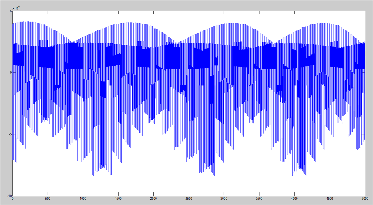

I now use the nordic nrf52832 to debug the ADS1291. Now the problem is that the acquired signal has no QRS waveform. The waveforms drawn by the schematics and acquired data through matlab are as follows. The original data is in the attachment.
1. I referred to the driver of ADS1292R and transplanted the driver code to nrf52832.
www.ti.com/.../TIDM-BIOSIGNMONITOR
2. Now that the register can be read and written correctly, the device ID can be correctly read as 0x52; I am not sure if the register is configured correctly? The values of registers 1 through 11 are configured as follows:
0x02, 0xE0, 0xF0, 0x00, 0x00, 0x23, 0x03, 0x00, 0x02, 0x07, 0x0C
I write these values into registers and read them out to match them. For ADS1291, is my register setting correct? If I want to adjust the parameters, which parameters should I adjust?
3. The conversion mode uses a continuous conversion mode. When entering the DRDY interrupt, 6 bytes of data are read. The ECG status byte is always 0xc00000. This is normal. Will the ECG data read need to be processed? Because it is the type of complement.
What is the processing of the collected data? Can be used to draw waveforms in matlab.Here is my treatment. Is it handled correctly?

The
If( (u32_SatatusADS1x9xData & 0x00f00000) == 0x00c00000)
If(u32_EcgADS1x9xData & 0x800000)
u32_EcgADS1x9xData ^= 0x8FFFFF;
u32_EcgADS1x9xData += 1;
Tmpdata = (int32_t)u32_EcgADS1x9xData;
Tmpdata = tmpdata * (-1);
Else

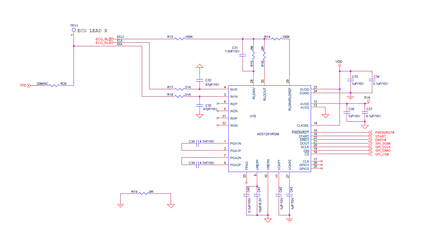

4.It is normal for the multimeter to test that the voltage of AVDD is 5V. The voltage of DVDD is about 2.75V. Is this not normal? Because the VDD voltage is 3.3V.
5.I am using a hardware SPI controller configured as follows:
#define NRF_DRV_SPI_ADS1X9X_CONFIG \
.sck_pin = ADS1X9X_SPI_SCLK_PIN, \
.mosi_pin = ADS1X9X_SPI_SIMO_PIN, \
.miso_pin = ADS1X9X_SPI_SOMI_PIN, \
.ss_pin = ADS1X9X_SPI_CS_PIN, \
.irq_priority = SPI_DEFAULT_CONFIG_IRQ_PRIORITY, \
.orc = 0xFF, \
.frequency = NRF_DRV_SPI_FREQ_500K, \
.mode = NRF_DRV_SPI_MODE_1, \
.bit_order = NRF_DRV_SPI_BIT_ORDER_MSB_FIRST, \
5.I have doubts that the reference example uses a clock rate of 1 MHz, but it is not possible on nrf52832. The internal clock is used on nrf52832. why?
6. Is the function ADS1x9x_PowerDown_Enable necessary in the ADS1292R initialization code in the reference design example? as follows:
However, this function is not called in the example in the ADS1292R evaluation board. I have some doubts about this, should I use this function?

Schematic
-1029267
-7067859
3934524
624395
596499
1421343
2266578
588367
-1877499
-1048576
-1048576
-7083168
3994041
659706
626714
1453738
2300419
705744
-1797922
-1048576
-1048576
-7104856
4039879
678701
610672
1435985
2281384
669455
-1817845
-1048576
-1048576
-7201091
4042934
691107
607866
1434213
2280706
819647
-1685702
-1048576
-1048576

Matlab drawn waveform

  • Hello Yihui,
    Welcome to the E2E forum and thank you for your post!
    Unfortunately I cannot offer support for the Nordic nrf52832, however will offer support where I can for the ADS1291.
    1) Cannot offer support of Nordic device.
    2) Registers: these can be reviewed on page 39-49 of the datasheet.
    0x02 - CONFIG1 - (Default)
    0xE0 - CONFIG2 - Lead off comparators enabled, Reference buffer enabled, otherwise default
    0xF0 - Lead off Control Register - Comparator postitive side 70%, Comparator negative side 30%, otherwise default
    0x00 - Default
    0x00 - Default
    0x23 - RLD buffer enabled, RLD connected to IN1N, RLD connected to IN1P, otherwise default
    0x03 - Channel 1 lead off detection positive and negative inputs enabled, otherwise default
    0x00 - Default
    0x02 - Default
    0x07 - 64kHz Respiration control frequency, otherwise default
    0x0C - Default
    3) Yes the data will need to be processed. It is 2's complement binary type and can be converted to either decimal codes or volts as you choose. If the first bit of the data is high then the resulting number is negative, otherwise convert from binary to decimal as normal.
    4) DVDD of 2.5V is within the acceptable limit. This can be seen on page 5 of the datasheet.
    5) Cannot offer support of Nordic device.
    6) Using the power down function is not necessary. Use at your discretion.
