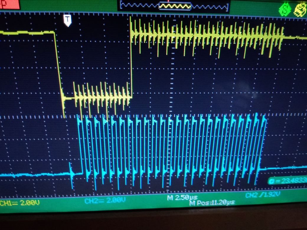

  • Hi Garrett,
        Thanks for your reply. I have attached for Latch, Clock and MOSI Pin out Oscilloscope images along with this post.
    DOUT with Clock
    Latch with Clock Before seeing your post
    Latch with Clock after editing

  • Hi Ranjith,
    Thank you for providing waveforms.

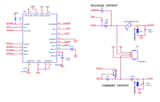

    In your 3rd waveform you show the rising edge of LATCH after the 24th clock edge which looks correct but did you ever bring LATCH high beforehand? There is a minimum LATCH high time of 40ns so if you never bring it high it may cause an issue.
    When you say you attached a 5V supply does this mean you connected 5V to the reference? I know you said previously the reference was 700mV. It is concerning that the reference does not come up to 5V. Is it possible that you are shorting it somehow on your board?
    Can you provide a schematic to verify your hardware setup?
    Garrett
  •  Hi Garrett,
        I have verified the hardware the Pins Refout & Refin Pins are shorted. Still no clue.
        Currently writing the data as first writing Control register to disable output and then continue on writing on 0x01 register and again in control register to enable the input.
  • Hi Ranjith,
    I looked over your schematic and do not see anything that would lead to this issue. Have you measured the voltage of the internal regulator DVDD? Does it come up to about 4.6V?
    It seems like there is some hardware issue if the reference is not behaving normally. Have you tried multiple DAC8760 devices or multiple boards? There may be some unintentional shorting on the board.
    Garrett

        Sorry my mistake the data has been interpreted wrongly. The actual bit is Compliance voltage compensation or open circuit bit. But I have connected the resistive load of 250Ohms in the IOut Pin and Ground. So I need to solve this problem.
    Ranjith
  • Hi Garrett,
         If it is compliance voltage violation problem in my case I have provided Avdd with 0 to 12V, if this is the case I can't get the output then for 250/500 ohms of resistive load according to the equation as below,
    Avdd>=Compliance voltage+(max.Current * resistiveload)
    how much Avdd should be provided and how to know the compliance voltage.
    Ranjith
  • Hi Ranjith,
    The equation you have provided is correct. The datasheet specifies that the alarm will occur if the voltage at IOUT is greater than AVDD-2V. So the compliance voltage for the transistor is about 2V. This 2V of headroom is required for proper operation of the transistor.
    There should not be an alarm condition driving a 250 ohm load at 20mA but driving a 500 ohm load at 20mA would be the maximum before entering the alarm condition region. Have you confirmed that current is flowing in the loop? The same alarm will trigger if the loop is open.
