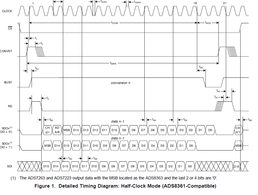

    Are you using the device in Half-Clock Mode or Full-Clock Mode?
    When the device is using Half-Clock Mode, there is a latency of  (1)  frame to read the conversion results, in other words, the current frame is providing data of conversion (n-1). On this mode of operation, the data of conversion (n-1) is provided while the ADC is executing  conversion (n). Therefore, when using Half-Clock Mode, when the device just have been powered up, the first conversion data frame is invalid since you are reading conversion (n-1).
    The Full-Clock Mode provides data without latency; i.e., the device provides the conversion results right after the conversion is completed, during the acquisition phase (tacq) of the next conversion. Please see below the timing diagram for Half Clock Mode.
    Please let me know if you have questions.
    Thank you,
    Luis

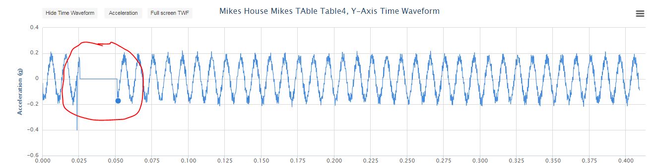

  • Hi Luis,
    Thank you so much for the reply.  Yes that was the issue, we are running Half-Clock so I ended up throwing out the first sample.  I have attached a picture of the read with 2048 samples.  It seems during the read the A/D pegs low as seen in the attached pic.  Any ideas on what would be causing this?
    Thanks again
    Mike

  • Hi Luis,
    I attached a picture of it happening again reading an accelerometer at 100khz.  Allows us to see the issue a little more clearly.  I am also attaching the schematic of the A/D.  I will work on those Oscilloscope pics.
