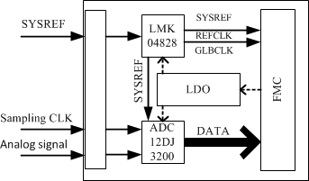

One XC7VX690T carries two ADC12DJ3200 FPGA Mezzanine Cards. The structure of FMC is as follows.
The LMK04828 is configured in 0-delay mode and provides SYSREF, REFCLK, GLBCLK.
The LMK04828 is first configured through SPI, then the ADCs are configured through SPI.
The ADCs use JMODE0.

    I have just solved this problem. The SYSREF output for ADC is not configured correctly. In that case, ADC should work in the subclass0 mode.
