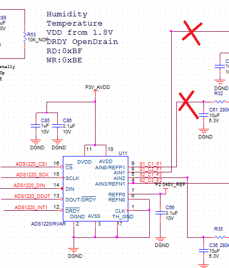

Customer uses ADS1220 in diffenttial mode with below experiment:
(1)cut off the input with"X" label, using AIN0 and AIN1 as its differential channel to test
(2)  input the power voltage between AIN0 and AIN1, then make some sample test, the data rate is about 0.5s
(3) got the test result in attachment.
sheet1's data is based on the registers' value: 0x60,0x00,0x50 and 0x00
sheet2's data is based on the registers' value: 0x61,0x00,0x50 and 0x00
ads1220测试.xlsx
the question is that why the sample data is wrong, when the PGA is configured,  can you make some explanation?
