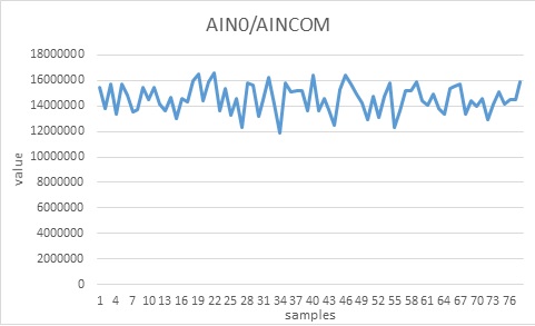

    Thank you for your response. I am modifying it according to your suggestion.  I make REFP to 5 Volt and REFN to 0 Volt.  But I have another problem now. I select AIN0/AINCOM (2.21 Volt) it convert value 15514490( ECBB7A h, averaged). However, AIN1/AIN0(0.02 Volt)  return value 9249840(8D2430 h, averaged). Isn't AIN1/AIN0 output value need to close to zero or small enough? Why it convert such a large value?
    By the way. The value of convert has a large range of oscillation(Figure). I am very sure that it should actually be fixed. How can I correct it?
    You need to make sure that the voltage is connected as you think it is. For AIN1/AIN0 you are getting a very large negative value close to negative full-scale. It appears that the AIN1 connection is not as you expect (like close to 0V). Check your connections and voltages at the ADS124S06 input pins, especially for AIN1.
    Also, you may want to take a look at your voltage sources with an oscilloscope to make sure that the noise you are seeing in your measurement is not the noise of the voltage source
    Bob B
