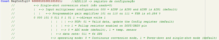

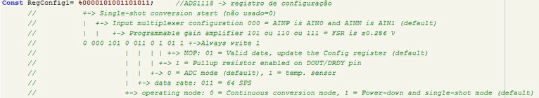

ADS1118 register settings:

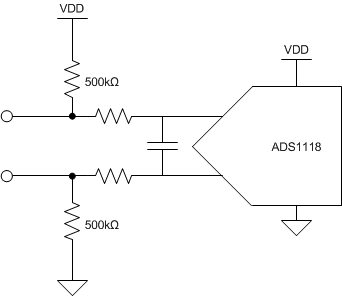

  • Jose,
    If the input voltage is small and isolated, then you might treat it similar to how you would treat a thermocouple. You could attach a large resistance (~500kΩ) from AN+ to VDD and another same large resistance from AIN- to GND. Then remove the remaining resistors on the front end. You would have something like this in the end:
    The two matched resistors balance the input at the front end without loading the source voltage. I would check to see if this works and gets you results without any kind of settling with changes in voltage.
    Joseph Wu

  • Jose,
    Using the resistors for biasing doesn't mean that you can't use an anti-aliasing filter on the front end. You can still use one like this:
    The ADS1118EVM uses the same type of front end.

  • Joseph
    After some days testing the above circuit, as many ways I could imagine with a precision voltaage source calibraated in uV, it´s working perfectly and ADS1118 has a very high initial precision and linearity . For the filter, resistors are 330 Ohms and C is a 10uF smd, ceramic multilaayer.
