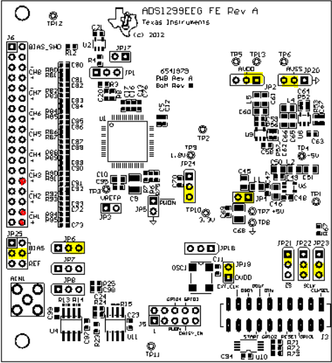

Here is the  Jumpers I set.(The red spot is bias electrode and differential measurement electrodes)

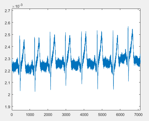

Here is the ECG and EEG I measured(1000hz)
My dates have a lot noises,I wonder is there any mistakes about my configurations.
May I ask for your help?

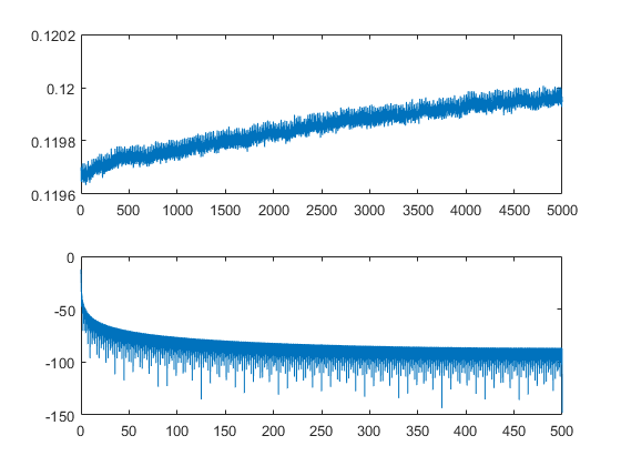

  • The lost pictures.
    Thank you for providing the lost pictures. Can you provide a little background on these? What is the second picture of and why are the jumpers out of their default positions? I'm just trying to understand what you're trying to do with the device.
    Additionally, what are the rest of your register settings?

  • I tried your suggestion. The answer seems better than before.
    This is my recollected data and and a small amount of filtering.
    As for the modification of the default pin settings of the daughter board, I added the Bias electrode and removed the reference electrode.And I use the ADS1299's internal clock.
    If you want to see specific changes, I can point out to you.
