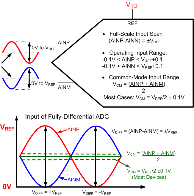

    The ADS8866 with single-ended inputs converts the analog input voltage with respect to ground (GND); where AINM (negative input) is typically connected to analog ground where the voltage in the negative input is fixed.
    A fully-differential such as the ADS8867 converts the differential voltage across its inputs (AINP-AINM) where both the positive input (AINP) and negative input (AINM) accept a dynamically changing signal; where the positive and negative input signals are complementary or inverted from each other.  A device with fully differential inputs as the ADS8867 is typically driven using a fully-differential amplifier (FDA) such as the THS4521, THS4531, THS4551 or with a operational amplifiers driving each input (one OPA driving AINP, another amplifier driving AINM).
    Please refer to the TI Precision Labs-ADCs Training Sessions and figures below.

    Single-Ended VS Fully-Differential Input
    Fully-Differential Input SAR ADC
