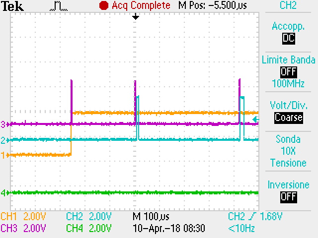

I have a custom board with an ADS8568 configured in hardware mode. I trigger the coversion with a PWM generated from a microcontroller; all 4 CONVST pins receive the same signal.
In my firmware, I check the delay between two consecutive BUSY  falling edge, and I've noticed that sometimes the delay is way lower than the PWM period.
Analyzing the problem with an oscilloscope, I've noticed that there are spurious BUSY signals not relative to any CONVST (the CONVST is clean and steep, so it is not due to noise on this signal). Debugging the problem I've noticed that the occuence frequency of these "spikes" is relate to the read frequency. As an example, reading all 4 channels, I'll get a spurious busy once every 10 seconds. If I don't read anything after BUSY falling edge, I'll get no spurious BUSY.
For testing purpose I'm working with a slow CONVST (50Hz). As said, ADS8568 is in HW mode, parallel interface.

  • Hi Dale,
    here are a couple of screenshots.
    Blue waveform is a "software trigger"; the firmware generate a pulse when it detects a BUSY interrupt with a short delay with respect to the previous one.
    Yellow waveform is the CONVST signal. Purple line is the BUSY signal.
    As you can see, CONVST get high, and the ADC generate the BUSY signal as expected. A spurious BUSY signal is generated after ~200us, while CONVST is still high. (firmware detects the event and generates blue pulse). Another spuroius BUSY is generated after ~400us. As said in the previous post, CONVST period is 20ms.
    Blue waveform is the "software trigger", again; generated just after the spurious busy (not shown here).

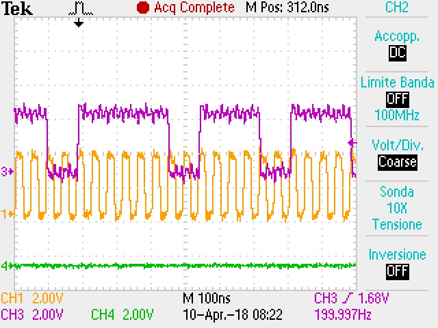

    Purple waveform is the nCS signal. All 4 channels are read, with 4 16+16 bit burst. The readout always starts ~2us after the BUSY interrupt. The full interrupt routine takes about 10us to complete; just to point out that the spurious busy doesn't always happen after a parallel acces (see previous screenshot).
    Here is the parallel interface main signals. Purple waveform is nCS signal (3 16+16bit read burst are shown here).
    Yellow waveform is the nRD signal. As you can see, the nRD signal is switching continuously. I'm working with a Freescale Kinetis processor, using Flexbus interface for parallel communication. With Flexbus, the "clock" (nRD signal here) is always running. Anyway, the nCS signal that actually enables the communication with the ADC is set only during actual read.
    Side note: nWR is always high (btw, is not used in HW mode).

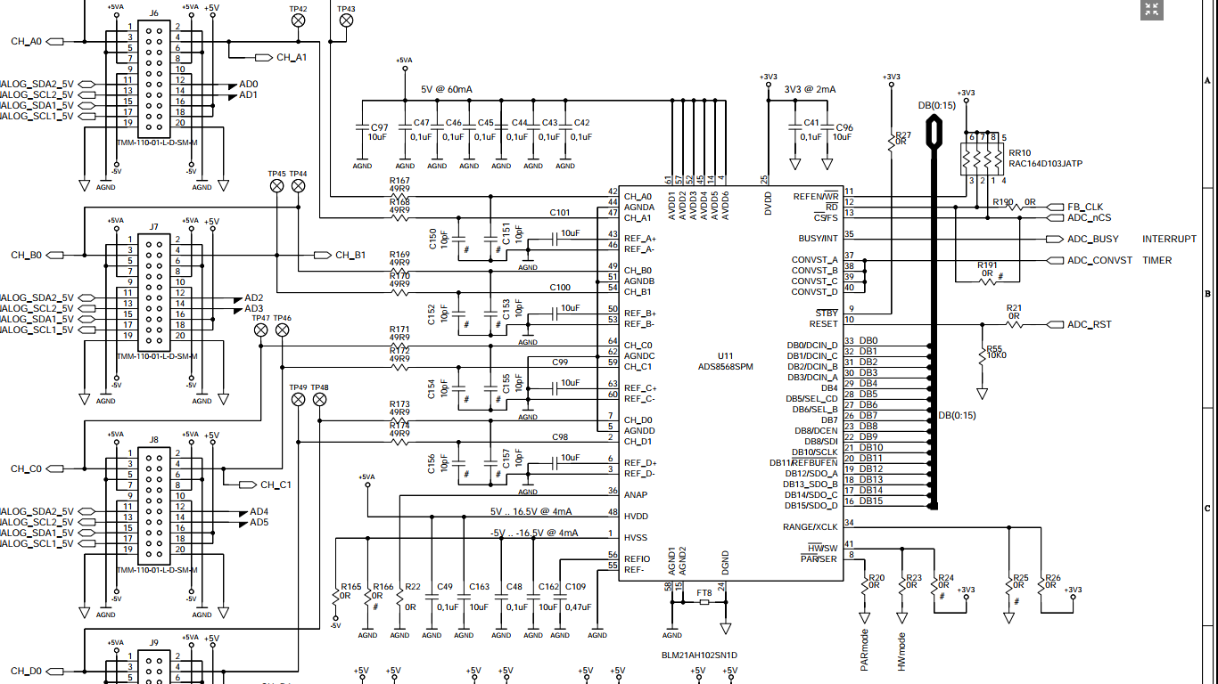

    This is the schematic of the ADC. Components labeled with a # are not maounted on the PCB (e.g. R191, R24, R25, ...).
    All signals are directly connected to the uC pins.
    Hope this is enough to info to have a clear picture of the issue.
    Let me know if you need any further info.
    Thanks!
  • Hi Massimo,
    Thanks for your information.
    Your connections and configurations in the schematic look fine to me only except the driving circuit, generally you need a proper amplifier and RC filter to drive ADS8568, the proper driving circuit will settle the input signal properly during the ADC's acquisition time, so you will be able to get the performance specified in datasheet, this is another topic, please refer to TI Precision Labs online training about "SAR ADC Input Driver Design" session in below link:

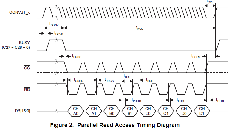

    In your 3rd screenshot, the timing of nCS (Purple waveform) and nRD (Yellow waveform) may gve you incorrect data, you have two nRD low pulses during one nCS low pulse.You can keep nCS low during total 8 channels data reading, or you can make nCS low for every channel's data reading, also there are timing parameter requirements between nCS and nRD, please check Figure 2 in datasheet also as below.
