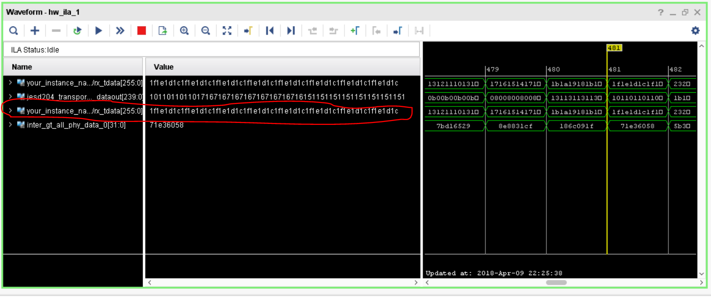

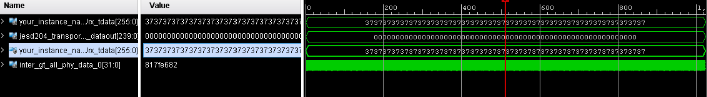

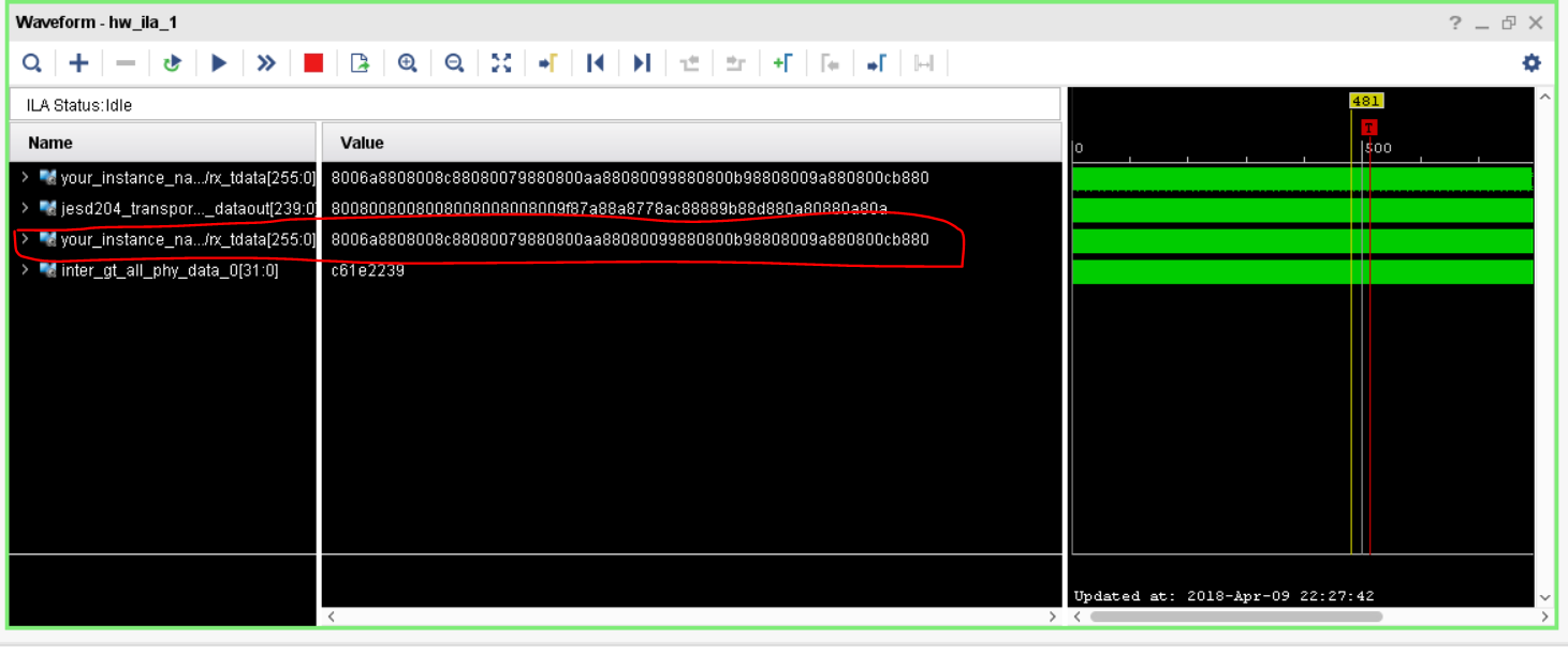

I am working with ADC12DJ3200EVM. FPGA is based on board with 8 GTX on FMC con.
For ramp test mode I see, that data is OK. For normal mode I get wrong data (same samples are corrupted). I am using JESD204PHY and JESD204 IP (both are from Xilinx).
Settings: 4 GSPS, ref. clk = 400 MHz, Linerate = 8 Gbps, core:clk = 200 MHz. Power supply give up to 4 Amps.
Ramp mode vs normal mode:
  • Hi David
    Please note that the ramp test mode only sends out a ramp at the octet level, not at the sample resolution of the selected JMODE.
    What JMODE are you currently configuring the EVM for?
    Do you have scrambling enabled or disabled at ADC and FPGA?
    Is your FPGA firmware compensating for the lane mapping and polarity inversions present on the ADC12DJ3200EVM?

    Can you share the data broken out for each of the 8 lanes for at least 2 frames (16 octets per lane)?

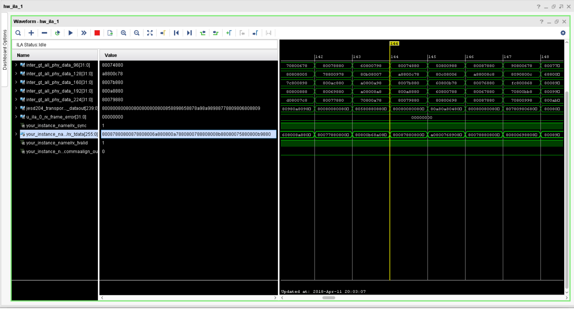

  • I am using JMODE0.
    Do you have scrambling enabled or disabled at ADC and FPGA? Enabled
    Is your FPGA firmware compensating for the lane mapping and polarity inversions present on the ADC12DJ3200EVMYes
    Frames:
    80098880800688808009788080086880800a88808009c880800a8880800a9880
    800a988080089880800998808004788080079880800ca880800b988080099880
    808007a8808005987080099890800448a0800b8890800aa8a0800ab890800a98
    Sometimes, I get data e.g.:

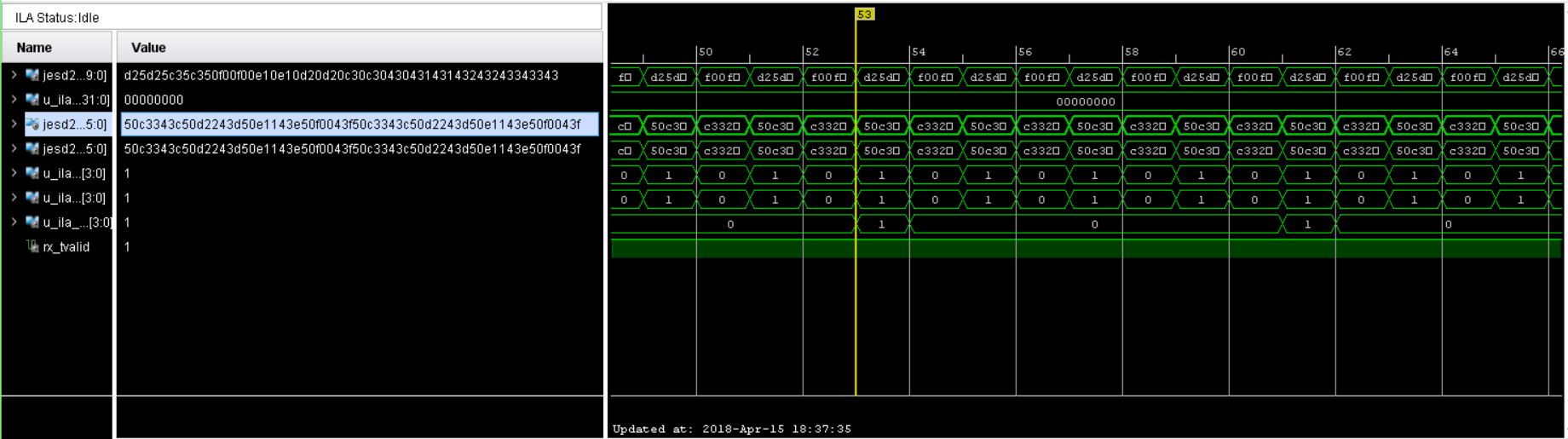

    It would also be useful to enable the Transport Test Pattern. This will send a very specific pattern of data on each lane that should help us debug what is happening.

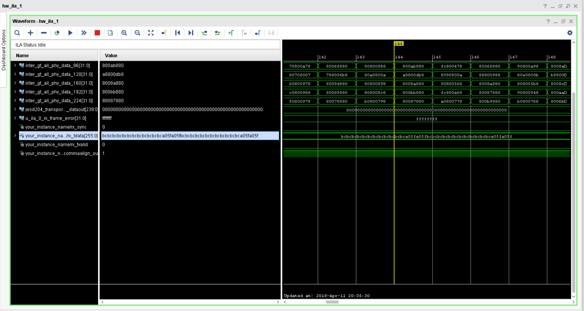

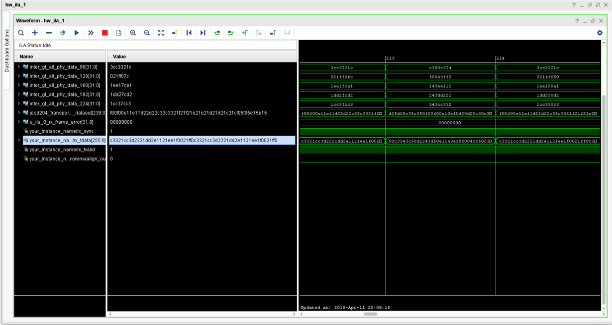

    Link parameters: K = 4, Scrambler off, JMODE0, Sample rate = 4 GSPS, ref. clk = 400 MHz, LineRate = 8 Gbps, core_clk = 200 MHz, SYNC: TMSTP is used.
    There is very often problem with Frame Error.
    Normal_data (Frame Error = 0):
    Normal data (Frame Error = FFF...):
    Transport test mode:

  • Hi David
    The data with transport test mode enabled is the most useful.
    It appears that data is coming through correctly but it is hard to interpret for the following reasons.
    1: I see the repeating pattern in the frame, but the start and end of frame data are not aligned in the 32 bit data blocks.
    2: Within each 32 bit block of data, the 8-bit values (2 hex codes) are rightmost, and the later ones are to the right. So it is confusing to re-order into the proper sequence.
    If I look at the 2nd row down, this corresponds to the expected data for lane DA0 or DB0. The first 12-bit value expected is 0xF01. So we need to find F0 in the data, with 1F to the left of it (later in time). This occurs in the middle of the first block of data.
    I'll retype all 3 blocks and then re-arrange for clarity:
    021FF0FC F0043FF0 021FF050
    Starting at the highlighted characters and working left within that block we get:
    F0 1F 02 then starting at the right of the next block we have F0 3F 04 F0 then 50 F0 1F 02
    Grouping together into 12 bit values we get:
    F01 F02 F03 F04 F05 0 F01 F02
    The highlighted 0 is the 4 tail bits at the end of the frame. The other lanes look similar.
    The only anomaly from the expected transport test pattern data is that we see FC occuring in some locations. Those values are the JESD204B frame alignment monitoring character (K28.7) that are inserted into the data stream as expected according to the character insertion rules with scrambling disabled. You may also see 7C (K28.3) multi-frame alignment character appearing for similar reasons. The JESD204B receive IP should handle these characters and replace them with the appropriate values according to the same rules. This is discussed in section 5.3.3.4.2 of the JESD204B.01 specification. Xilinx should be able to help you if there aren't being handled correctly.
    I think these same characters not being handled correctly may be causing the Frame Error = FFF... in the Normal data capture you provided.
    I hope this is helpful.
    Jim B

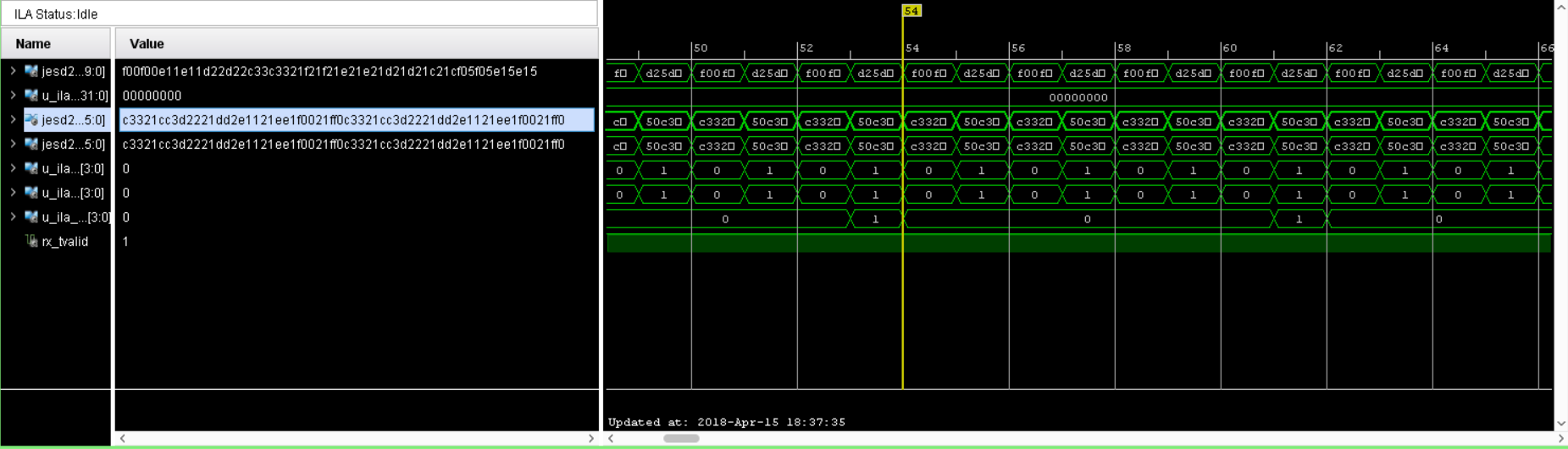

  • Hi Jim
    I would like return to your analysis. Did you analyze data from PHY layer (inter_gt_all_phy)?
    Because these data goes from PHY layer (before RX core with character replacement), so the character such as K28.7, etc. are expected, or not?
    The output from RX core is named your_instance_na... (highlighted row), on RX core I do not see K28.7 symbols. Sorry for mystification.
    EDIT:
    I think that there is a problem with errors in  the bit order. instead of a problem with character replacement.
    TRANSPORT LAYER:
    first half of frame:
    second half...
  • Hi David
    I only analyzed what I was seeing in the PHY layer. The information I'm seeing there looks correct. The alignment characters are expected to appear there, but should be replaced by the JESD204B IP.
    I don't understand the information in the highlighted row in the 2 TRANSPORT LAYER images above. It looks like information from all 8 lanes is combined together into that output, which is not what I'm expecting to see. If you're not getting the correct results at the output of the RX core then I think it is either not configured correctly, or there is some other problem.
    Jim B
