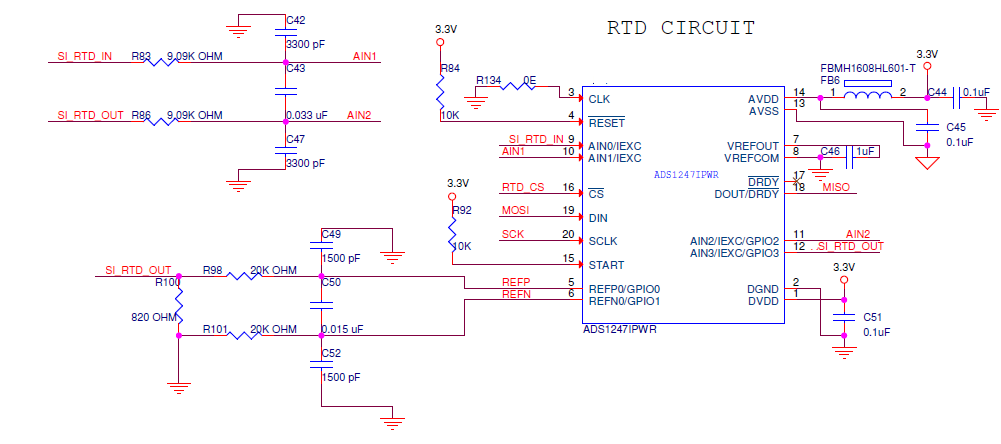

    Based on the labeling on the schematic you show, it looks like you are making a 3-wire RTD measurement. The ADC inputs are set to AIN1 and AIN2, while you use two current sources at AIN0 and AIN3 to drive the RTD. The two current sources are summed into the reference resistor (R10, 820Ω) which is the reference. The schematic basically looks correct, but let me know if there are any changes or unpopulated components.

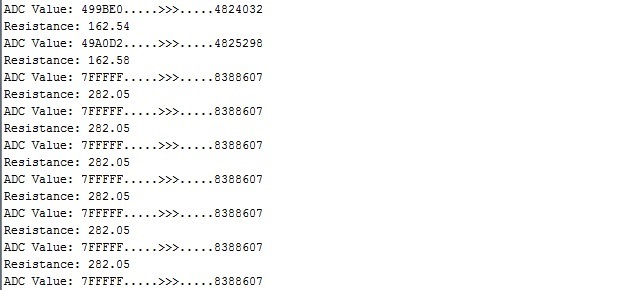

    First, 7FFFFF is not a random output. That value is a positive full-scale measurement. This could mean several different things (the input is much larger than expected, the gain is too high, the input is disconnected and has floated to a large value, or it could mean the reference is 0 or much lower than expected).
    Second, if you've copied the design from the ADS1247 datasheet, the voltage across the reference resistor should be 1.64V not 0.82V. This is shown in equation 26. There are two IDAC current sources, with one going into first lead of the RTD while the other goes into the second lead of the RTD. Both currents are summed and leave the RTD through the third lead and both drive the reference resistor. The principle of this is shown in Figure 116.
    I think that you have a bad connection in the RTD test for the second IDAC current because your numbering is a bit off. If you're getting some 0 data, then I think your other RTD connections might be bad. However, starting with the first data, you get 499BE0.
    499BE0h = 4824032d
    If you ignore the second IDAC current and only current from IDAC1 is entering the RTD, then you have basically the correct value. The RTD resistance is calculated:
    RRTD = 4824032 * RREF / (Gain * 2^23) = 4824032 * 820Ω / (4 * 2^23) = 117.89Ω
    This value is close to your expected value of 120Ω. However, this measurement includes some lead resistance from the RTD. As explained earlier, you would have two IDAC currents driving different leads of the RTD, so the calculation would have been:
    RRTD = Output code * RREF / (2 * Gain * 2^23)
    This is because the reference voltage is twice as large, because there are two IDAC currents. I'll note that your measurement is a bit off from expected. This could be because your test RTD measurement is off from 120Ω or the reference resistance is off from 820Ω. If you want a precision measurement, both values need to be low in error. Also, if you want a very accurate measurement from this 3-wire measurement, you'll need to swap the outputs of the IDACs and take a second measurement to average. This will remove the error from the mismatch of the IDAC currents.
    Read through these comments and the application design in the datasheet carefully. Then check the connections of the RTD and the board. You should be able to get the correct output from the ADC.

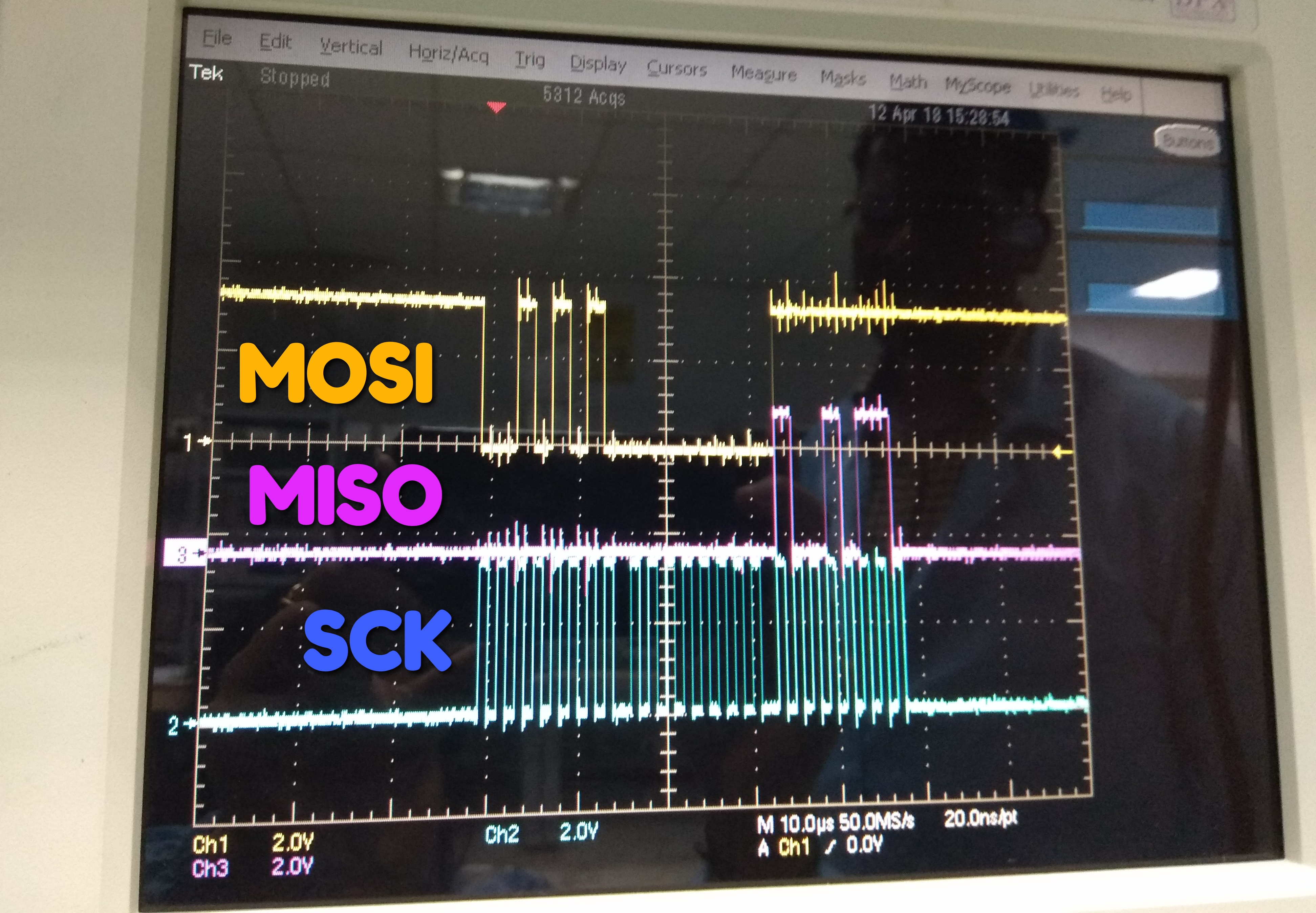

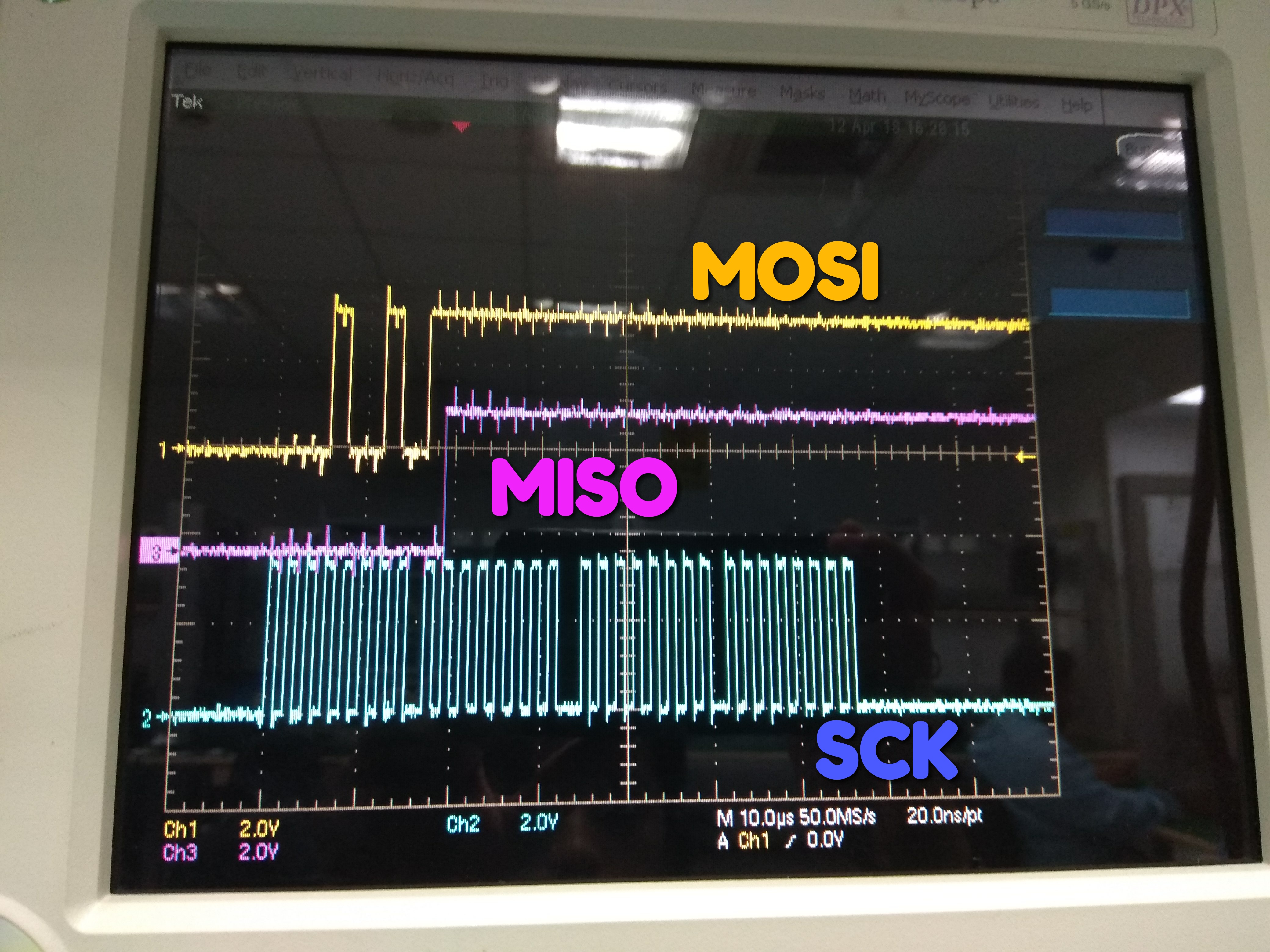

    It may be worthwhile to use an oscilloscope or logic analyzer to check the data coming out of the ADC and look at the /CS, DOUT, SCLK, and DIN lines (maybe /DRDY also). I would check that the data is coming out uninterrupted from a new conversion (by checking against the /DRDY).

    Serially printed raw data:
    IDAC_0 =0x96, because it includes device ID also.
    ADC value (temperature value) is 0x7FFF.

    DRDY\ pin is not connected to micro controller. I captured /CS, DOUT, SCLK, and DIN lines in oscilloscope. CS\ remains LOW only.
    Then I modified the code to read only temperature data (RDATA&NOPs) , removed RREG part. I was calling function to read temperature in loop with 1s delay.

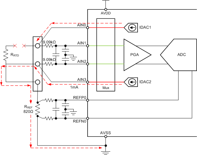

    I've looked through your last post, and the register values that you are able to read back seem correct. MUX0 is 0A for using AIN1 and AIN2 as the inputs, MUX1 is 20, always enabling the internal reference, setting the reference to REFP0/REFN0, with the device in normal operation. SYS0 of 22 sets the PGA=4 at a data rate of 20SPS, IDAC0 of 06 sets the IDAC current to 1mA, and IDAC1 of 03 routes the currents to AIN0 and AIN3.
    At this point, I still think you have a bad connection somewhere. This is what I think it looks like.
    If the test resistance that you're measuring is broken where the red x's are, you'll get results similar to what you're getting. IDAC1 is trying to route 1mA to the RTD resistance, but it doesn't get there, pulling up on AIN1 to near AVDD. IDAC2 properly routes current to AIN3, but since IDAC1 does not reach RREF, the voltage at AIN2 is only 0.82V. With AIN1 near AVDD, the voltage from AIN1 to AIN2 is much larger than the full-scale. This gives an ADC reading of 7FFFFFh. At the same time if you measure the voltage across RRTD, you get a voltage of 0V because there's no current across it.
    There are several things you can do to debug the circuit. You can try making an ADC measurement from a different location. Measure AIN0 to AIN1 or AIN2 to AIN3 to see if they're still connected. You can also reroute the IDAC currents to different pins to see if the current from IDAC1 comes out somewhere else. Using a voltmeter or ohmmeter to check the circuit would certainly help.
    Regardless, can you please post a closeup picture of your circuit and the front end. There might be something that I can see that you can check.

    One thing that I just noticed was the inductive filter for the supply. This would be the FBMH1608HL601-T attached to AVDD. I think you should remove this and replace it with a short. Because the ADC has digital currents (and other switching currents with the analog supply), the inrush currents can be large. This will cause large ripple voltages because of the L(di/dt). In this case, it is also complicated with the fact that the filter has a 600Ω series resistance.
    It's possible that this inductance could cause a device reset. When first powering it on, and enabling the reference, the in-rush current could be large. This could cause a power-on reset to occur because the supply voltage may have drop below the allowed supply.
    Regardless, I would remove the inductor and short the leads.

  • Hi Joseph,
    Thank you so much for the help.
    Its my bad that i didn't check the resistance (120ohm) pin connection. It was soldering mistake. After that I am getting output.
