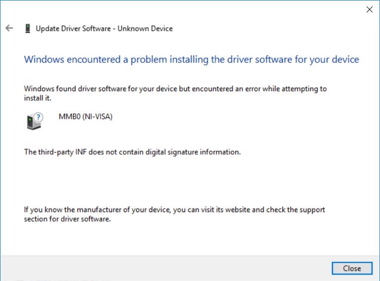

I'm trying to setup the ADS1282EVM-PDK in default configuration & facing some issues with the software.
After the installation of ADCPro for the evaluation, the drivers are not getting installed. I tried to update the driver from the installation folder & getting the following error.
Also, the ADCPro GUI should show the ADS1282EVM(according to userguide) when prompted from EVM tab in the GUI, but even that is not showing up in the GUI.

  • Hi Shashank,
    What operating system are you trying to install this driver on?
    From the error message you showed, the problem appears to be that the driver is not signed. Unfortunately, we don't have a signed driver for the EVM so you may need to disable Windows 8 or Windows 10 driver signature enforcement to be able to install this driver. You can refer to the following web article with instructions how to disable diver signature enforcement:
    If you still find that you are having issues after disabling driver signature enforcement, you might try the stand-alone MMB0 driver installer, as we'd had issues with the driver installer that is built into the ADCPro installer. You can find this stand-alone installer at ftp.ti.com/.../ (select the appropriate subfolder based on your OS type).
    Let us know if that resolves the issue.

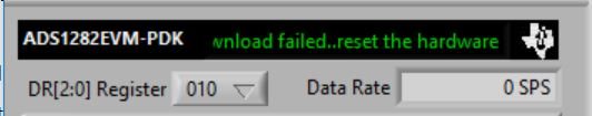

  • Hi Chris,
    With the external FTDI driver, I'm able to establish the USB connection but however facing issues with firmware download. the following error message shows up after the USB connection is established.
    Even after multiple RESET & tries, the issue persists.
    I'm trying to setup a nominal working demo with default configuration using ADS1282PDK, the setup is as follows:
    6V input to MMBO at J2(DC_IN) & the USB type A from MMBO to computer. Is this 6V sufficient to power the ADS & MMBO or any other power inputs are required?

  • Hi Chris,
    We were able to resolve the issue with -5 volt input to MMBO. Can you please help me in understanding why is that required for the EVM to get detected & firmware to download?
    Shashank
  • Hi Shashank,
    Without the -5V supply, the ADS1282EVM will not generate the -2.5V AVSS power rail, which will cause the analog power supply to float. As shown in Figure 51 of the datasheet, the ADS1282 requires both the analog and digital power supplies before it is operational.
