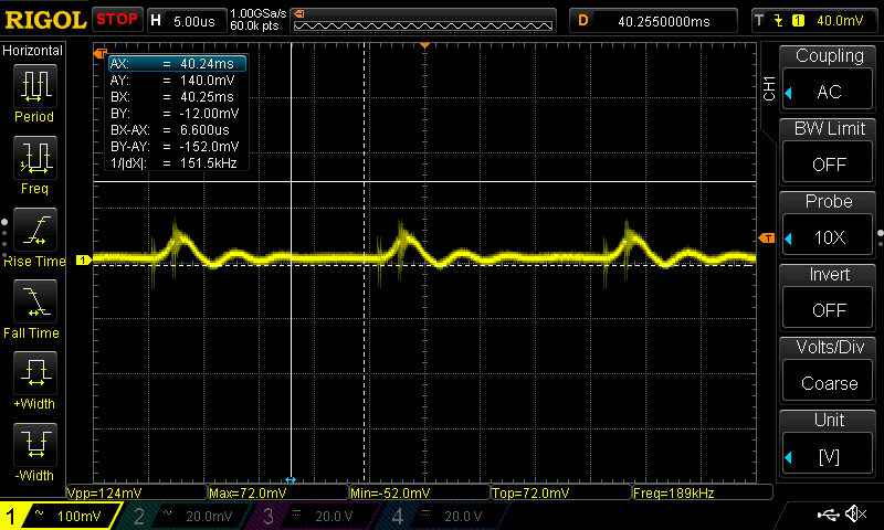

I guess its build from AVDD, which is 5V normally. How is the ref related to the stability of AVDD?
AVDD is generated with a transfomer and i have some noises on 5V supply.
Does it have any affect on the reference?

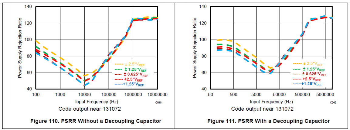

    The internal reference (4.096V) on ADS8694 is a band-gap reference which is a very stable voltage reference in regard to both temperature and power supply variations, but the power sources to ADS8694 must be clean and well-bypassed (refer to Layout Guidelines in datasheet), especially for analog power supply AVDD, generally a linear regular (LDO) is recommended for the ADC, otherwise, it will have a significant impact to the performance you measure regarding the noise/ripple on power supply, please refer to below figures for ADS8694's power supply rejection ability:
