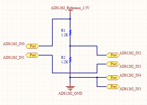

    I'm using the ADS1262 to read three load cells (AIN0-1, AIN2-3,AIN4-5)
    I'm using the pulse conversion mode, 50sps, changing the input multiplexer register (AIN0-1), sending the "START1" command, waiting for DRDY go low, reading, sending the "STOP1" command, changing the input multiplexer register (AIN2-3) and repeating .

  • Hi Guanzhong,
    Would you be able to share a schematic of your circuit?
    It's hard to say what might be the issue without more data. Are the conversion results stable if you take multiple conversions on the same channel? Have you verified that the input signal is indeed constant and not changing.
    You'll also need to make sure that the reference voltage is stable. What is your reference voltage source and is this source also used to excite the load cell?
    I would trying measuring each input multiple times to see if you are getting a consistent result or if perhaps there is an RC charging effect when switching between channel. In that case you might need to try increasing the programmable delay to allow for additional settling time.
    Chris

    I use the ADS1262 evaluation kit and its internal 2.5V reference source,and the microcontroller I use is STM32(SPI communication),here is my test circuit:
    When I use the single channel(IN0-IN1), I measured the voltage of 2.49698V(Any sample rate). I take multiple conversions on the same channel (IN0-IN1,IN0-IN1,IN0-IN1),the measurement result is unchanged.
    When I convert the channel(IN0-IN1,IN2-IN3,IN4-IN5) ,I measured the voltage of 2.49680V(2.5 sps,IN0-IN1),but measured the voltage of 2.49565V(50sps).
    Looking forward to hear from you!

  • Hi Guanzhong,
    Not a problem.
    Are you using the ADS1262's PGA or it is bypassed to allow for a wider common-mode input range?
    If you are bypassing the PGA, yes, it will allow you to measure a single-ended input referenced to ground; however, because your resistors are not a low-impedance source, you might have some gain error resulting from measuring the voltage divider directly into the ADC's modulator (which is not a high-impedance input).
    I would recommend retrying the measurement with a low-output impedance source, such as a bench supply if you have one available.
