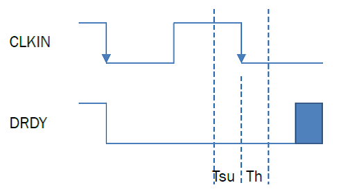

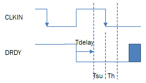

② Timing for /DRDY and clock (CLKIN or SCLK)
 Please let me know about recommended timing for /DRDY and clock.
 Customer is worry about metastable,
 ・This case is /DRDY made by CLKIN rise, but the margin of Tdelay is small.
 ・This case is /DRDY made by CLKIN fall, but I think possibility of metastable.

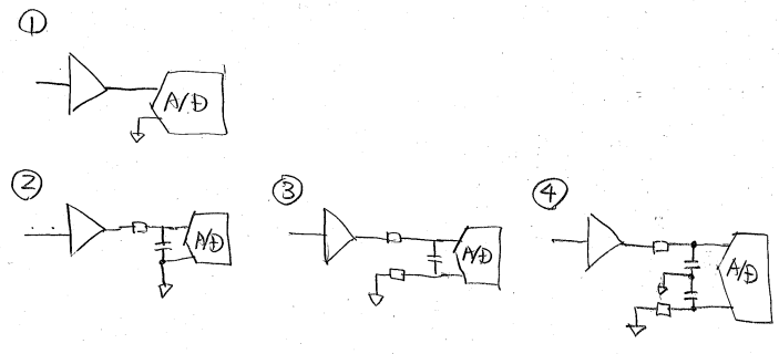

③Input connection
 If ADS131A04 input side(AINx) is connecting OPA1678, is RC filter necessary to connect between OPA1678 output and ADS131A04 input?
 Or is direct connection no problem?

    ③Input connection
    The RC filter at the ADS131A04 inputs serve two purposes. First, the differential capacitor provides charge to the internal sampling capacitors. This helps the input voltage settle more quickly between modulator samples. Second, the series resistance needed for amplifier stability also forms a single-pole, low-pass filter for antialiasing.

    Customer hope "the case of /DRDY made by CLKIN fall".
    But if there the other good idea, customer will consider this idea.

    Additional question for ③, which is recommended connection below? (R value are 1~2kΩ)
    I think that number ④ is better, is it correct?

  • Hello Satoshi-san,
    Thank you for the details.
    In "Synchronous Slave Mode" (sorry for using the wrong name before), the internal clock source (ICLK) can be generated from either the external signal connected to the XTAL1/2 or CLKIN pins (CLKSRC = 0) or from the SCLK input (CLKSRC = 1). Which setting is your customer using?
    The timing specifications for both CLKSRC settings are described as tSU(sync) and tH(sync) = 10 ns (minimum) in Figure 4 and Figure 5.
    In Figure 4 (CLKSRC = 0), it is ok to align /DRDY falling edge with CLKIN rising edge. You must keep the CLKIN falling edge at least 10ns after the /DRDY falling edge.
    In Figure 5 (CLKSRC = 1), it is ok to align /DRDY falling edge with SCLK falling edge. You must keep the SCLK rising edge at least 10ns after the /DRDY falling edge.
    Either circuit (3) or (4) will work fine. I believe (3) will provide better common-mode rejection.
