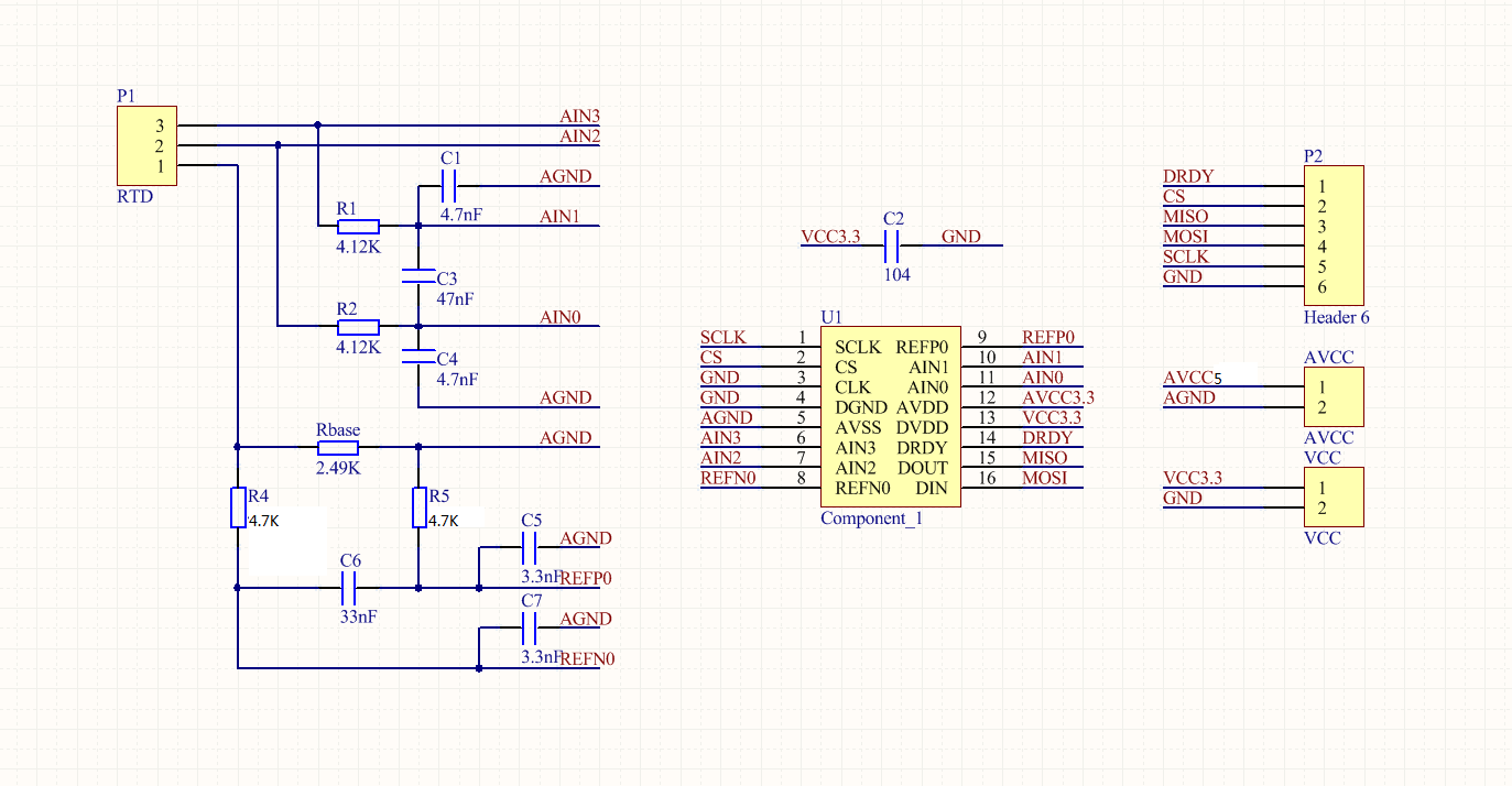

Here is my Circuit schematic , I have combined the design of the datasheet ADS1220 and the design shown on figure40 page 33 of TIDU271
The compoments selected for the fliters of VIN and VREF are based on the data shown on page37,38 of TIDU271
The SPI channel is connected to a MCU STM32F103.
The registre setting is 66h 04h 55h 70h .
I can change the value of VREF(mesuring by a voltmetre) by changing the registre setting(value of IDC), I think it means the SPI connection works well.

    Welcome to the E2E forum!  Let's start with the schematic first.  You have a supply decoupling cap on the digital supply (C2), but you should also have one on the analog supply as well.  For the RTD circuit to the ADS1220, there is an issue with the reference connection and how the reference is connected to the RTD.  The net labels REFN0 and REFP0 are incorrect and should be swapped.  You want the REFP0 connection to be connected to the junction of R4 and C6.

  • Hi Bob !
    Thank you for your reply.
    For the first problem (SPI connection with DVDD 5v), I have read the datasheet of STM32F103 , the pins for the SPI1 channel are not 5V tolerence. It's the MCU problem .
    For the second problem ( get stange data after restarting the mcu) ,after swaging the REFP0 and REFN0 into right setting, the problem get solved. I think it's a mystery error casued by wrong reference input.

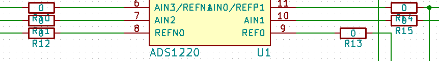

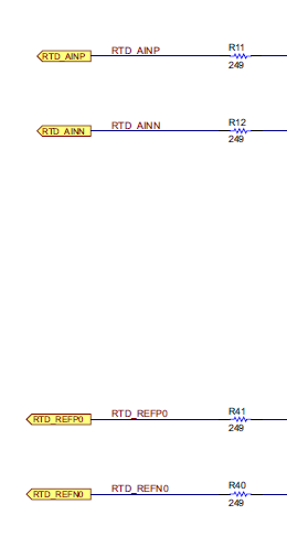

    There is a few more question , in the design tidu271, I find that the pins AIN3,AIN2,REFN0,REFP0,AIN0,AIN1 are connected with a 249 ohms resistance.
    But doing this will make the error become large , so I repalce them with the 0 ohm resistance. what's the fonction of these 249 ohms resistances , is that work after the replacing?

    I would suggest you try to follow the input current paths of the tidu271 design. This design is not a simplified design, but rather one that is designed to pass certain IEC tests. In particular look at Figure 52 on page 42 which shows an example of the protection circuit used. The 249 ohm resistors are for current limiting after all other circuit protection has been activated. D19 and D20 are for limiting electrical fast transients (EFT) from ESD or other similar events. D18 and D21 are for limiting any high or overvoltage conditions at the input terminals.
    The 249 ohm resistors are not used in the IDAC current path for supplying the excitation to the RTD. Instead diodes are used to limit reverse current back into the ADS1220.
