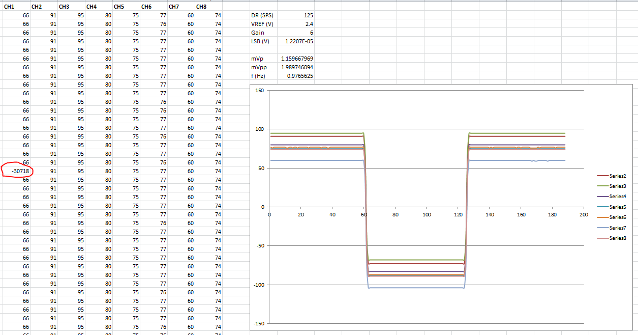

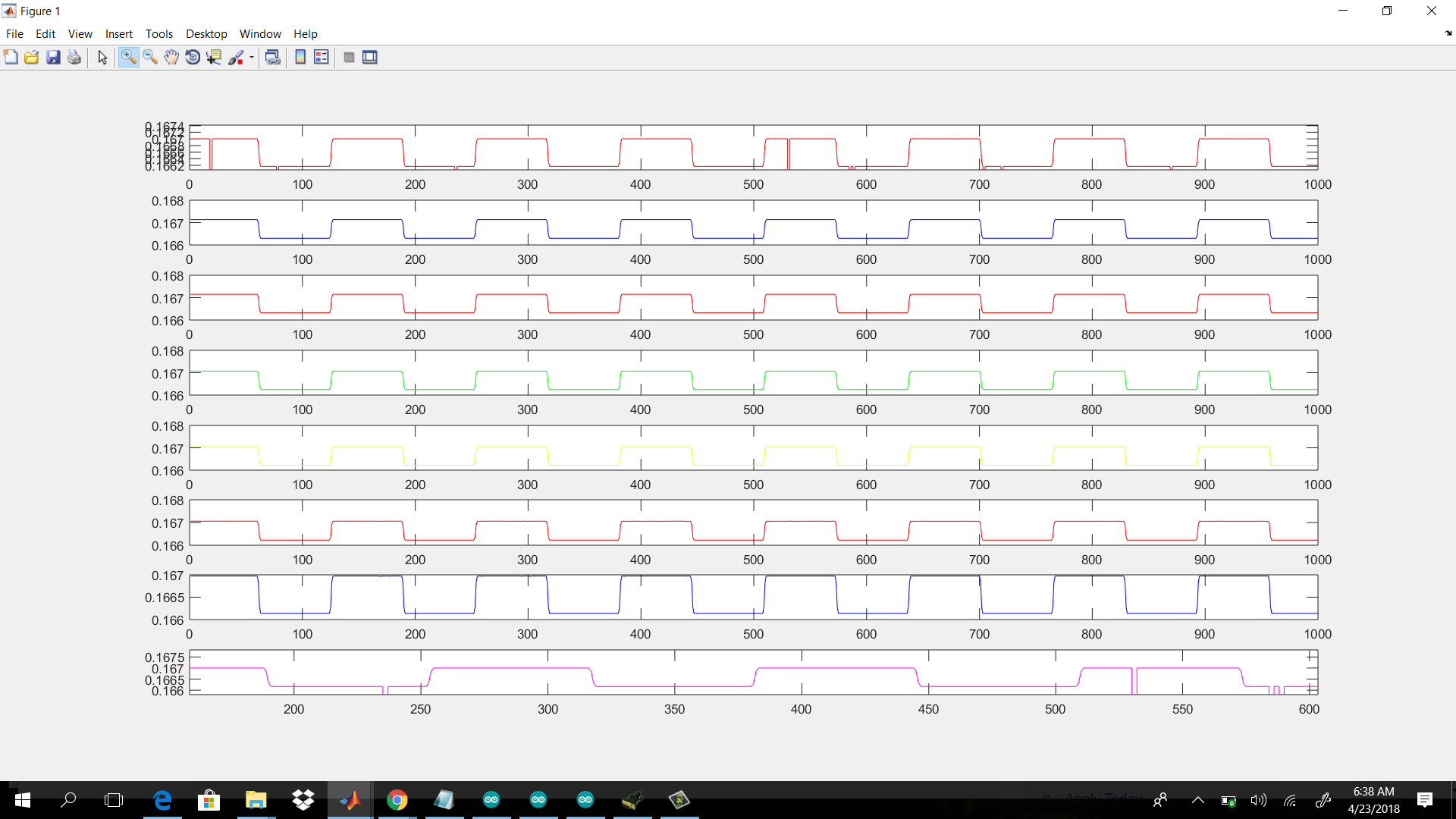

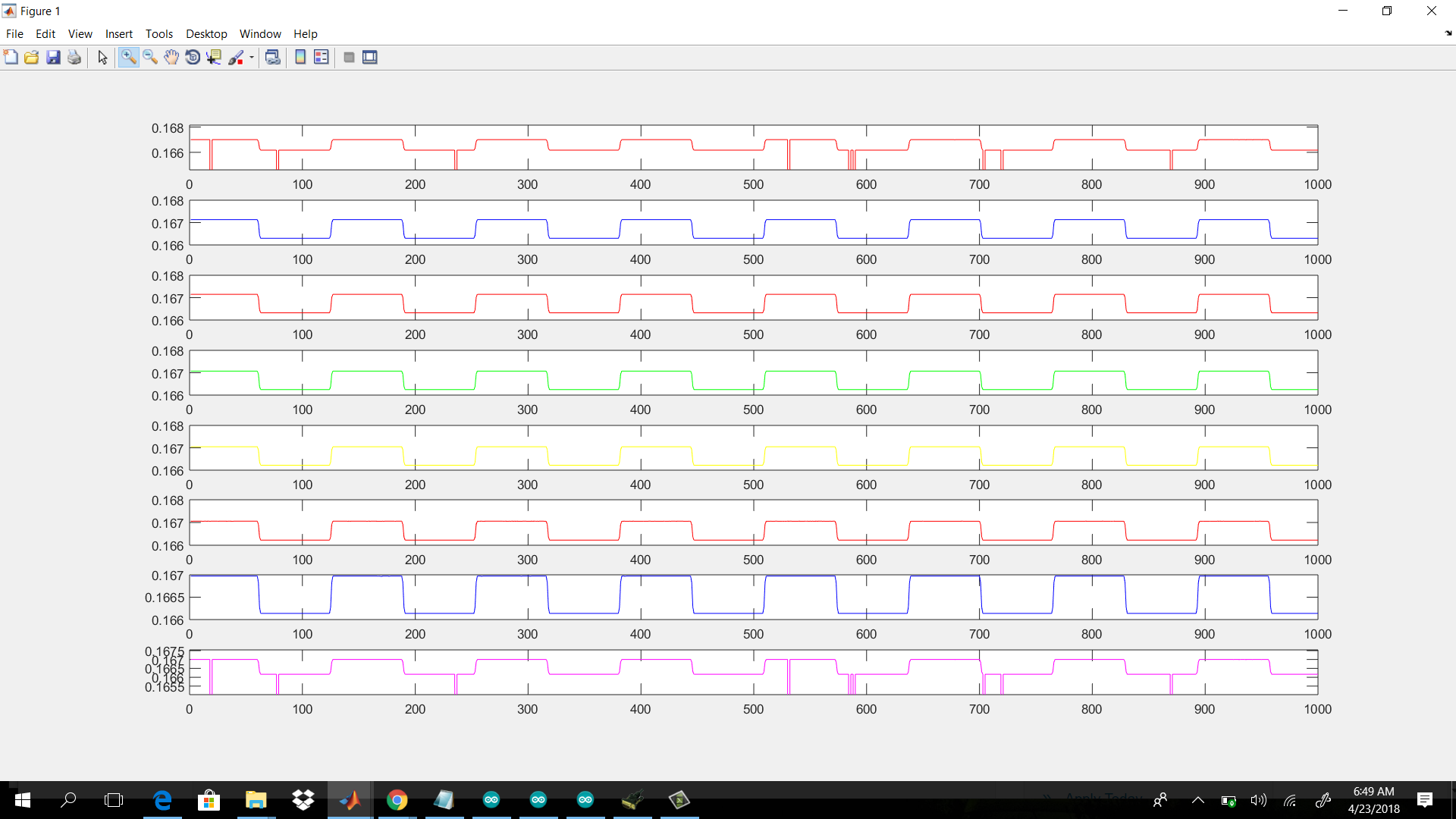

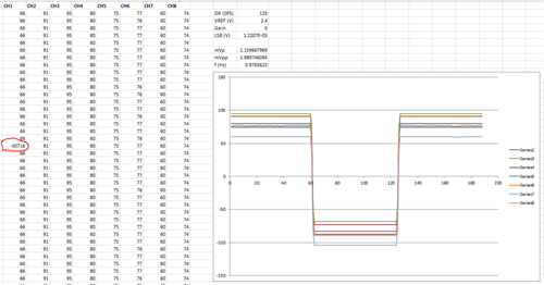

I got 8 channel test signal from ADS1198 in matlab and below is the pic of these.
Chan1 and Chan8 donot seems good Now please tell me the sol  ution.
  • Hello Ahmed,
    Welcome to the forum!
    Have you verified that this is not an issue with your input signal?
    Additional information such as schematic, input signal settings, how you're using the device would be helpful.

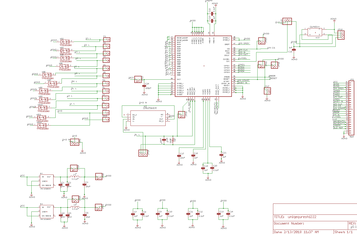

  • I am working on ECG related project using TI ADS1198 and arduino DUE,   i correctly read and write all the register and get ID. Now i want to get internally generated test signal, the signal that  i get seems correct except for  channel 1 and channel 8.
    I use uni-polar supplies AVDD =3v and AVSS=1.8v
    i read data in text file and then plot using Matlab
    here is my complete schematic diagram

  • And here is 8 channel data xor with 0x8000h, Now please check weather this data is correct or not and tell me how to locate problem

  • I have one more Question about Front end Filter, i studied in datasheet that there is a digital filter (sinc filter of order 3) is installed inside ADS1198.then in order to remove noise from ECG signal what kind of front end filter we have to install on front end, i work on 500sps.

    If possible, could you upload a PDF of your schematic? As currently stands, it is difficult to read the pin labels due to low resolution.
    Unfortunately I do not support the Arduino board and therefor cannot offer technical support.

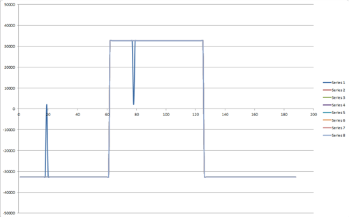

    From the waveform, whatever is happening on channel 1 & channel 8 seem to be identical. Have you tried physically switching which test signals are being input into these channels? For example, switch channel 1 & 2, switch channel 7 & 8 to verify that it is something wrong with the device inputs and not the test signal.

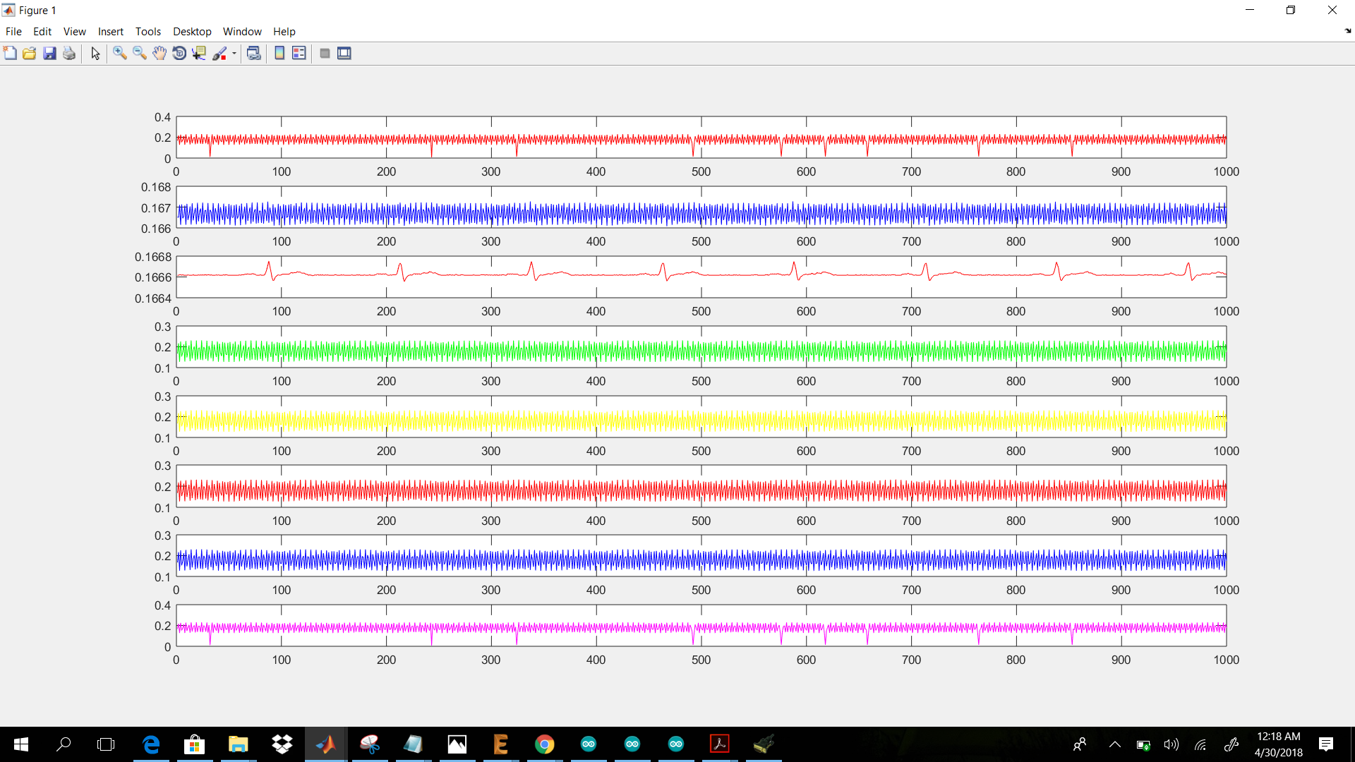

  • here are my ECG outputs of chan1 to chan8  seems to be good but there is problem with other. plz tell me what is possible solution for it.
    I provide input from ECG simulator skx-2000
  • From the waveform, whatever is happening on channel 1 & channel 8 seem to be identical. Have you tried physically switching which test signals are being input into these channels? For example, switch channel 1 & 2, switch channel 7 & 8 to verify that it is something wrong with the device inputs and not the test signal.
    how i switch chan1 and chan2
  • Hi Ahmed,
    I'll try to help while Alex is on vacation.
    I revisited your initial post and it looks like most of the data is correct. However, there are some occasional interruptions that are likely explained by some SPI timing issues. Please check the interface signals with a logic analyzer and verify that you are beginning and ending each transaction without overlapping the /DRDY interrupt.
    Can you please provide your output data rate, the reference voltage, and the gain setting for each channel?
    Also, I plotted the raw data that you shared. One channel 1 seems to have an intermittent issue, which, again, could be explained by a bad SPI transaction. Can you please list the hexadecimal register settings used to collect this data?
    In the future, please share code and data results in separate text files and attach them to your posts so the thread is easier to read.

     I have one another question about the electrode input, i connect ecg simulator skx2000c with inputs of ADS1198, and as simulator gives us filtered output so as i think so there is no need to add analog anti-aliasing filter at front end so i connect simulator output directly to the input of ADS1198 but the output seems very bad except channel 3.
    As i posted earlier test signal for channel 2-7(except chan1 and chan8) seems good then what is the problem with electrode input, i change setting in config 3 mux setting  to 000(Normal electrode input)  but i donot set RLD and WCT because as i think WCT and RLD is not require for simulator filtered output as RLD remove common mode noise and WCT is reference for chest leads which simulator already generate.
    now please tell me if i am wrong then what are the setting for RLD (8 channel) and WCT and any other register for Electrode input.
    below is attachment of 8 Channel electrode output
    thanks
  • Hello Ahmed,
    Thanks for the registers settings. A couple comments about that:
    1. Your CONFIG1 setting is for 125 SPS, not 500 SPS. The data I plotted from you also looks like it was collected at 125 SPS (assuming a 1-Hz test signal).
    2. Please pay attention to the "Reserved" bits. CONFIG1[7] must be 0, CONFIG2[5] must be 1.
    Were you able to check your SPI transactions with a logic analyzer and verify the timing?
    I've replotted your data after reversing the XOR function you had applied. The signal amplitude looks correct. The spikes you observed on CH1 are likely the cause of either misreading the data or data corrupt due to the overlap of data transfer with a new /DRDY interrupt.
    Please begin a new thread to discuss your other question regarding your electrode input configuration.
