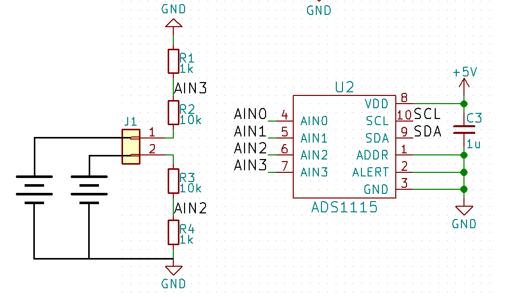

As seen in the Schematic, I'm using a 1k/10k Voltage Divider to increase the Input Range of the ADS1115.
This setup works accurately at up to 5V on J1.
Above 5V, the Device consistently reports Voltages below the actual Value.
This effect increases with Voltage, at 6V the Error is about 0.2V, at 10V the Error is already 1V.
Can somebody tell me why this happens and how to fix it?

  • I'm measuring from AIN2 to AIN3 using the following Library.
    https://github.com/adafruit/Adafruit_ADS1X15
    For testing Purposes I'm using a Bench Power Supply with a 100Ohm Load between VCC and GND.
    The Voltage is measured in parralel by a Multimeter and the ADS1115, which are connected to either end of the Load.
    AIN0 and AIN1 are floating
    All that is connected to AIN2 and 3 is shown in the Image, there are other components on the digital Side though.
    (Namely an MCU and a 7 Segment Display)
    I will take the Measurements and post them later.

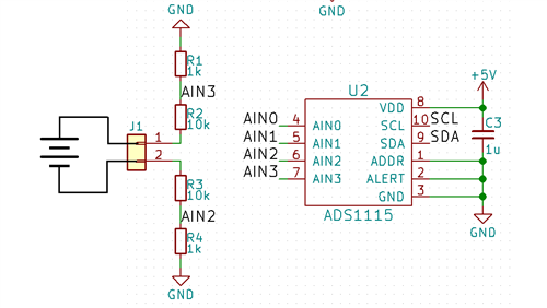

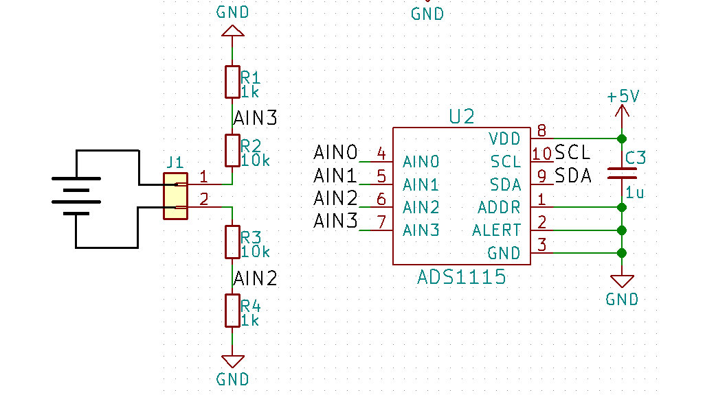

  • Felix,
    Do you have something like this:
    1.
    or something like this:
    2.
    In the first schematic, nothing defines the common mode input voltage. In this way, the value at AIN2 and AIN3 would depend on where the common mode input settles. In the second schematic, the supply measurement would give a reliable reading. The input voltage is the difference between the two divided by 11, and the common mode input is clearly defined. If you only have one supply, you could still make a measurement similar to the second circuit by tying one input to ground.
    In the first schematic, without the reference to a common ground, the measurement may not give a reading you expect.
    Joseph Wu
  • It works when I connect the two Grounds.
    I thought that differential measurement would not need a common Ground since the only the Difference is measured.
    But I guess since I'm using a Voltage Divider with reference to Ground, a Shift in Ground Potential skews the measurement.
    Knowing what I know now, a Setup like this would make more Sense:
    Can you confirm this?
    AIN3 should still be protected from Overvoltage because R3 Limits the Current so that the internal ESD Diodes are not overwhelmed.
  • Felix,
    I believe that's correct. With this new input setup, the input source and ADC now have a common ground. This would force the source into the input range of the ADC. Adding the series resistance to AIN3 shouldn't hurt the measurement.
