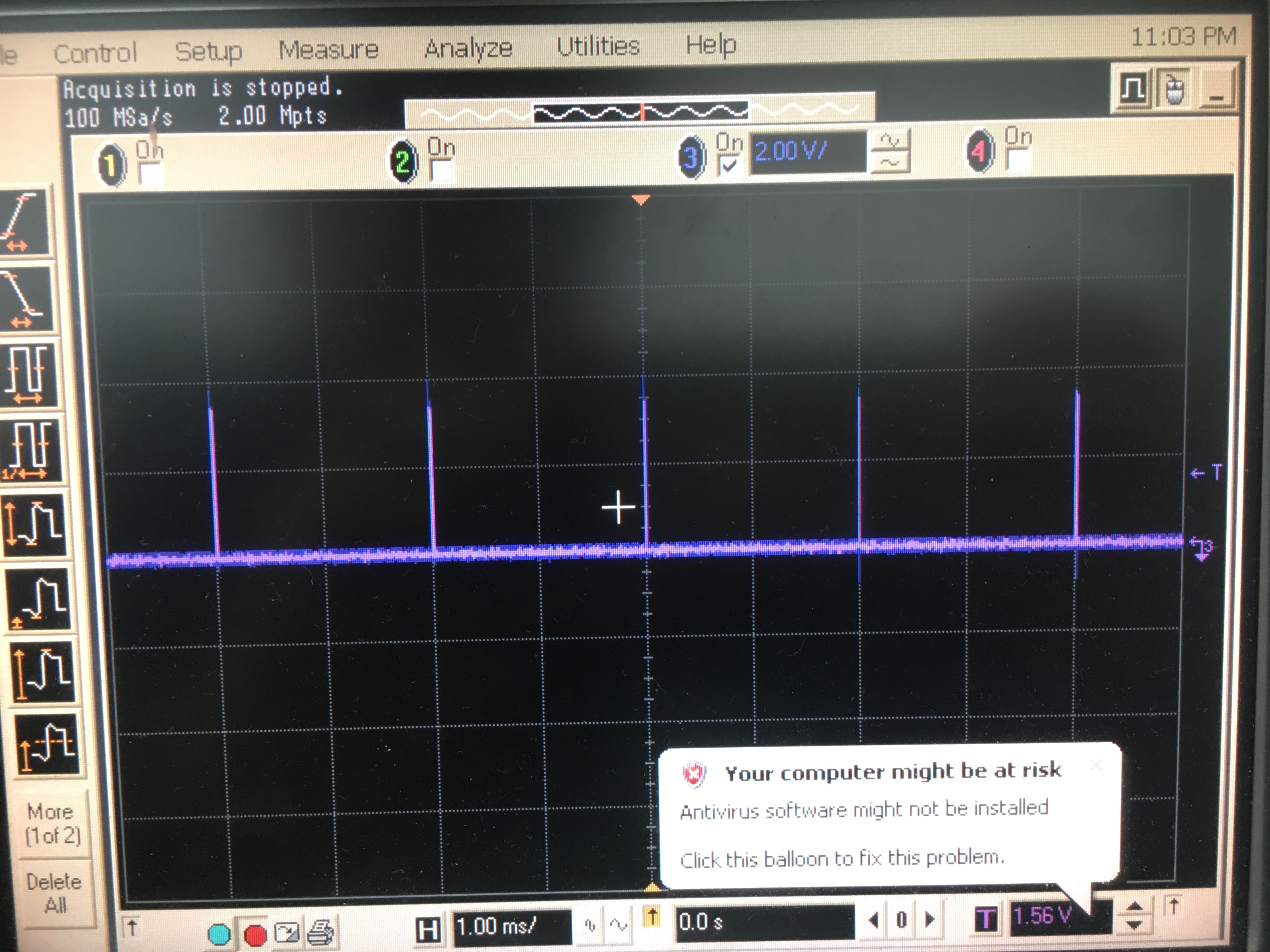

I have a ADS1292 EVM Board. But Software is not working..
I try following the steps in this post:
e2e.ti.com/.../665556
( test on Window7)
0. Board LED Status
  - Power : USB mini 5V
  - LED : Green LED Blinking
1. Check USB driver
  - Installed USB Driver
2. Try running software administrator
 - Still not working
3. Board power check
VREFP : 2.419 V, VCAP1 : 1.19V
4. /DRDY pin check
I try to ohter pc(Window7), But same problem occurred.
Thanks for helping.
