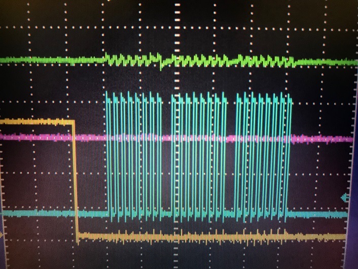

I'm trying to use an ADS7952 in Auto-1 mode with a Raspberry Pi Zero. I want to write the code in python but there isn't a lot of references out there for guidance. The first few iterations I've tried have not been successful in communicating with the ADS. Can someone review my files and tell me if I'm on the right track? I'm trying to use all 12 channels of the ADS and utilize the SPI bus.

  • I've connected the Raspberry Pi to an o'scope. Here is what I captured when running the code.

    If you could share a schematic and the code snippet where you initialize the device for Auto-1 mode of operation, I should be to help you.
    The standard frame size for the ADS7952 is 16 bits. The screenshot you shared shows 24-bits in the frame (assuming that the yellow line is CS). This would still work, but is not optimal if you are aiming for high throughputs.
    Look forward to hearing back from you.
    Sandeep
