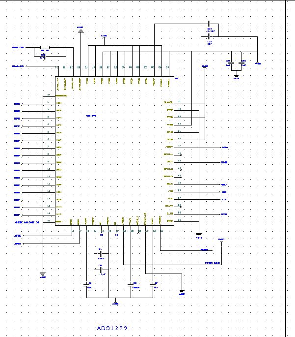

  • Hi Ryan,
    as you mention the openBCI projects I was asked to design a PCB based on the following schematics from openBCI
    The data sheet says to leave pin 64 (reserved) open and unconnected, while in the openBCI project this pin is connected to GND.
    This schematics is done in Designsspark and as you can see as well that the nc pins 27 and 29 are connected to an nc net while nc is nc. I have my doubt that any PCB is ever done using this Designspark project. Possible this PCB has been done in Eagle and just moved to DS. There are as well other issues which proof that this schematics would not work.
    So should pin 64 / reserved be left open like in the data sheet mentioned or connected to GND as in the openBCI project ?
    thanks and
    best wishes
    Ralph
  • Hi Ralph,
    Please leave pin 64 open as recommended in the device datasheet.
