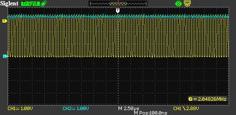

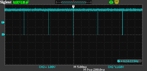

Here you see the DRDY pin being toggled at 62 SPS instead of the 250 that it should be toggling at. I've been streaming and see the data rate go back up to the 250, but this down ot 62 (which is 250/4) is an intermittent problem.
I figured that I should check the ADS1299 output pin and say that it's clock it accurate at the 2.049 MHz.

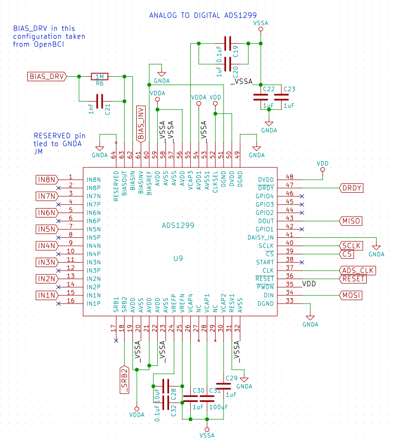

I'll attach my schematic too
It's copied from the OpenBCI.

    Can you please read back all of the register settings? If you could list them in a hexadecimal format, I can do a quick review to see if anything is not set correctly. 250 SPS should be the minimum data rate in this device with a 2.048 MHz clock. Thanks for verify that the internal oscillator is working properly!
    Are you communicating with the device at all when you probe the /DRDY pin? Please note that the falling edge of SCLK will clear /DRDY. This may change the time between /DRDY rising edges (depending on when SCLK begins to toggle), but the period between /DRDY falling edges should always match the configured output data rate.
    Yes whether i am communicating or not has no effect.
    Okay!
  • If i run at 1000Hz, then the sample rate goes up to 255Hz but is rather unstable and fluctuates all the way down to 220Hz.

  • Hi Andrew,
    Are you issuing an extra /RESET pulse after power-up? After both analog and digital supplies are established, we generally recommended that you wait for some time (tPOR) and then issue an additional /RESET pulse (or RESET command) to ensure the internal one-time programmable registers from the factory are read correctly. I say this because some of the bits you read back after start up should never be set the way they are (typically listed as Reserved in the register map). Once the reset is done, you should be able to write your own register values and they should never change on their own.
    Also, are you remembering to exit Read Data Continuous Mode by sending the SDATAC command before any other SPI commands?
    I know that you checked on the internal clock before, but please configure the CLK pin to output the internal oscillator and just keep an eye on it periodically with a scope to ensure it is not changing momentarily.
